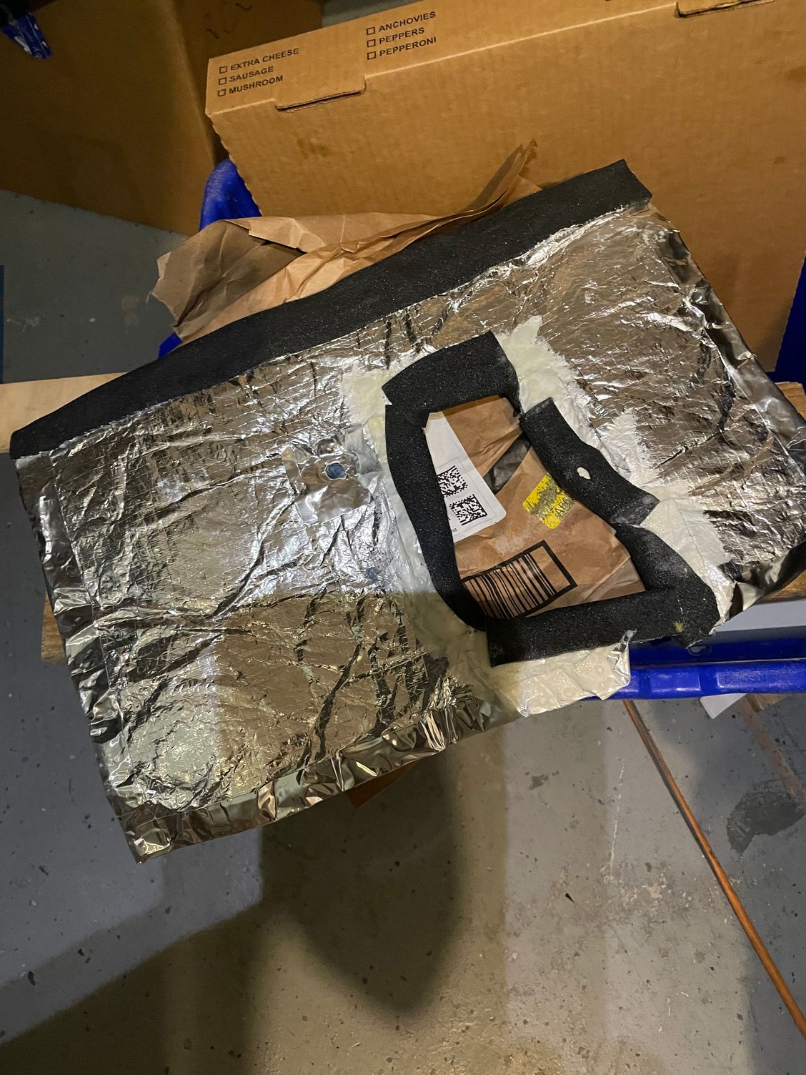

I bought 3 MOST Loop Connectors, however they only fit onto the MOST Wire Ends for the CD Player and GPS/NAV Unit, NOT for the OEM Radio MOST Connector that has an additional 4 Pins! I have my whole interior removed (Seats, Dashboard, Steering wheel, etc.) after having treated every exposed piece of sheet metal with Second Skins “Dynomat” product as well as their CCF/Vinyl “Damplifier Pro” with their “Heatwave Pro” on top of that! Now that’s done and I just reinstalled the Evap/A/C-Heating Unit after wrapping it with “Heatwave Pro”, and I can tell you that in order to get the Heater/A/C Tubes seal to the firewall to line up properly you get bolts into the Center Dashboard Frame 1st (located just right and left of the Gear Shift) so as to lift the Seal High enough to seat correctly, rather than starting with the sides. ASK ME HOW I know?!?!?! I must have removed that thing 3 or 4 times, but I also had to go back in and trim exess Heatwave Pro that I had Overlapped both on the firewall and that I had wrapped on the front side the AC Unit itself as I made two sides with cutouts for the Air Ducts with a layer for CCF around such Ducts as well as where Aluminum Tape would otherwise touch! That Dashboard frame is what the AC Unit attaches to with 2 10mm Nut from the bolts protruding from its front. I have the wrap laying over those and punched a hole through it (as well as aluminum tape on both sides as well as every single edge throughout the car!) and both sides were overlapped in the front, so it was very tight fit. Too tight, in fact, as the Frame tucks up close under the front edge of the Middle Vents and I wasn’t able to get those bolts to go through the frame! So after a few cuts followed by more Tape, I was able to get the seams of each side of the Jackets (right and left) to line up on the front side without a bulge finally mounted correctly!

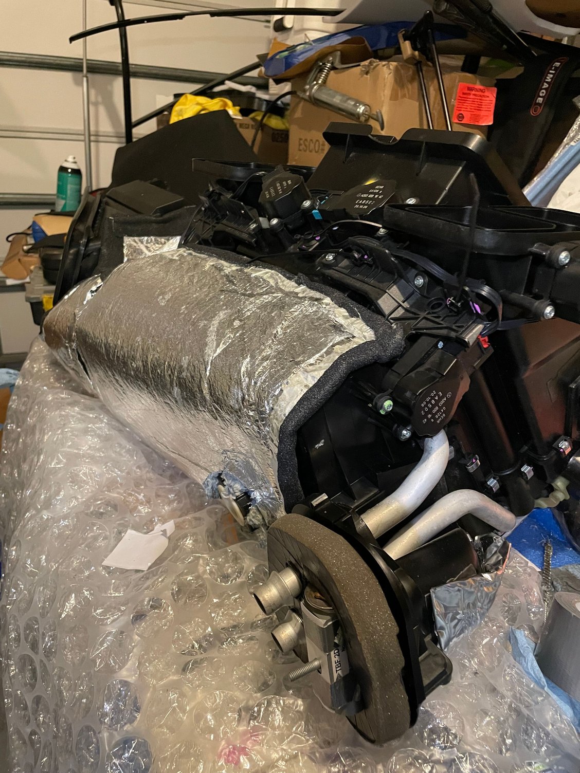

Backside of AC Unit wrapped with Heatwave Pro! That Rubber Seal on the left was new, but the OEM Tape had lost its grip, and I couldn’t exactly remove it from the seal, so I first tried Monster Double sided Tape, but that was a bust! It didn’t stick to the Plastic! So I applied some of the 3M Super 90 Spray Glue I used for all CCF edges of the Wrap and the Melamine Foam layers in each door panel and that did the job! You just have to apply it to something like wax paper first and then spread.

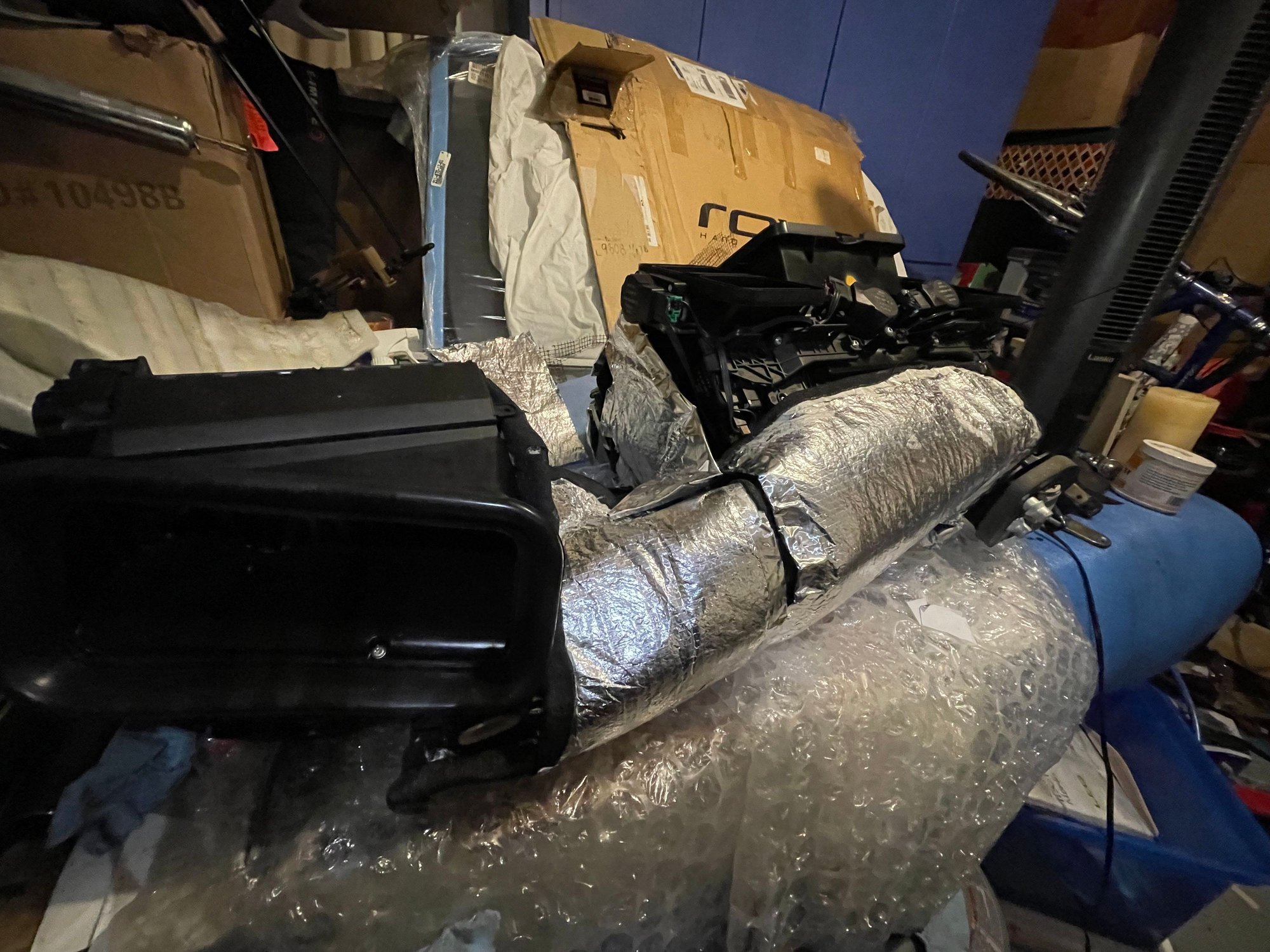

This is one of the Heatwave Pro “Jackets” I made to wrap around the AC Unit.
Driver Side view of the Back Side of A/C Unit. That is the Seal surrounding the Tubes which go thru the firewall which I had a problem getting to seat correctly against the firewall.

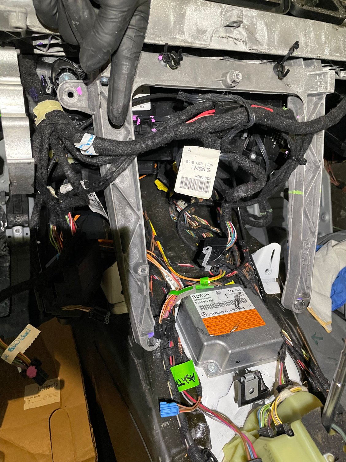

This is the Center Section of the Dashboard Frame and it is those lower 2 bolts that one must get attached first before attaching the sides in order to get the A/C Unit high enough! Making sure the A/c unit is mounted to the frame by those 2 10mm Nuts first is key (at least it is considering all the Heatwave Pro I have making it such a tight fit) rather than just getting it in position up against the firewall and then trying to push it into place by tightening up bolts right and left side, not feasible! That hole with the purple dot to the left of my finger is where one of the 2 protruding Frame Mount 10mm Bolts extend from the AC Unit (as can be seen in the pic just behind the frame). Moreover, you can see the Radio Connector (Non-Standard) with its (4 pin-wires) and 2 Fiber Optic Wires at the base of the Frame. It doesn’t have a locking tabs on the side like the CD & Nav Most Connectors have. Its locking tab is on its Top (long) end?
The reason for this post, however was to try to get the part number for the MOST Loop Connector for the OEM Radio Player. I had not realized that I could not remove the Headliner without first opening up the Sunroof, as evidently there is a clip fastening the front section in place I was unaware of! I have 3/4 of the Windshield Cut Out But without the loop connector I can’t get into STAR/Xentry. I know I can just reattach the Radio, however, I still want to be able to keep the LOOP Open once I’m done so as to possibly maintain power to the GPS/Radio Antenna (I know if it doesn’t receive a signal to turn on that I may have to splice into a Switch Power 8Amp? to the Driver side rear C-Pillar power unit) as well as anything else I might not think of? And until I clear each of those systems in Star/Xentry without the LOOP Connector, I cannot Power up Xentry as thier appears to be a Fault during the connection process which I am attributing to the MOST Loop being broken, as well as all the other connectors is the dash! So, for now I’ll just reattach the OEM Radio to hopefully be able to get into Star/Xentry and then be able to open the Sunroof from there?
