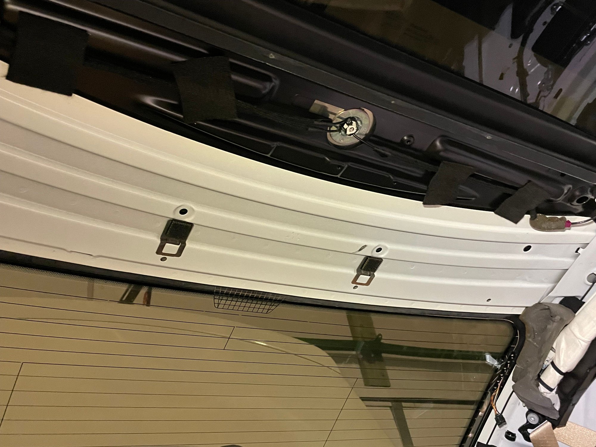

Now when I try to "slide the headliner back" , it doesn't budge. It feels like the rear part behind the 2nd glass panel is still attached - I can see there are these clips as below, but they just dont move.
Am I missing something?

Hi guys, alright I figured it out - basically just two small pieces of velcro are attached at the far back part of the headliner either side of the reverse sensor light unit. This was different to the instructions, but my car is a late 2007 so perhaps they updated the design.
I've now completed the fix and happy to report absolutely NO noises from the panoramic roof now, good as new.
For future reference below...
Penultimate step of removing headliner is pulling down on the lining at the very back so these two velcro pieces detach. I used fingers to feel around for them. A quick 'tug' at the correct location is better than gently-gently.

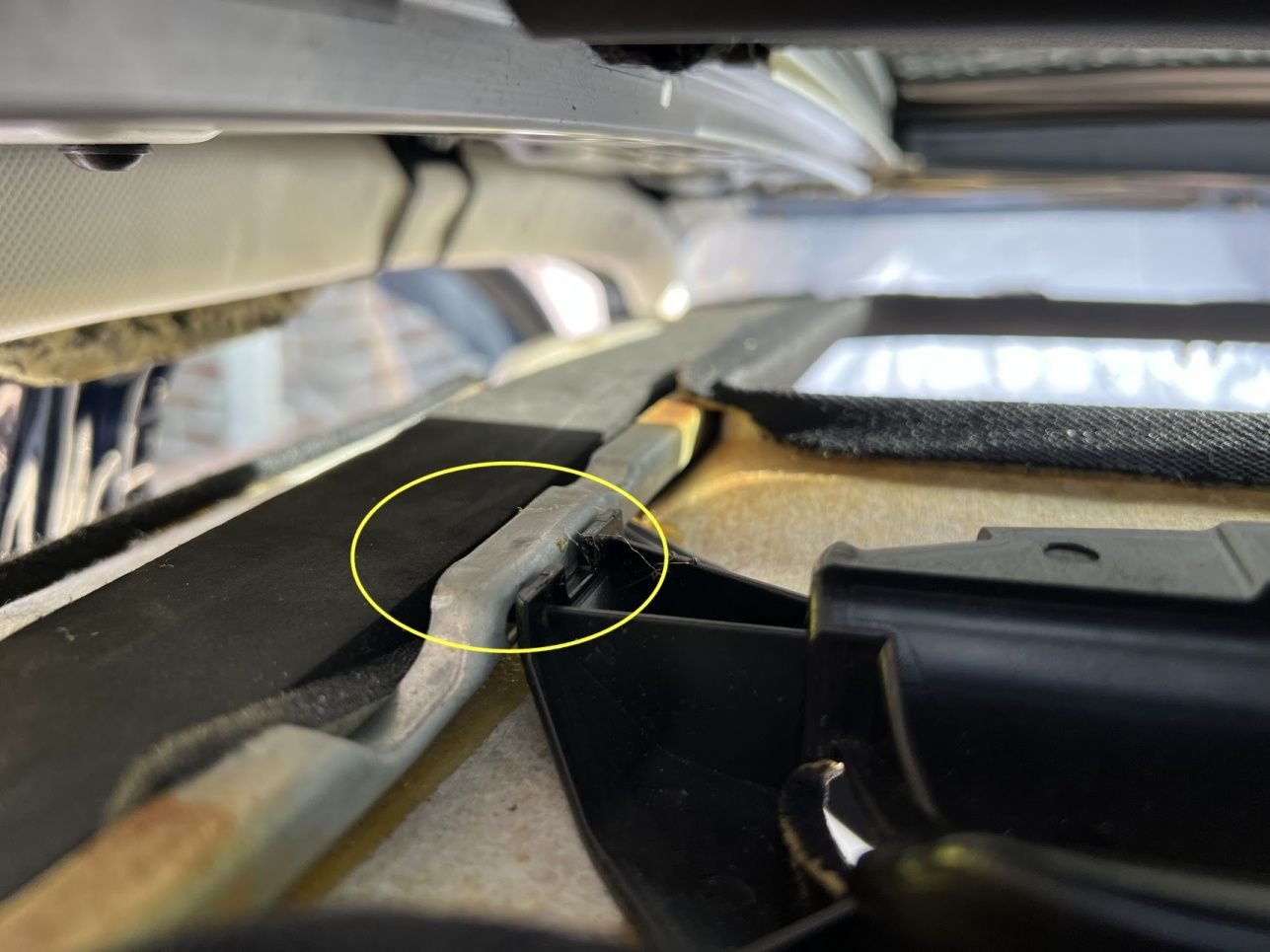

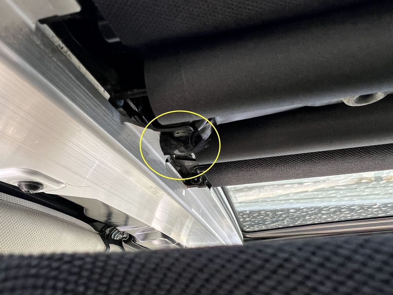

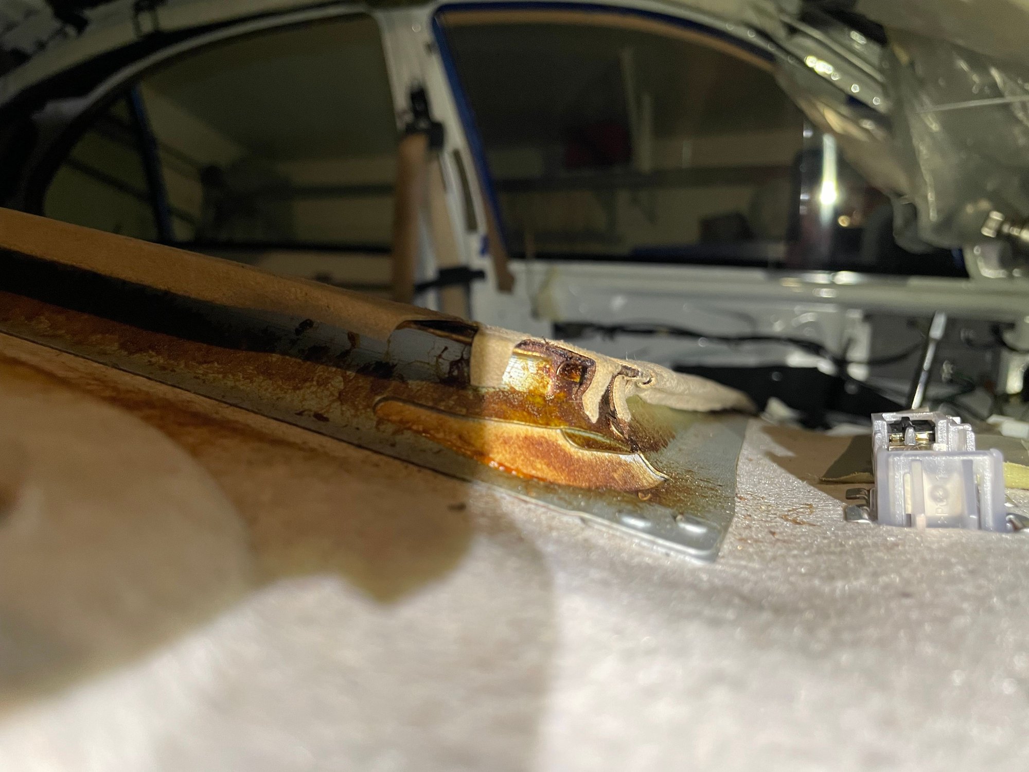

Culprit #1, the bolts along each side of the panoramic roof rails become loose over time. This picture shows the main two which were loose on mine, however best to go around the whole lot and tighten as much as you can. I've seen some people use locktite, I opted not to, we shall see if just tightening them lasts.
In addition to tightening all the bolts, I used a length of foam along the length of the metal channel in case of any contact rattles here.
Culprit #2, there is this small felt covered part which sits against the headlining. This is no doubt the cause of the loud 'clunks' over bumps, as the felt has worn down and now it's metal on metal.
Culprit #2 on the headliner side - here you can see visible marks where the top part had been hitting. I used some sticky-backed foam on this part to suppress the noise.

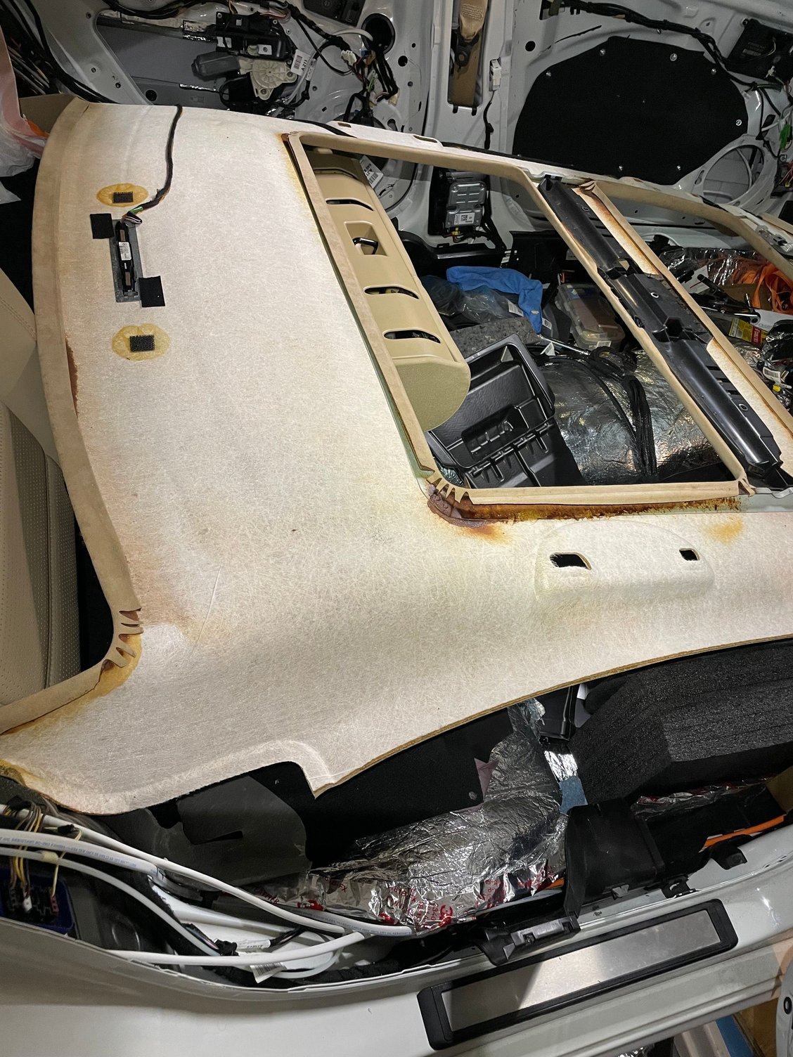

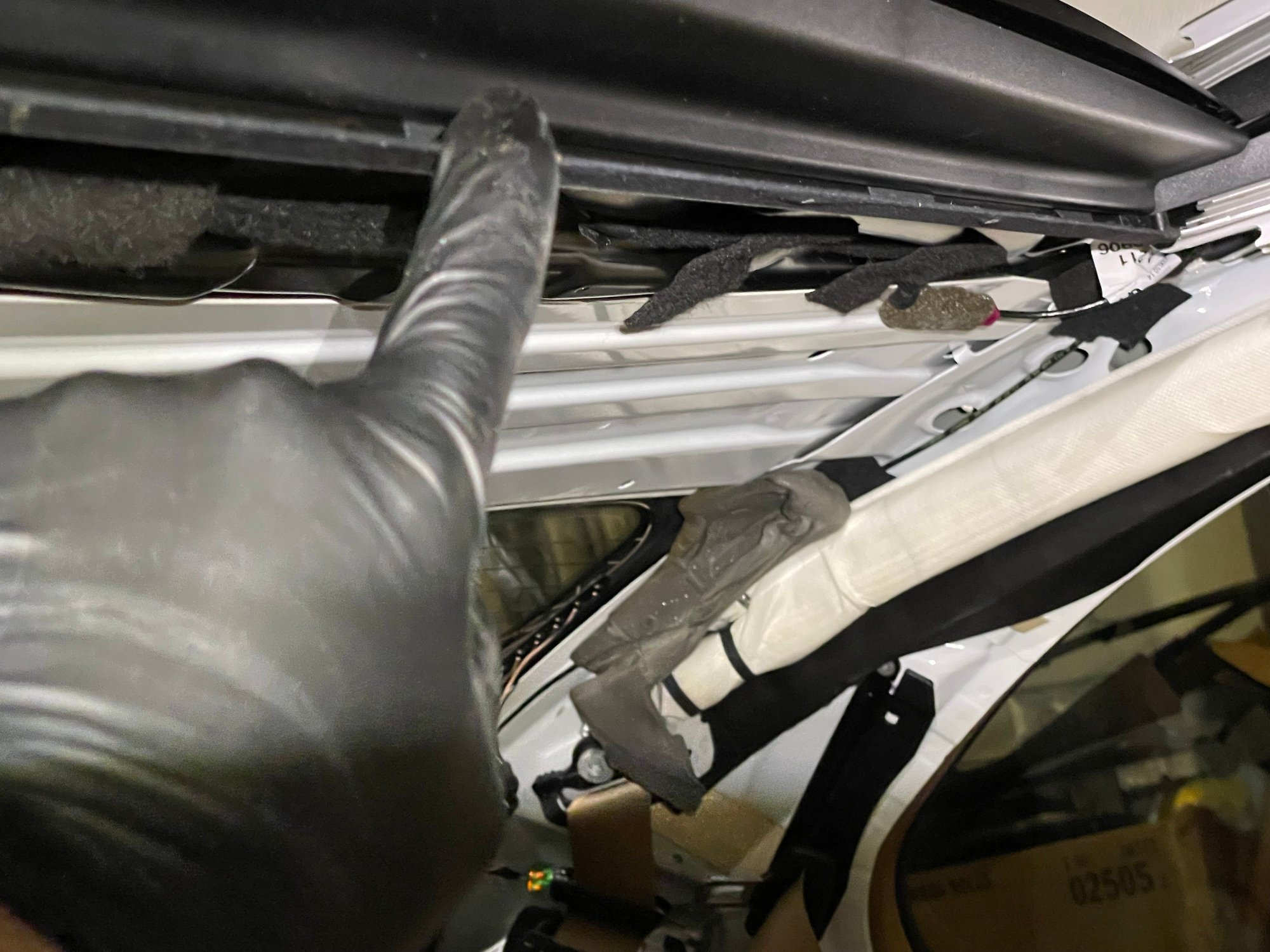

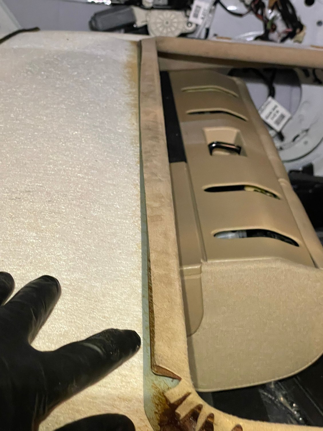

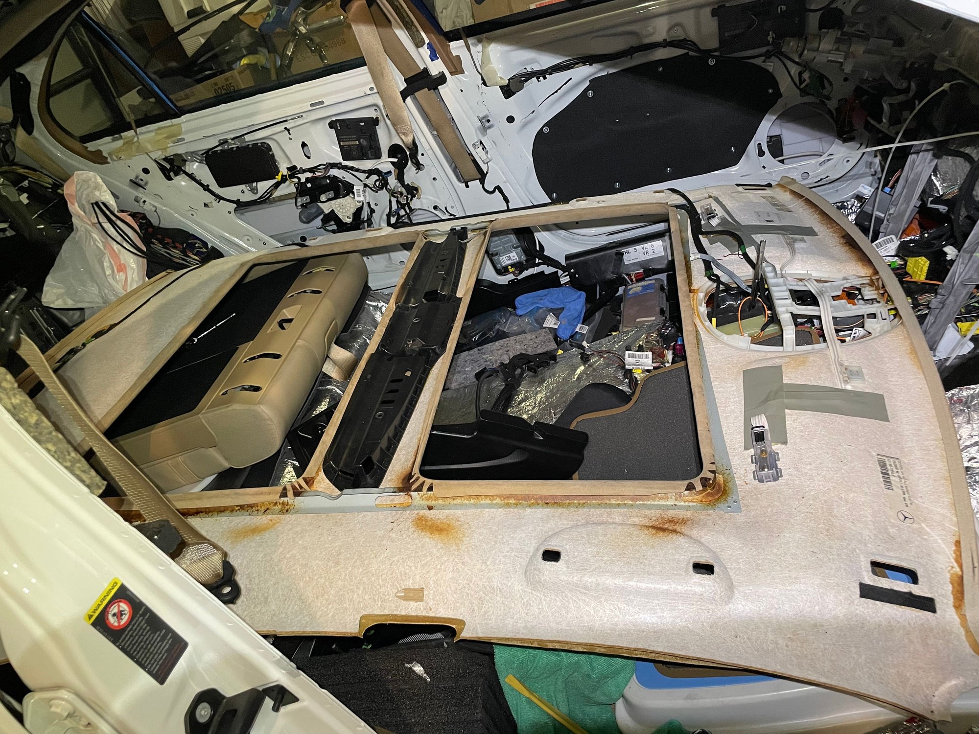

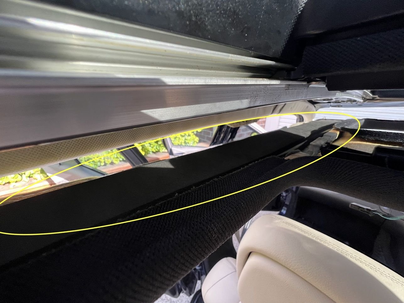

Ok, I finally was able to drop the Panoramic Headliner in my 2007 W211 E63 by using a Screwdriver and prying that front Sun View Lip by first opening the Sunroof manually with a Hex Bit to wind the Motor. Then from above I started at the passenger Side front Corner and got that front edge out then used one of many plastic wedges I have to keep the edge from popping back into place. I did this to the midpoint and then while holding the middle wedge, I then reached across to the far corner, put the flathead there and gave it a twist and voila! The front edge dropped! By prying that edge back, it essentially moves that whole HL back now more prominently positioned on its rear edge (see my pic of that edge below). So be aware that the Headliner is completely suspended by its rear edge and, once you pull forward to dislodge it off of its rear most edge, it will drop, so be prepared for this!
This is a shot of the HL Rear Sun View Edge I took with my boroscope/ipad combo. When you pry away the front, this pic shows how much it can actually slide back, as this shot was taken while the front edge was untouched as I mulled over how exactly to get the HL removed!
After prying the front edge and then pulling it forward, the whole HL dropped just so!
This is a shot of the front sun roof edge that upon installation again, would be the 2cnd to last to be attached, with the rear edge being 1st.
This is the way more prominent Rear Edge of the HL which would be attached first upon installation. Notice my finger here and in the next pic where this edge actually attaches to!
This is the part of the PanoRoof which that rear edge suspends from.
These are the 2 Velcro Tabs which must be unattached 1st and subsequently reattached last.

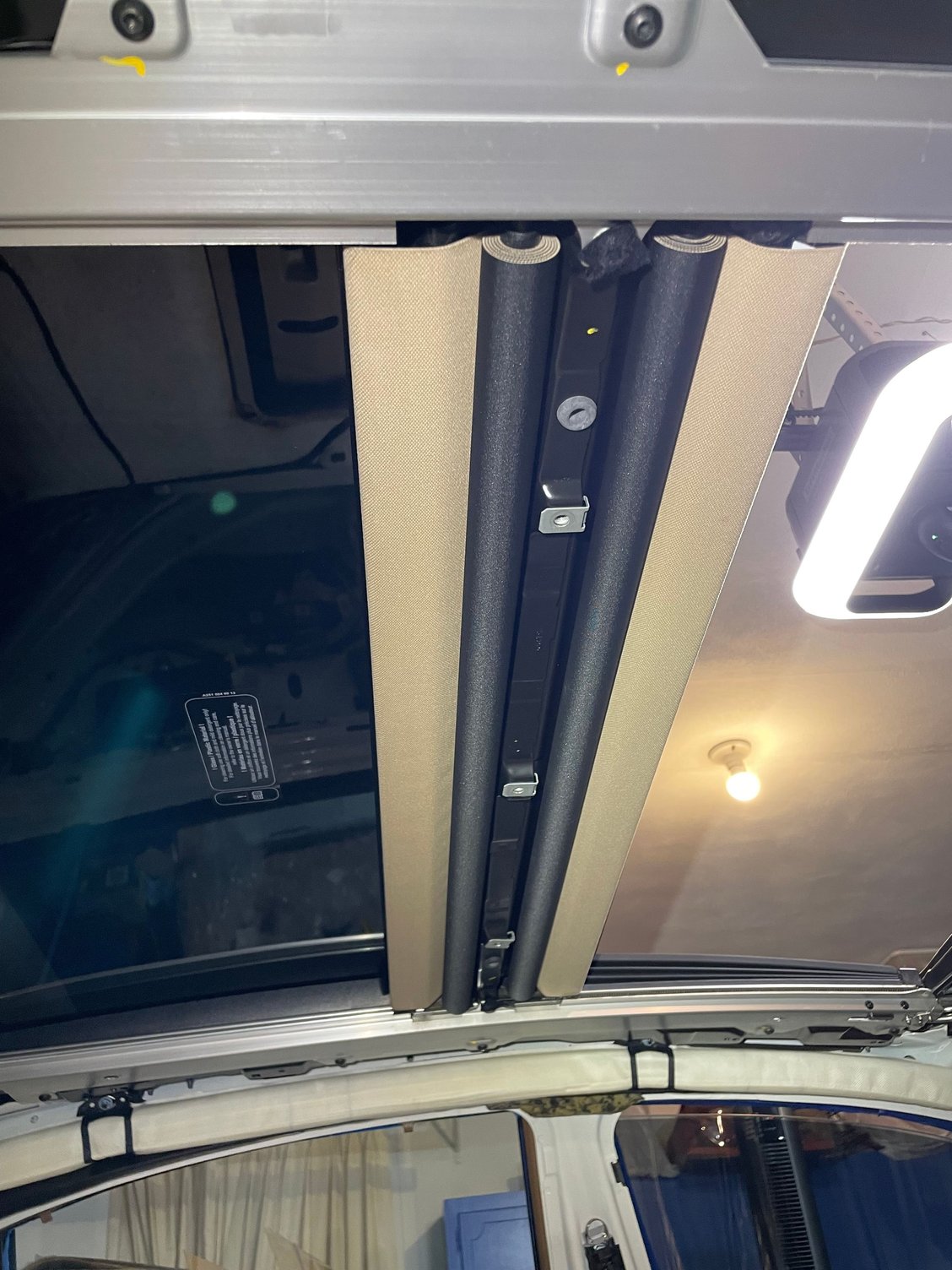

This is a close up of the Roller Blinds.

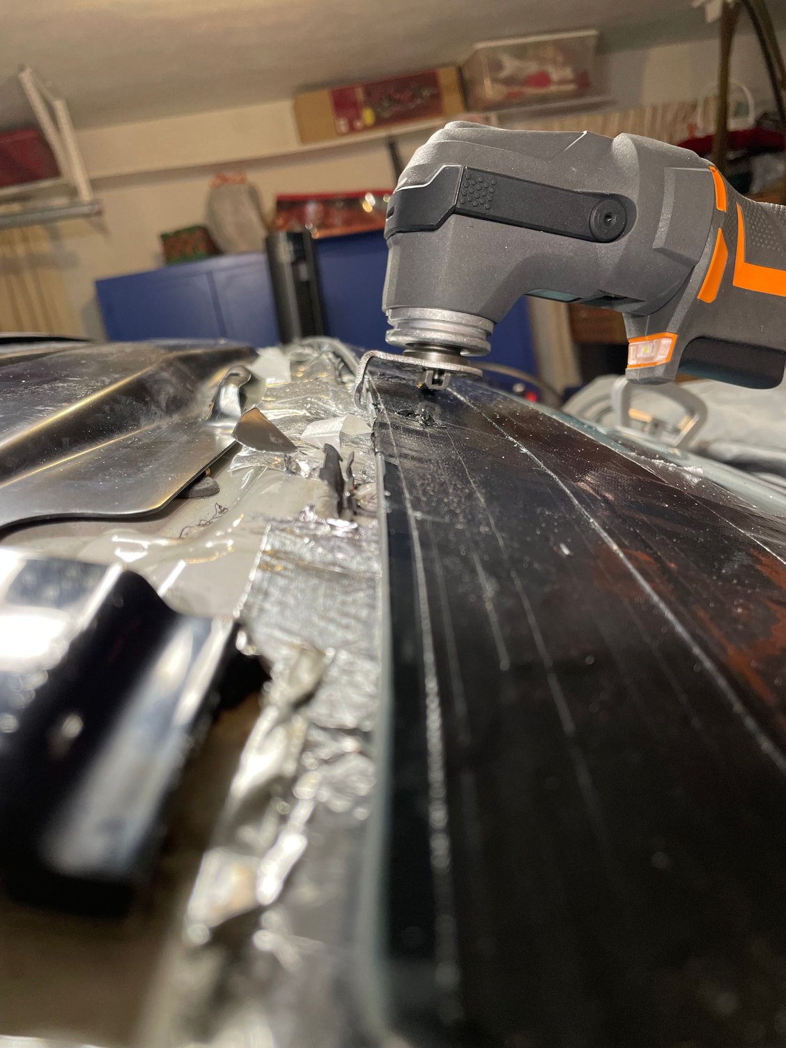

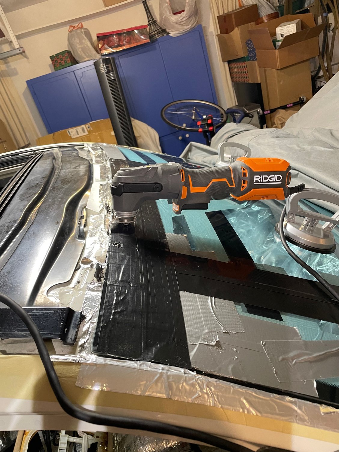

This is the Reciprocal Cutting Tool I used whilst cutting out the Windshield. I masked off all surrounding sides with 2 layers of Masking tape and the 2 layers of Aluminum Tape to Guard against any damage that may result from the bit getting away from me!
Close up of the bit used as well my use of Aluminum Tape along the edges! When you cut, I would suggest making sure to cut as close to the glass as you can as the alternative is to destroy paint! Ask me how I know! Also, my 1st attempt was with the “battery” version of this tool. I got 3/4 they way around using that, but the Batteries didn’t have power to get through the top section so I bought the less expensive 4Amp Corded version to finish. TIP=use the fastest/highest speed when cutting! If you think you need to slow down, think again because when go lower power whilst still applying force to cut, the vibration of the slower speed will cause the Cutting Bit to Break! I broke 2 of 2 that I had of this “hook” type, which definitely was the best Bit. For Corner areas where the tool will be to thick to fit between/around the front quarter panels etc., then you must break out the Cutting Wire. In fact, when using that “hook” bit, there were areas where I had removed the tool and then Reinserted it not exactly where I left off. This resulted in areas of the Sealant that were left stuck to the glass side as well as well as the car side. So this Cutting Wire was useful in those areas too. In fact, I ended up going all the way around with this wire just to make sure all was actually disconnected!
