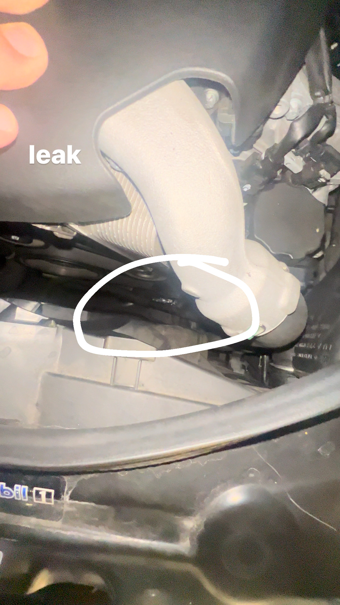

2007 e550 pursuance help
hello i’m also interested into getting an e550 as a daily but here are the issues. The car has a rough idle and start. The engine cover also vibrates and moves making this weird sound. There’s a leak from the front right of the engine bay, leaks at the bottom and by a pump. I just want to know if it falls between balance shift issue i believe it goes till engine number 88xxx which this one exceeded but 2 opinions is better than one. they are asking 6000 but the car faxs says it’s worth about 4500 somone please help. i have video of idle and start as well but it cranks for a while before starts.
VIN WDBUF72X87B075156
Attached Thumbnails Is this E550 in the buy zone?-972bff9d-66dc-4a3b-909b-432b79f99897.jpeg
It's worth whatever someone is willing to pay. You can check nadaguide, kbb, edmunds, black book etc., they'll all probably have slightly different numbers. It's out of the timing chain range. Rough idle could be anything, intake manifold, spark plugs, some of the various sensors like camshaft/crankshaft, fuel injectors, motor mounts, etc. Maybe spend about $55 on an Autel AP200 and scan for any mb specific codes. Sometimes if the intake manifold is about to go, you'll get pending codes about the intake runners which won't trigger a CEL. As for the leak, can't really see anything. Common spots would be the oil cooler gasket by the oil filter.
