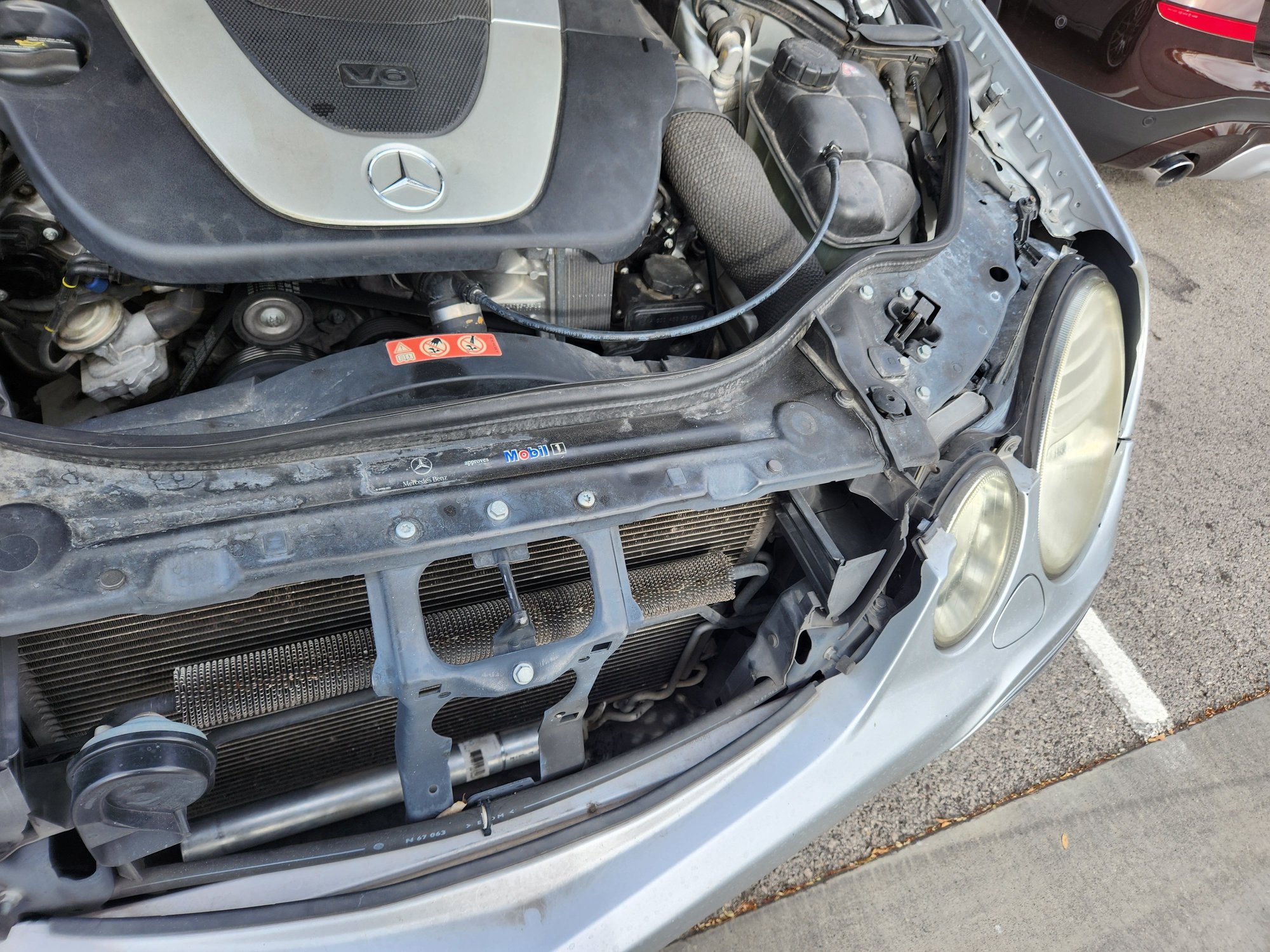

So I have this new to me Mercedes 2007 E-350 and I'm wondering what's the best way to go about fixing the ESP error seen in the picture. I posted pictures of possible frame damage due to an accident before I had bought the car just to show that, as I'm told it's maybe something up near the tire or the front end of the vehicle that's causing this light to go on. However the wheel (front drivers) is not bent at all and the suspension is perfectly fine the car drives great... it's really just I guess some frame damage that's causing the headlights and the bumper to Sag on the right side. I was also told it could be the steering wheel tilt sensor and when I have the car in park after just turning it on to turn the wheel all the way to the right all the way to the left and keep going back and forth for a few minutes and that should reset that. I did the whole steering wheel thing a couple times and it did not help. So I'm confused if it could be both accident damage and steering wheel or just one of those causing my ESP issues, or if I'm just reading everything wrong for my specific vehicle. Also it's a good thing to note that I don't get that error message and the yellow check engine triangle turn on until about maybe a half a mile out driving, meaning it doesn't turn on when I first start up the car or first start driving I have to drive a couple blocks and then that error comes on along with the light. The orher light that says check engine is always on and I'll post that in another post as I think that has to do with timing belt or something if I looked up the error codes right but I will post that in another post I want this just to be about the ESP and how to fix that please and is it something I could try and accomplish myself (being a little decent with stuff like oil changes and tire changes aka can wrench a little myself) or is it something that I would want to see a qualified professional or dealership for?

Keep in mind I was told it could be a level sensor too see pics - the car was in an accident before I bought it and the front drivers side lights and such are lower due to sdaid accident - could this be an issue causing esp error too?

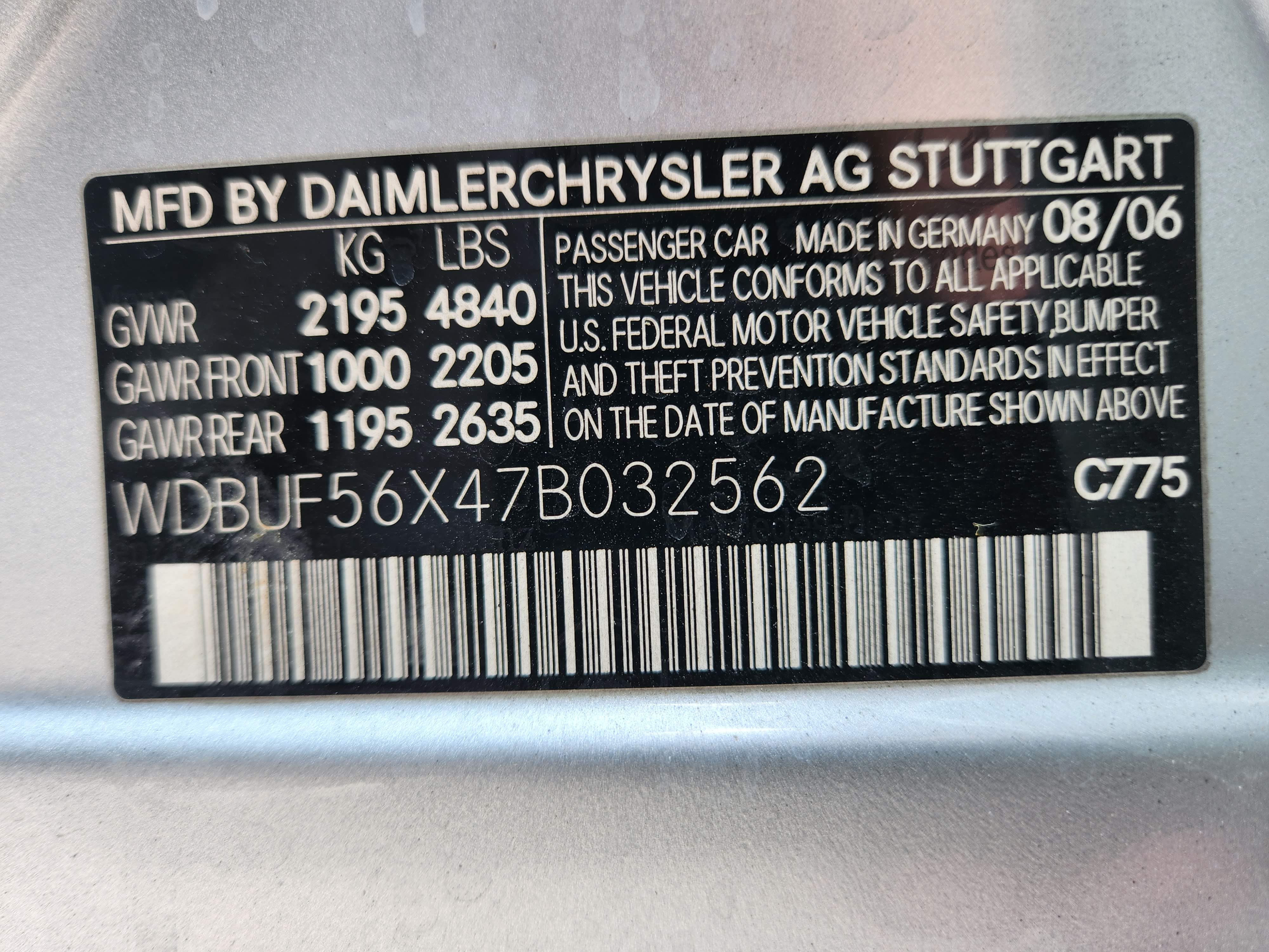

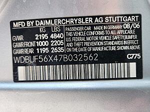

Here is the VIN as requested.....
You have to search all the Amazon vendors. There are multiple ones out there that sell the same thing for higher prices. Here's the one for $50. I'm not sure why you'd want to pay $100 for something that you can get for $50. They both do about the same thing which is read all MB subsystems.
