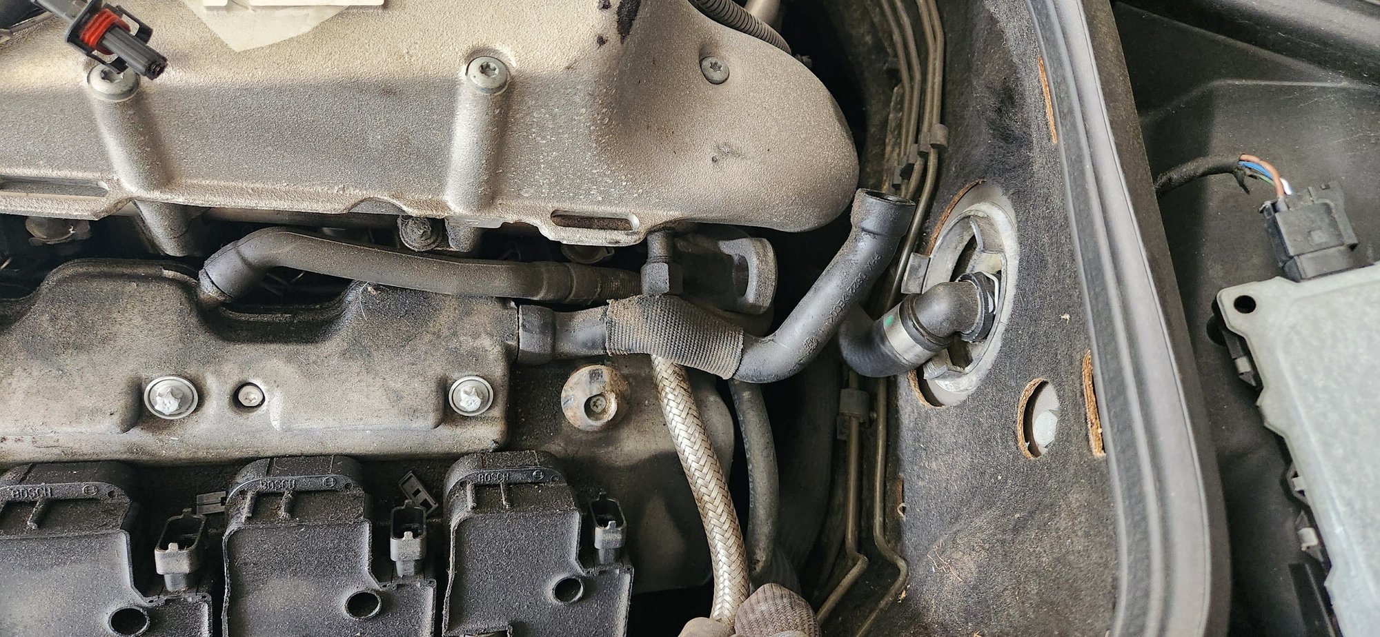

Hi fellow mercers,
The car is running fine, no fault codes whatsoever. But I saw some oil leaks around the plugs and thought to replace the valve cover gaskets. I Started working on replacing the valve cover gaskets and discovered there is an oil leak around the surge tank connection. Can you tell me what is that and how do I fix it. I saw some videos talking about changing the gaskets for surge tank/ supercharger. I don't even know what that surge tank is for. (I am still new at this and I believe it doesn't suppose to have any oil in it). Please advice.
I have a 2k mile road trip coming up in two weeks.
Thanks

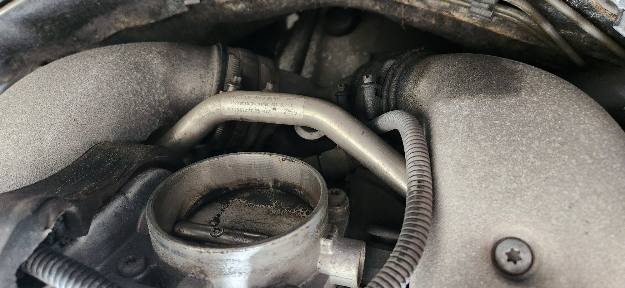

While you are in there - clean your throttle body 😁
Surge tank couplers/piping (short big black hose with 2 clamps each) look like they are leaking…
