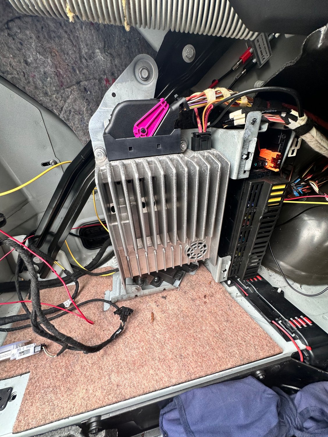

I have a 2009 W211 with the Harmon system. I up graded the head unit to an android unit and can not find the radio antenna connection. There was not one behind the radio, Does anyone have a picture of where to find the antenna wire?

This might help, I pulled together a lot of the wiring details from this. The antenna is in the trunk near the amp though, it's not behind the head unit.

Headunit is basically just an interface, all the magic happens in the trunk.

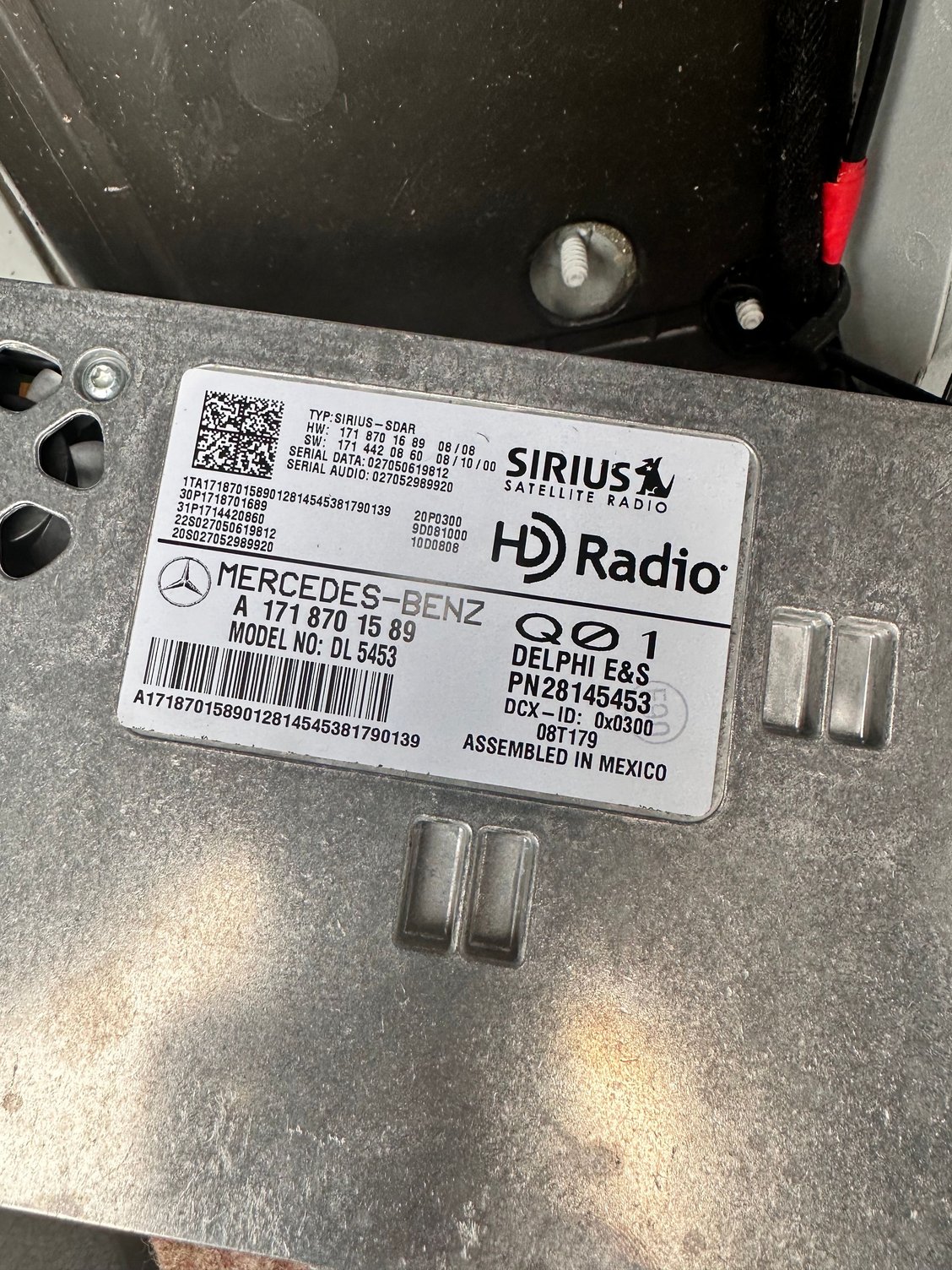

thanks. I pulled the amp and did not find any fakra wires connected to it. I did find a satellite radio module on the right side of the trunk with a blue single fakra and a double white connected to it.
