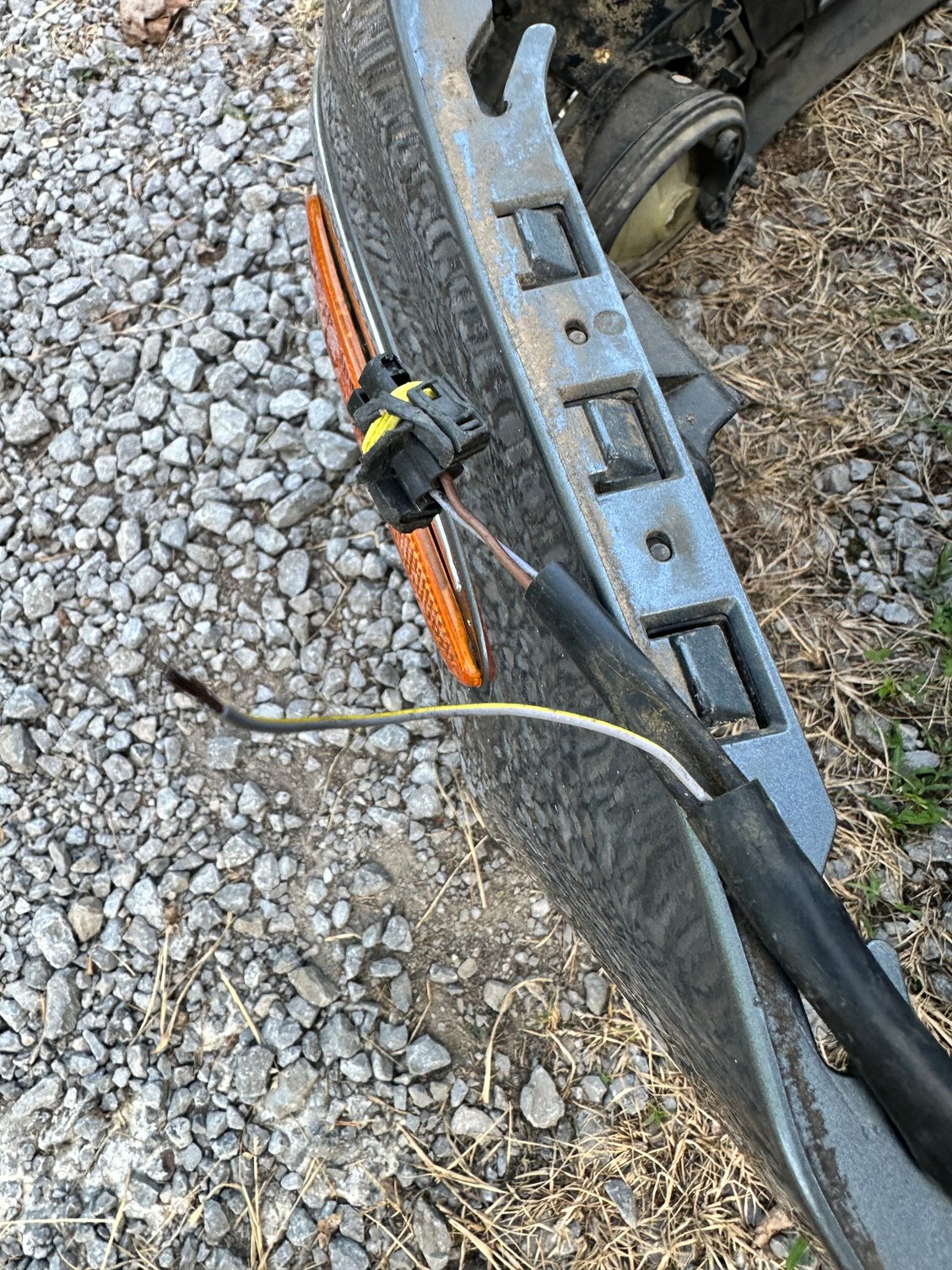

Extra wire with left fog light wire

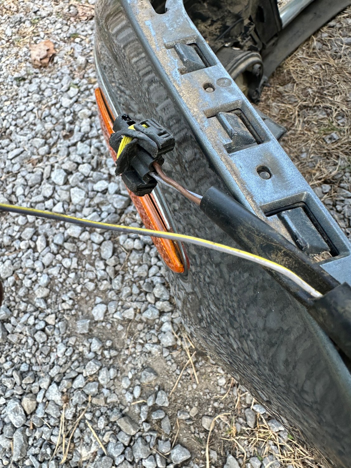

I’m trying to fix the left side fog light harness and noticed there was an extra wire running along side it. I know the fog light itself is only two wires. What is the extra wire running along the loom? It’s not the bulb for the other light on the bumper. I tried looking at the right side fog light and it doesn’t have that extra wire. Whatever it was it was ripped out because it’s just a bare wire at the end. Thanks in advance.

Sorry it took me a few days but I think I figured out what it is for. I think it is the wire for the ambient air sensor. Where the other wire for it is I have no idea if it is for the ambient air sensor. It’s a gray with yellow stripe wire.

Thanks. So I just need to trace the wire bundles to find the gray and brown wire. This was so helpful.

Just to update, I found the other wire. I have purchased a new ambient air sensor with harness and will splice the wires back together. Thanks.
