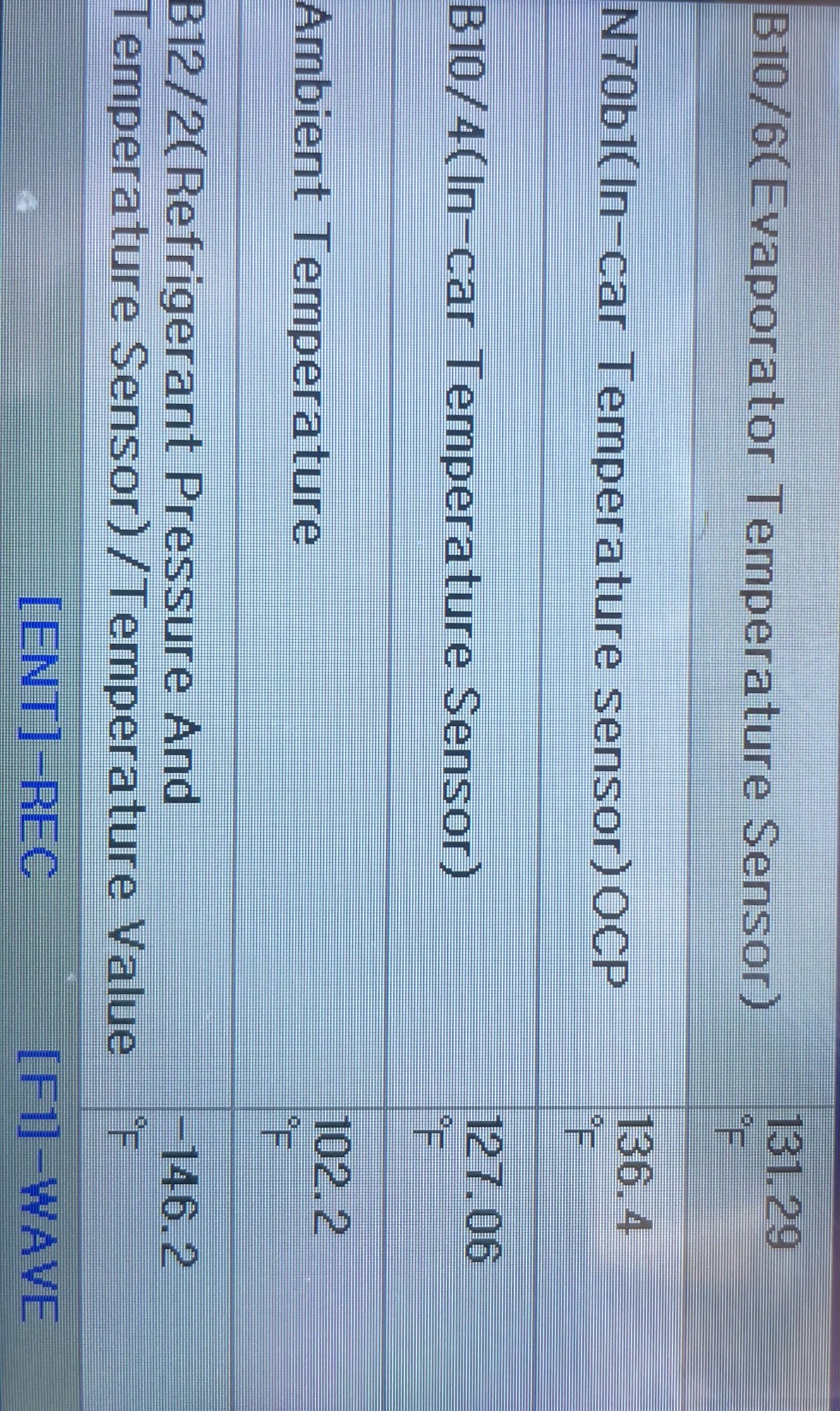

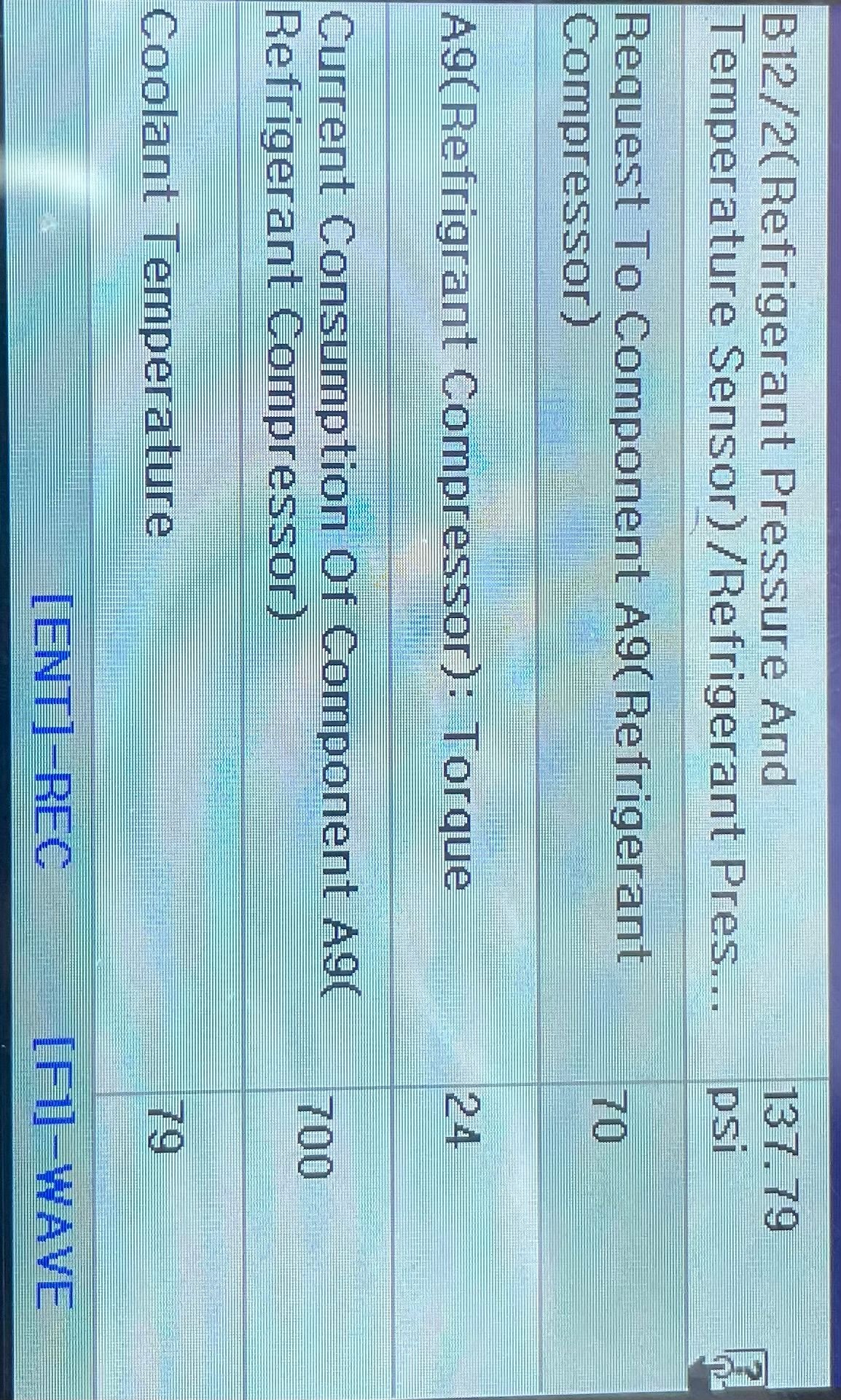

So here are the readings after getting my diagnostics tool. Any idea what some of this means ofc it’s blazing hot but is it due to the compressor?

Please collect two sets of data
1 - car off for a while, so refrigerant pressure reaches lowest value
2 - scan the vehicle, and take those snapshot
3 - car ON, AC at MaxCool or LO setting, engine @1500 rpm
4 - scan again, snapshots
The previous snapshot show low refrigerant pressure.

Unfortunately, the computer only reports the high pressure:137 psi.
For the low pressure, you need a set of pressure gauges. In the US you can borrow/rent them from AutoZone/Advance Autoparts
Also, the iCarsoft report a super negative temperature, -146 F, for the refrigerant because the facelift W211 does not have the sensor anymore.

https://www.igasusa.com/pt-charts/R134A-PT-Chart.pdf
The chart above is for refrigerant R134a, you can read refrigerant pressure for the ambient temperature, 102.2 F in your snapshot. -> 128 psi. Assuming the cars Temperature sensor may 1 or 2 F error, it seems the computer reported pressure of 137 psi is about static pressure in the system when off, or a barely actuated compressor.
Recheck, to confirm those pressures are correct.
Now, the snapshot shows compressor being actuate at 70% , but pressure is not increased. Why?
Is the electronic control valve working correctly? You can do two test at the compressor:
- disconnect wiring to the compressor
- measure resistance between contacts on the valve, note it
- measure voltage at connector, note it. Do NOT ground this contacts since it is a control signal, not a power signal.
If you conclude it is the compressor, the system must be cleaned, flushed well. New drier, condenser, compressor + ??. You need to know why it failed, or the new one WILL fail again quickly
