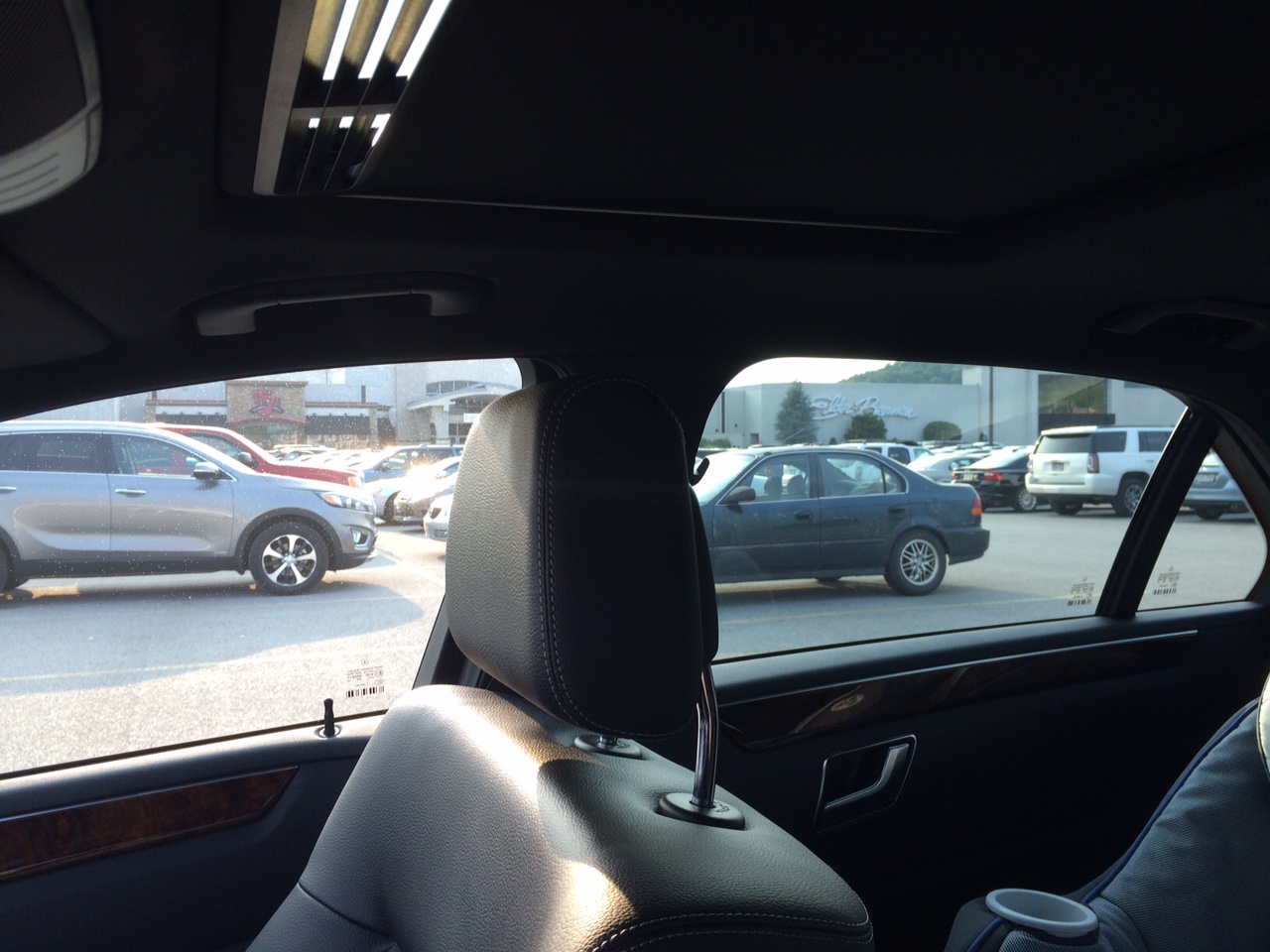

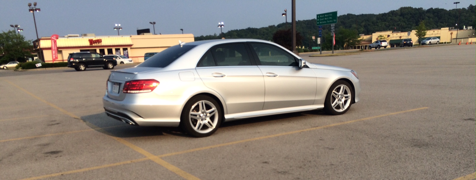

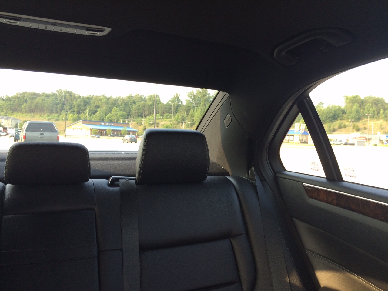

Here are the pictures. As you can see the tint is very mild and not noticeable from inside. It was very sunny when I took these photos.
Attached Thumbnails Window tint-img_2966.jpg   Window tint-fullsizerender.jpg   Window tint-img_2967.jpg   Window tint-img_2969.jpg

Yeah, I can hardly notice the 50 on the fronts. Rears look normal to me as far as tint goes. Personally I like the even look with the same on fronts and rears - then the rears wouldn't seem that dark by comparison.
