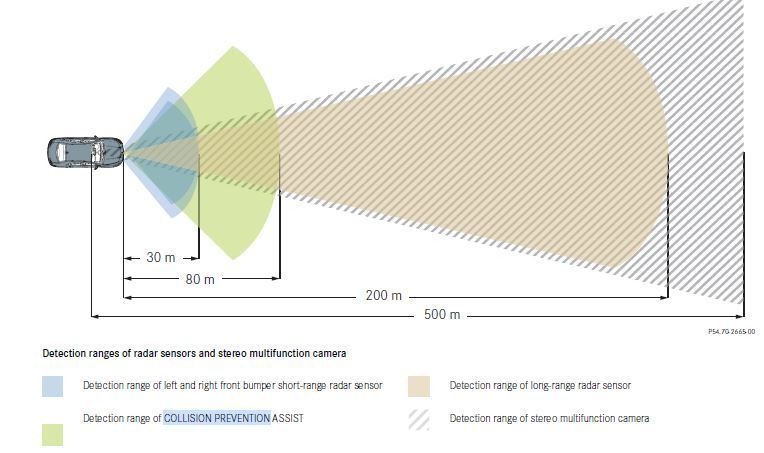

I advise against any alteration of system.
258 Collision Prevention Assist
235 Active Park Assist
Old Jun 30, 2019 | 11:30 AM

Konigstiger, after a lot of thought, I agree with you (and my thoughts in post #33) that the initial plan still makes better sense... That being to install an aid that is 1) independent of existing car systems and 2) does not interfere with existing car systems. I forgot about Parktronic, which I use often. So I don't want to mess with that system.
In contrast, an independent system can be easily installed, and easily removed, if it doesn't work well enough.
The diagrams you posted shows my sole area of interest, the "Area not scanned" at the front of the car. The external sensors described in Post #1 make good sense, even if it means to point the sensor at a downward angle to limit/avoid interference with the bumper sensors.

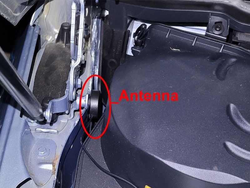

Thinking about where to find power at the bumper, I am wondering if I can install power for this in series (spliced into) my illuminated grille star... Thoughts?

Well, I must be the only bloke here (without 360 camera) concerned about pulling off the front bumper with these aggressive concrete bumpstops. Just three weeks ago, I used a heat gun to bend a 2" under-bumper tear back in place.
Fixed... (see post #17 above for the "before" pic)
I've ordered the camera above, yesterday. It will arrive tomorrow. I've already installed the Casoda App on the smart phone, and it appears to work well, offering both landscape and portrait display modes. I'll do some testing before installing the camera under the front bumper.
I'll post some pictures here... if anyone is at all interested?
Yup, interested.
Did you determine where you will splice in power for the camera?

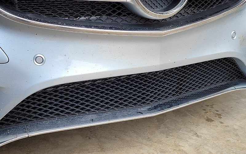

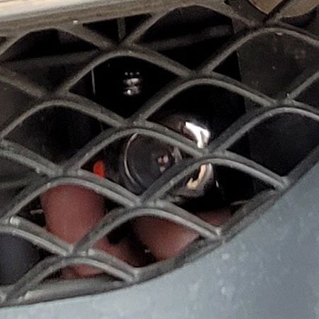

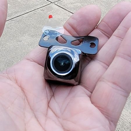

OK, this camera is tiny... just under 7/8" on a side. It is very well made and completely sealed from the elements (per IP69 standards for waterproofing).
It's aperture is small enough that I think it will shoot through the diamond facets in the grill (mounted from behind where it's hard to see).
So now, the question is how to remove the black, lower grille to find mounting areas behind. This grille is part #200 on the front grille schematic (below), but the drawing shows no fasteners to explain how it attaches to the painted bumper.
Is this grille just a pop-in that can be removed from the front (without removing the bumper)?
Please excuse the dirty car... It needs a wash...

I've watched a couple videos on how to remove the bumper. Turns out that I may not have to remove the bumper at all. Instead, I think I may be able to access the back side of the lower grille simply by removing the engine splash shield, held in place by 5, 8mm bolts.
This would be preferred, so as to keep all the bumper/grille parts in place. This way, I can create an adjustable bracket, attach the camera, and tune the aim of the camera (through the lower grille) as I go.
Has anyone removed the engine splash shield? To drain engine oil from below? Is it as simple as it appears?

Today I tested the system (unistalled but laid out as proposed), and it works great. Excellent resolution, which is the same with engine running or off.
Then I installed the round, WIFI antenna on the passenger's side vertical wall next to the cabin air filter intake above the battery. Reception from this place through the firewall to my smart phone mount on the dash air outlet vents (no more than 3-4 feet away) is superb. In this location, there is plenty of wire leftover to route to the proposed location in the lower bumper grille...
I also wired the power (+) to the fusebox, piggy-backing on my existing fuse tap for the Illuminated Star. And there remains plenty of wire to route under the bumper as well. The negative wire is grounded to the top of the shock tower. Retest and everything still works.
Two hours later it's dark, leaving me to plan the next steps for Sunday, as it will be raining tomorrow. The next step is to finalize the routing of the cables to the lower bumper grille area. But more important, the really major step is to put the car on blocks so I can get my 70 y-o carcass under the car, remove the engine shield and test camera installation ideas. Stay tuned.
