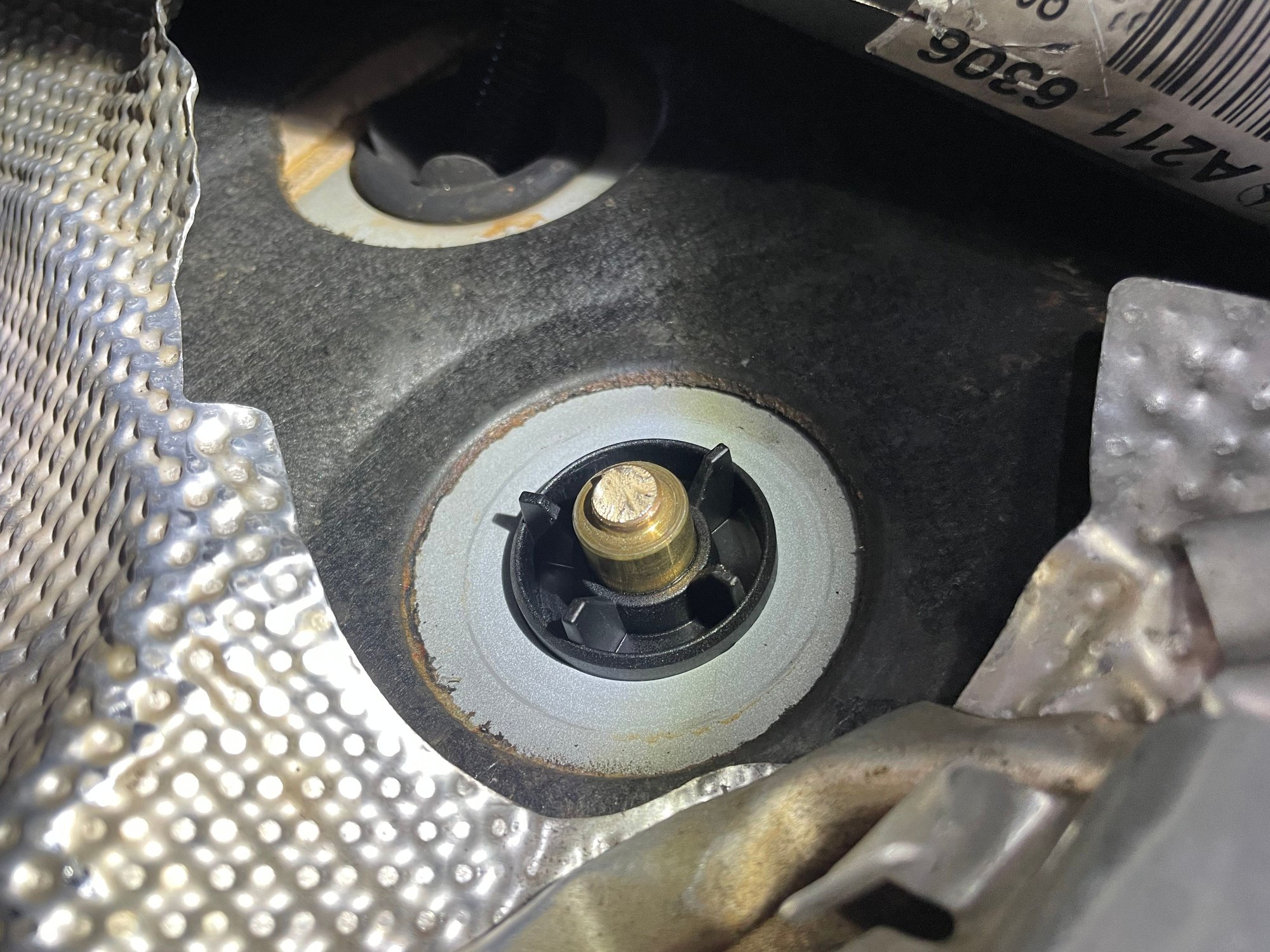

HELLO I drive a w211 2008 e350 4matic USA any idea how I could fix this
( I stripped the ground bolt near the starter and I’m unsure of what to do in this situation does this connect to anything else or is it just a ground do I need it?)
Old May 24, 2024 | 09:37 AM
  #54
S-Prihadi's Avatar
Joined: May 2018
Posts: 6,633
Likes: 6,575
From: Jakarta-Indonesia
Get a wider angle photo so that I know where that actually is and its surrounding component. I am not familiar with other than W212 and W204 sedan.
Yours would be W211 if 2008 yes ?
That broken stud seems to be made of brass and is not steel threaded stud welded to chassis like W212 WTF ground post to engine starter/tranny housing.
I think your version of ground stud has another connection bolted inside the car interior, because it is not welded type.

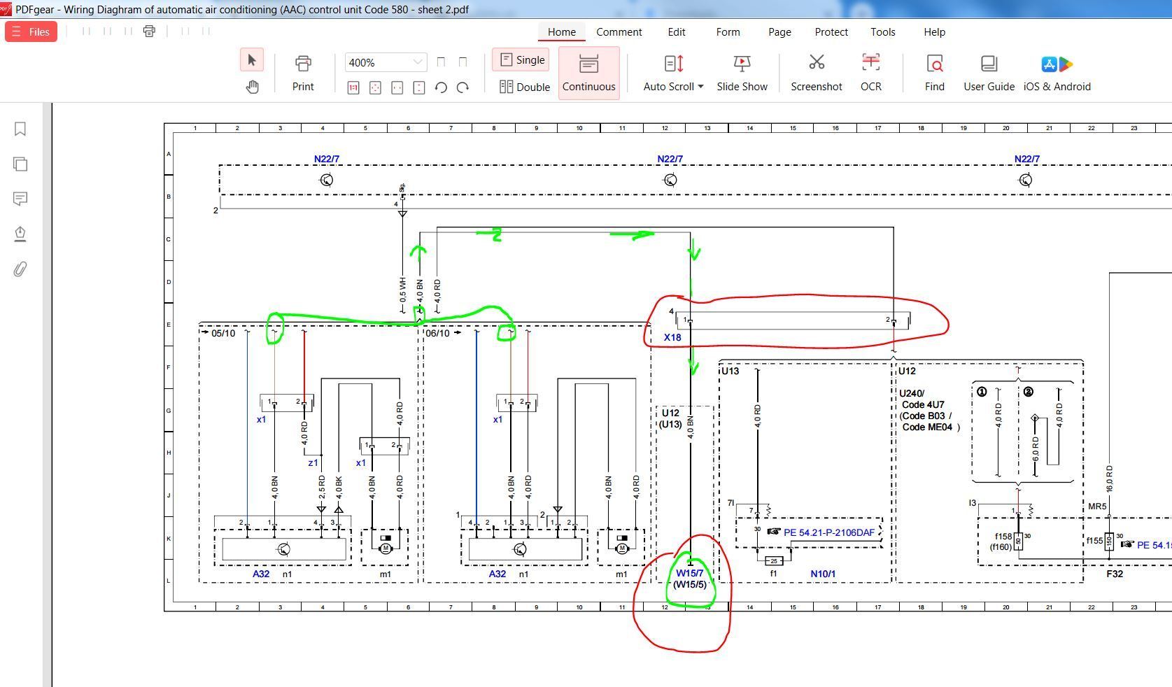

Thanks for your detailed information and pictures, do you know where the motor blower ground point is located, i have no air coming from the vents, blower and climate control unit fuses are good, installed new blower and its resistor still no air, control unit works fine but blower is not spinning, I tested the blower connector coming out from the car it reads 12v for positive but 0v negative, im pretty sure something is disconnected or loose.
Old Mar 17, 2026 | 12:15 AM
  #56
S-Prihadi's Avatar
Joined: May 2018
Posts: 6,633
Likes: 6,575

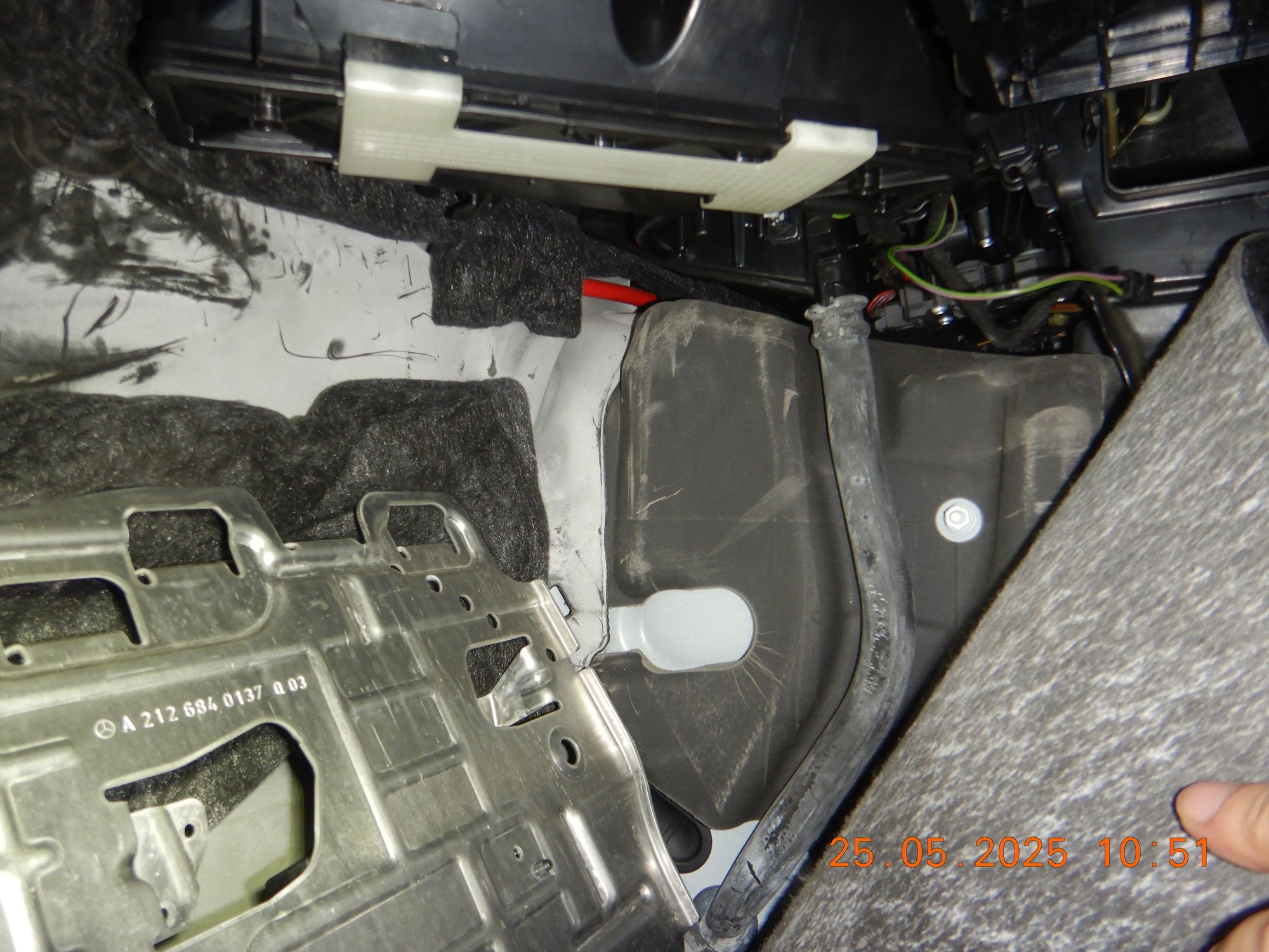

I assume you know how read wiring diagram..... 4 PDF attached.
W15/7 is the ground for left hand drive car with HVAC blower at RIGHT side of car.
A32 is the speed controller ( resistor some people call it ) of the HVAC blower motor. M1 is the blower motor itself, also called A32m1.
Seems to be very close to A pillar bottom.
My car is Right Hand Drive and is facelift model, for my HVAC blower ground it will be LEFT side of floor for its W15/5 ground , yours being LHD car uses W15/7 ground.
See below : There is a steel plate on my left floor to firewall if I want to find my W15/5, like a protection steel bracket for some electronic module/s, I think your W15/7 ground would be similar...maybe.

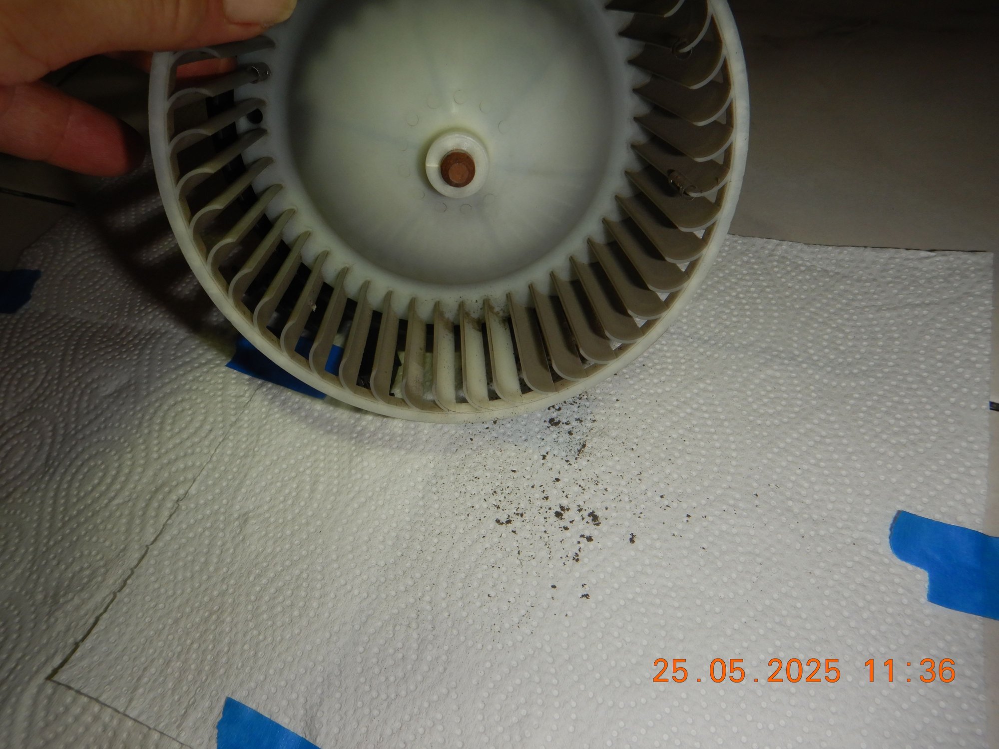

I was cleaning my blower. The more dirt on it, the more unbalanced it becomes and will shake and destroy the bearing
Good luck..........
Old Mar 17, 2026 | 03:53 AM
  #57
S-Prihadi's Avatar
Joined: May 2018
Posts: 6,633
Likes: 6,575

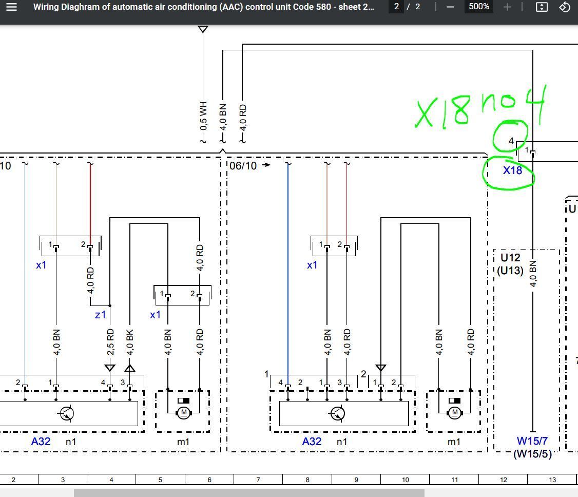

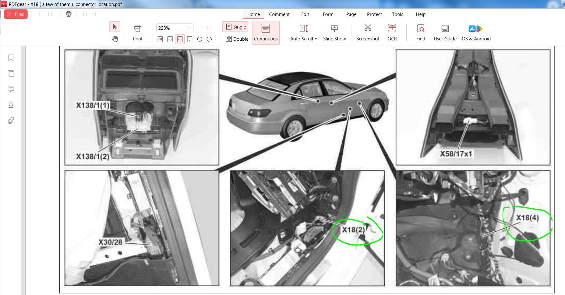

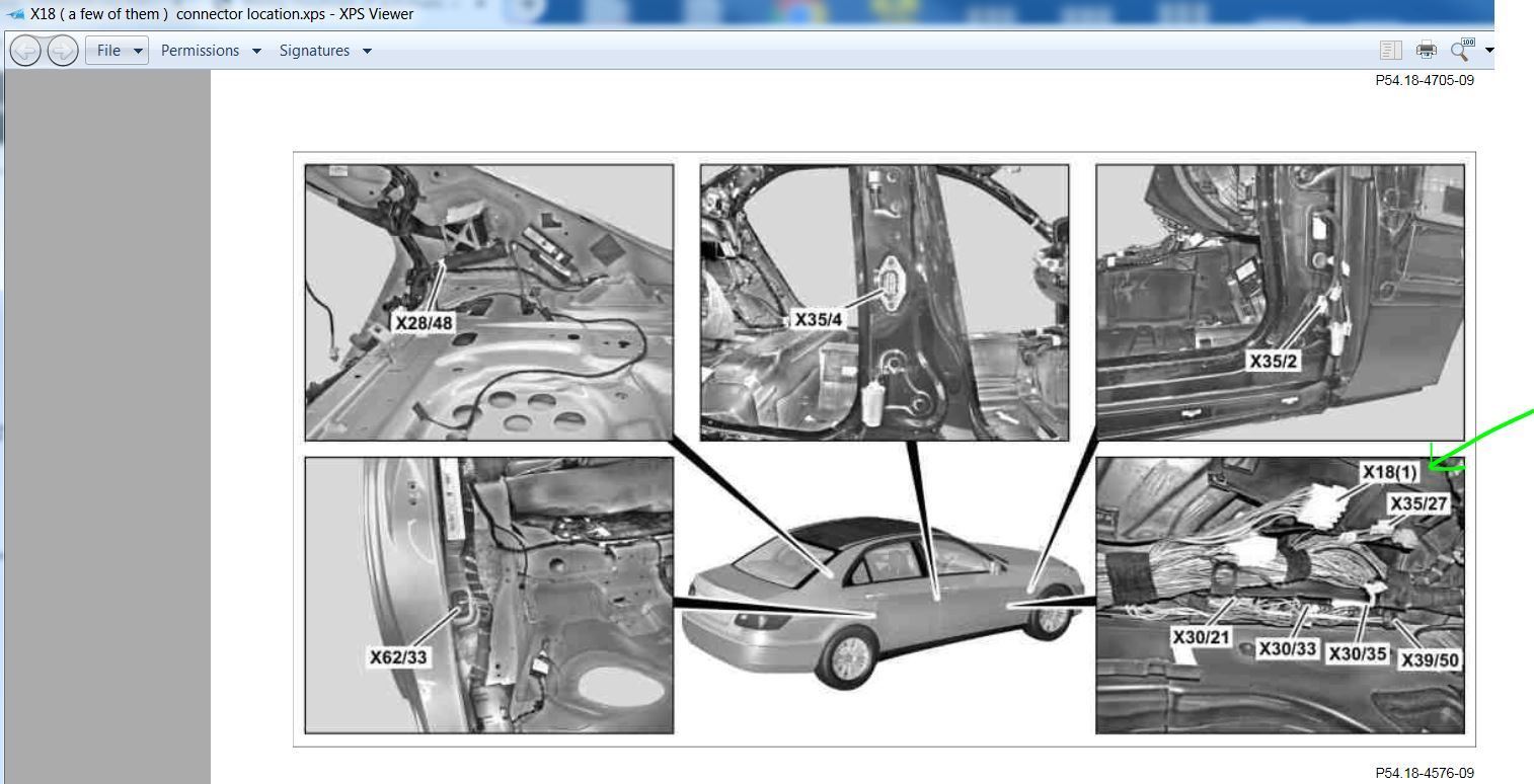

I forgot to explain in better detail, so that you can be certain to trace all bad contacts, if any :
Depending on year of production of your car, you can see -->05/10 ( meaning up to May 2010built date ) or 06/10 ---> ( meaning after June 2010 built date ), you must get VIN decoder to print out your car data card to
see this.
Assume yours is 06/10 ---> ( meaning after June 2010 built date ), so the negative or ground connection to the motor m1 is via 2 intermediate connector.
One small one called x1 and the bigger one X18(4) or X18 number 4.
You must make sure their female pin is tight fit to the male pin.
If only X18, it is then X18(1) or number 1.
The 2nd or third or 4th X18 will be written as X18(2) and so on. You are to look for X18(4)
The W15-7 itself is a shared ground stud with many other components. So you will see many cables there and not for HVAX blower only.
Just so you know, Mercedes wiring information some are wrong if not confusing.
Happy hunting..........
