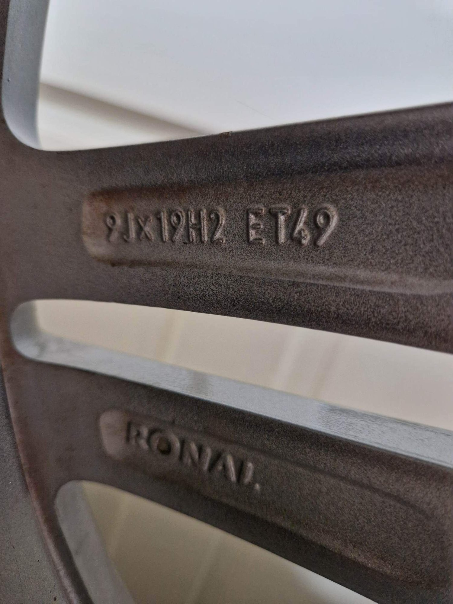

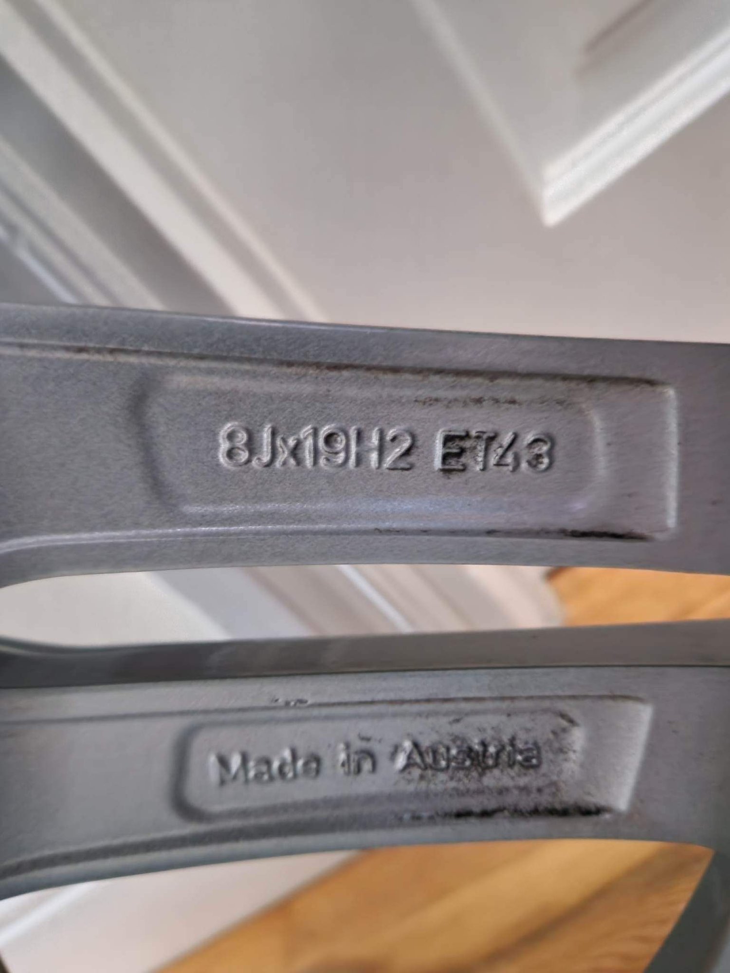

Check inside the rim for molded measurements, with ET being crucial here.

That’s the info.

From my memory, original offset is in 40's on W212, so that should not be a problem.
This is staggered set, so you have to be careful with tire choice.
Still if you have rims already available, why not put the front one on and make double sure?
Nominal sizes are not always telling everything and you will go to 19' rims, what will not put much rubber on it.

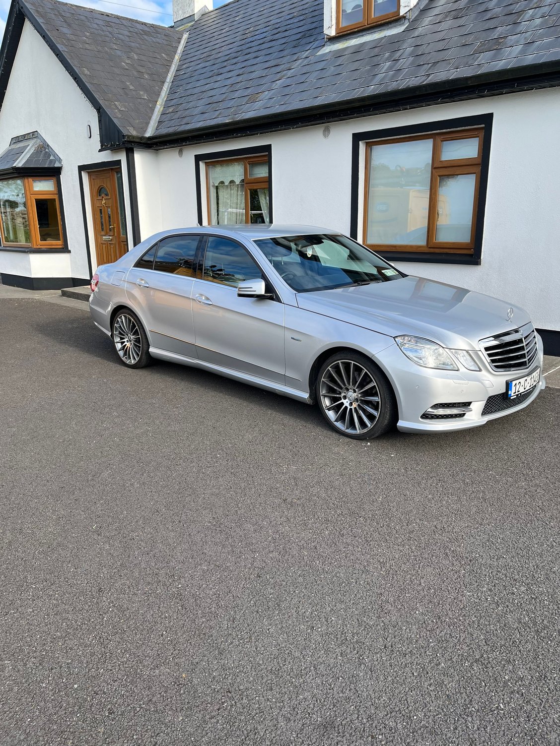

Went for these in the end,think they suit the car nicely.

Those look nicer to me
Great choice
