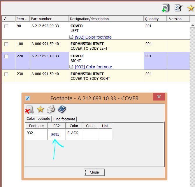

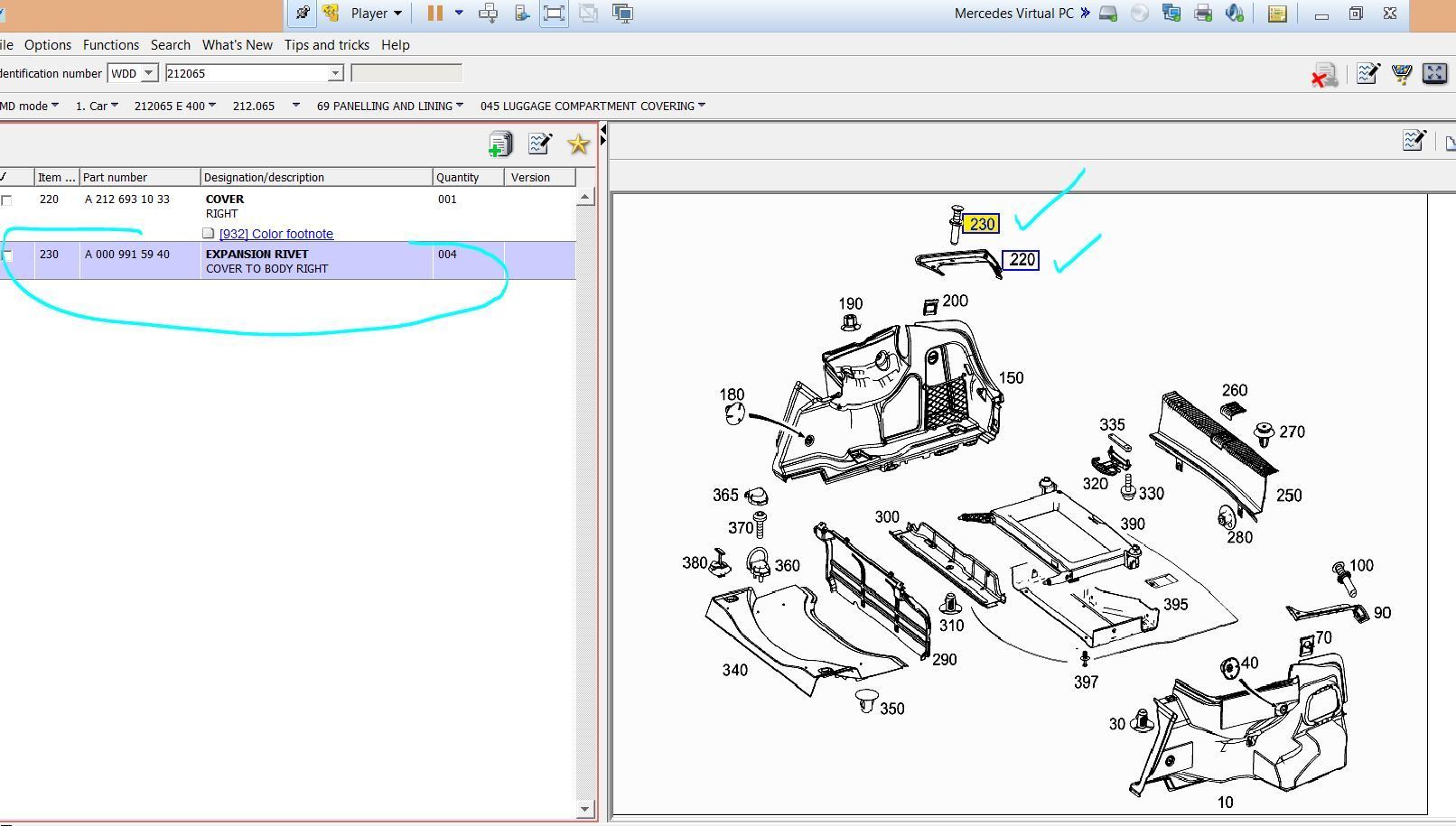

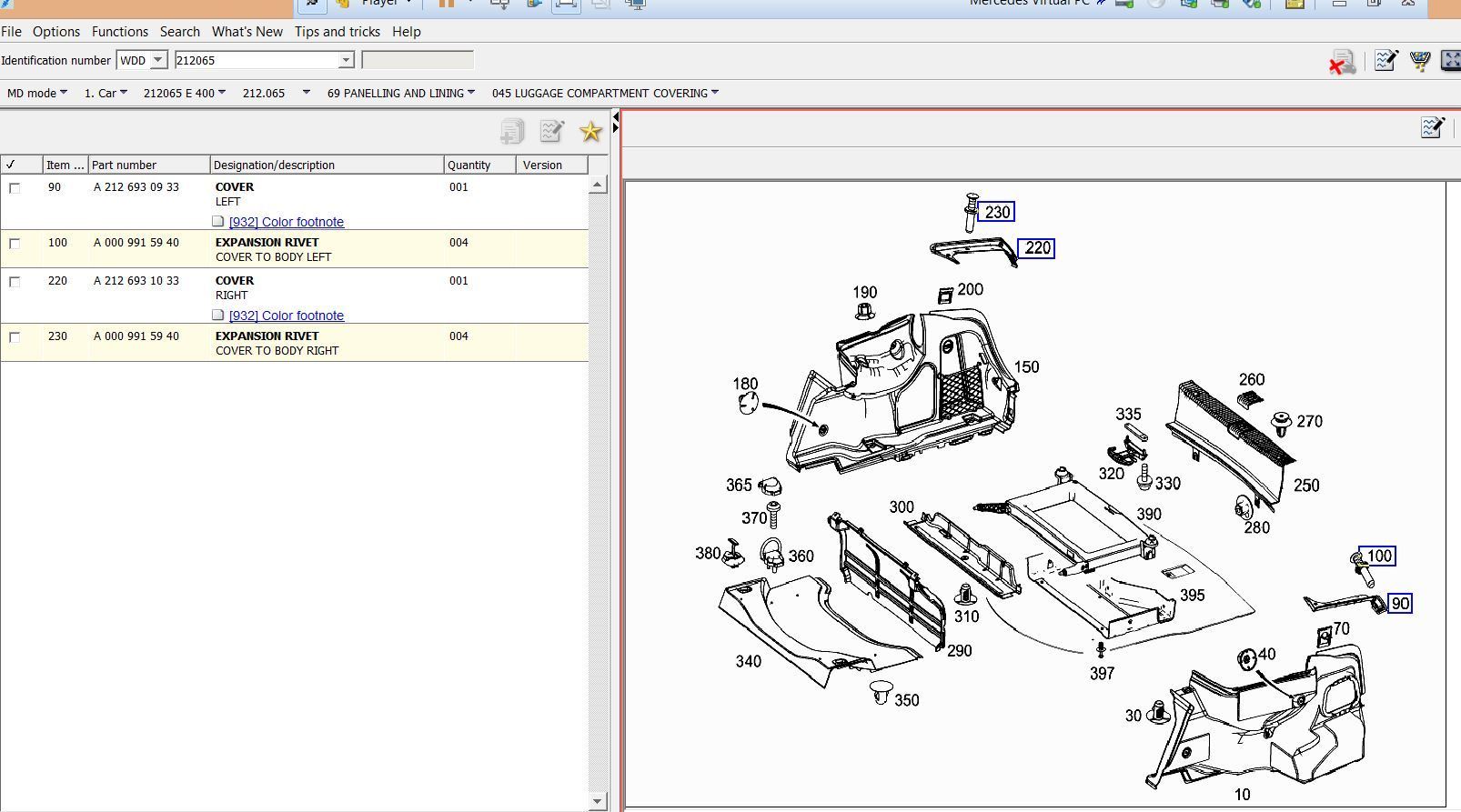

Nope, it wont surely get destroyed if you are careful...... by its design I know it wont be destroyed.
here u go my man..........
Damn EPC, something quite big and they drew it like it is SO SMALL good thing you gave me the P/N, so I can backtrack with SEARCH

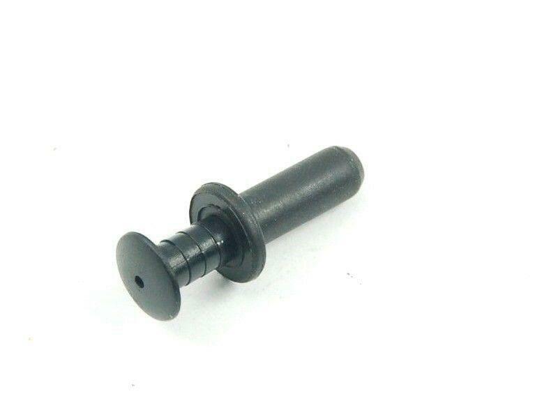

Here is the RIVET
https://www.ebay.co.uk/itm/276100209713

it's a self-sealing rubber rivet - They are not going to leak now if none are missing and you were gentle upon removal.

Oops, updated EPC. With LEFT and RIGHT side plastic cover P/N. It is drawn so small I did not realize it is there LOL
COLOR FOOTNOTE
Ohh, so the female part of the rivet is rubber and not plastic Cali ?

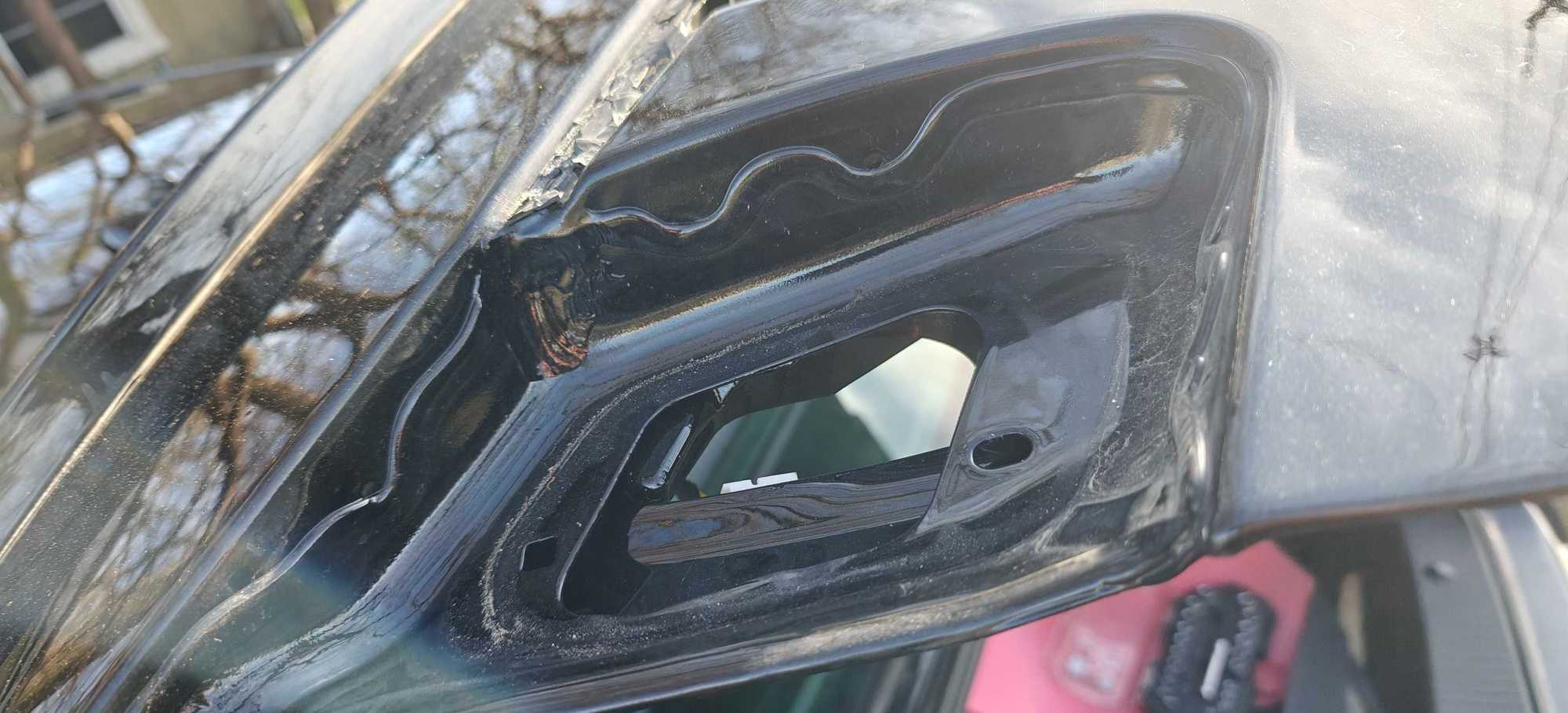

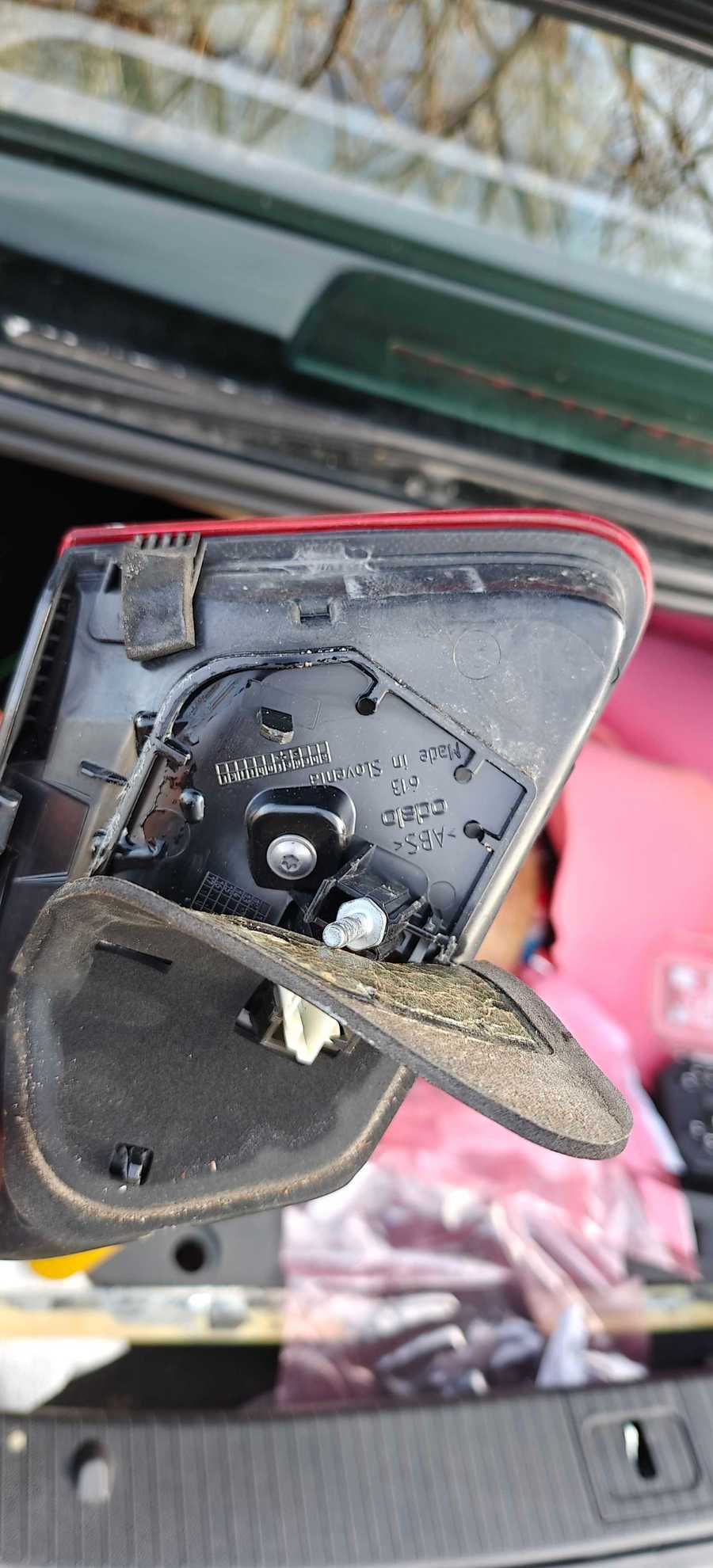

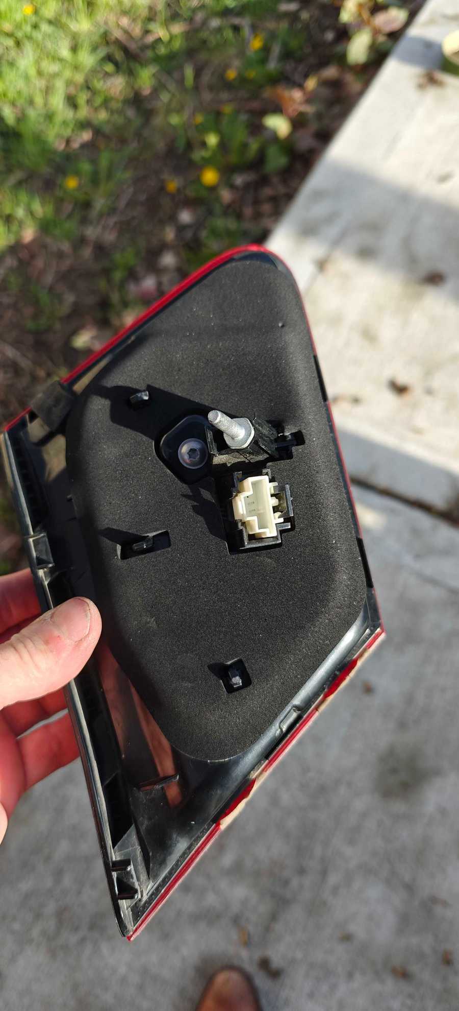

OK, so I was removing that chrome plastic piece because the chrome was flaking off. I ended up making it black and putting it back on instead of replacing it with another metal film wrapped piece just to see if I could. In the process, I removed the trunk liner and a lot of the parts mentioned previously in this thread. The pics were very useful.
Since I had easy access, I replaced the foam seals behind the lights in the trunk lid.
I have not touched the plastic pieces on the sides of the trunk because I determined that they can't possibly be leaking (yet). They would be dumping water into another region if they were.
Since I replaced the foam light seals, I haven't had any new water intrusion. But, it was sort of intermittent before, so I can't guarantee that the problem is fixed.
I noticed a few other seals on the black plastic piece external to the trunk lid where it interfaces with the trunk that I can replace next. And there are some orange plastic clips that snap from the black plastic piece into the trunk that don't seem to have a dedicated seal. Fresh orange plastic parts or possibly adding some tiny O-rings to these might be a solution if leaks are coming from there...
