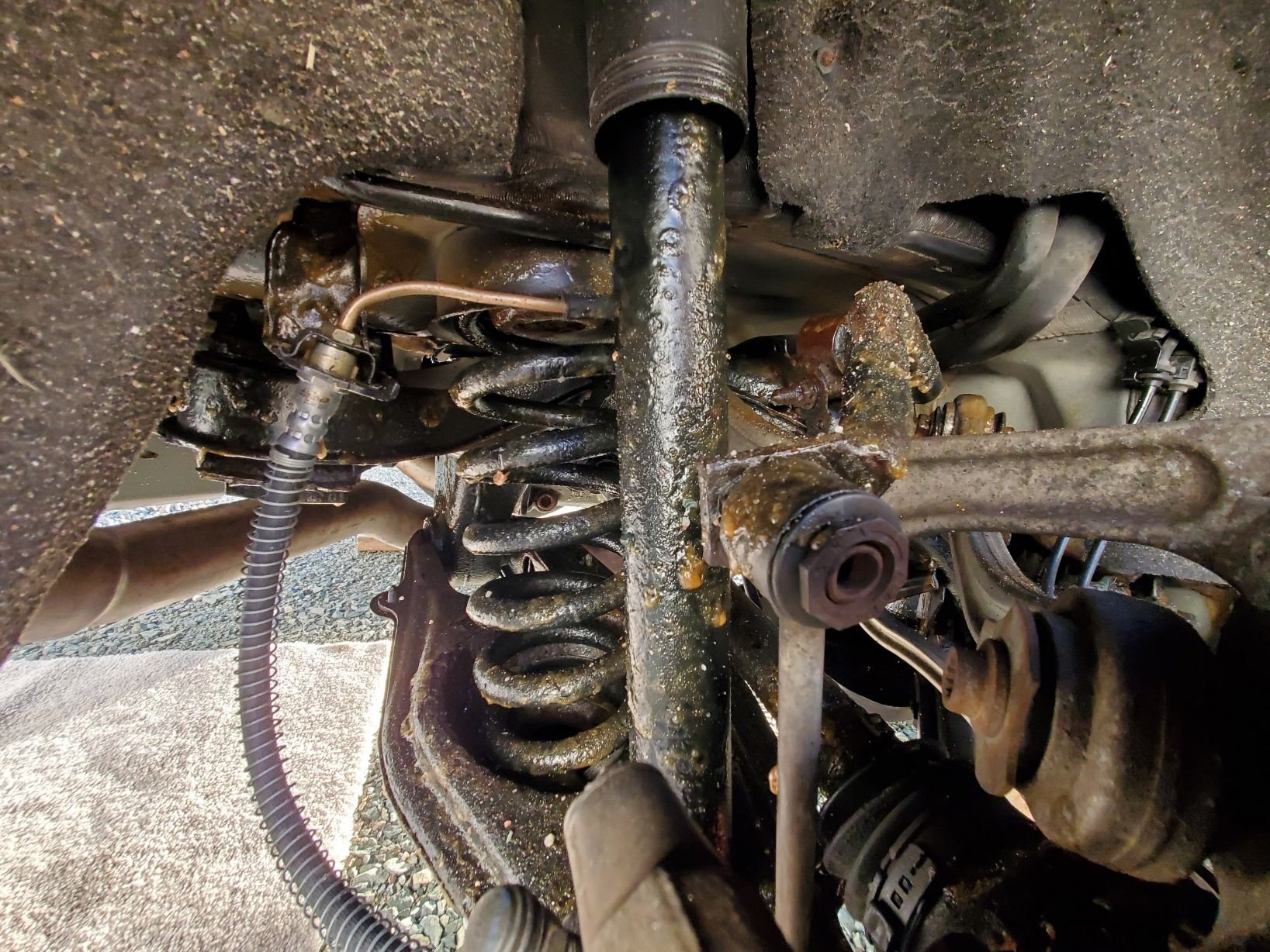

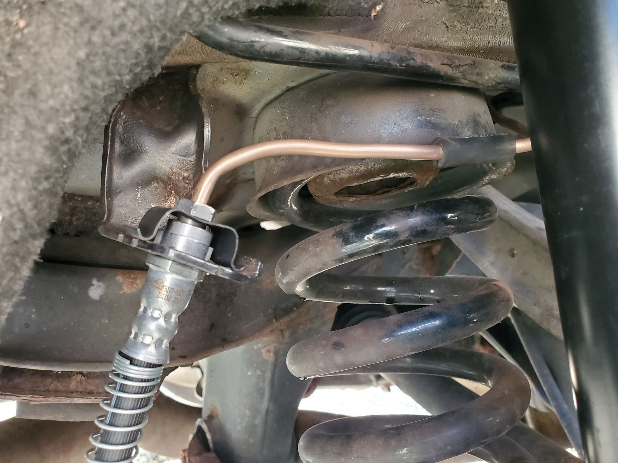

I have no interest in replacing the hard lines because they will almost certainly outlast the car itself.

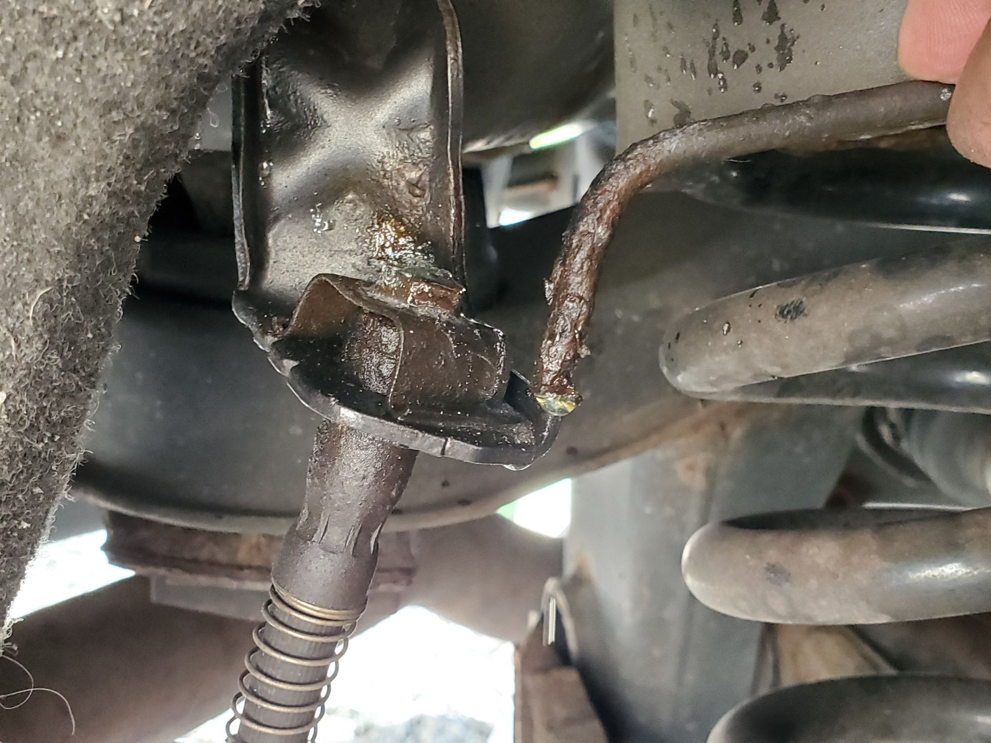

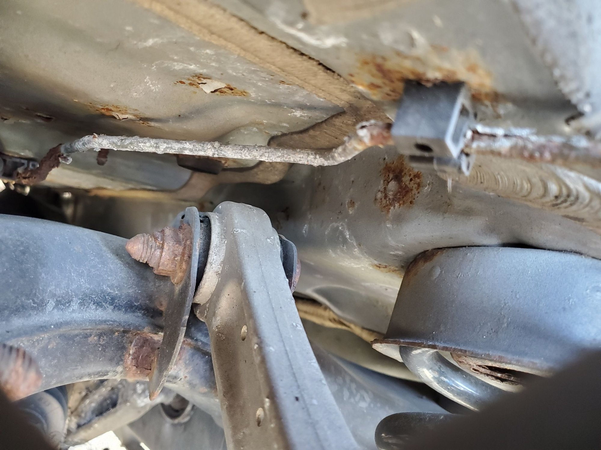

if you drive in the rust belt where they salt the roads in Winter, your zinc/steel brake lines will start to rust through in about 10 years and develop pinhole leaks.
whats sick is, Mercedes, along with Volvo, pioneered copper/nickel in the 70s or 80s, all my W124 generation (1985-1995 E class) Mercedes used it,. so did our Volvo 240, 960, 850, S90, and 740 (all from the 80s-90s, all high mileage cars)... those brake lines last *forever*. I'm not sure when Mercedes decided 'forever' was too long and reverted to the cheaper steel/zinc lines.

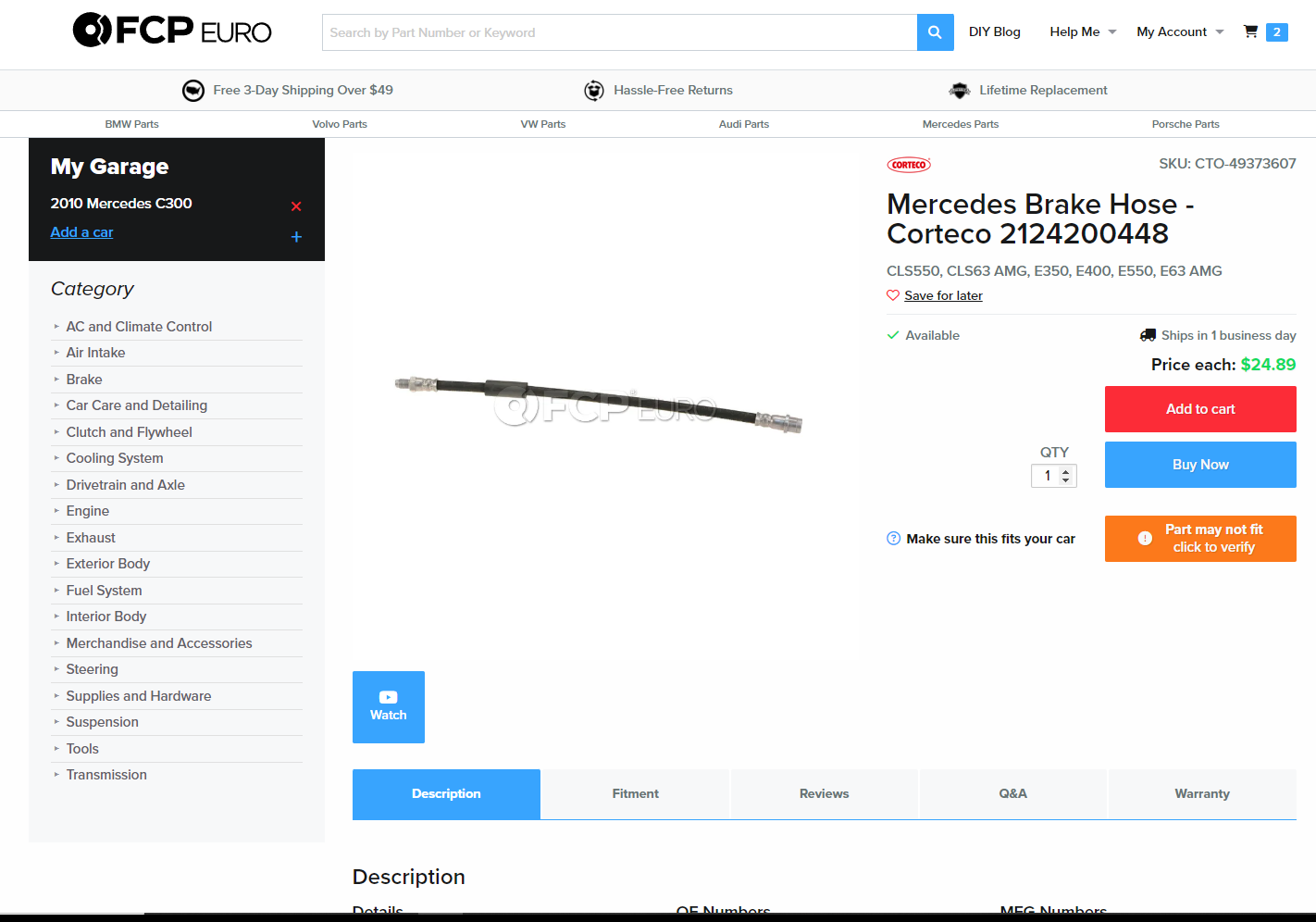

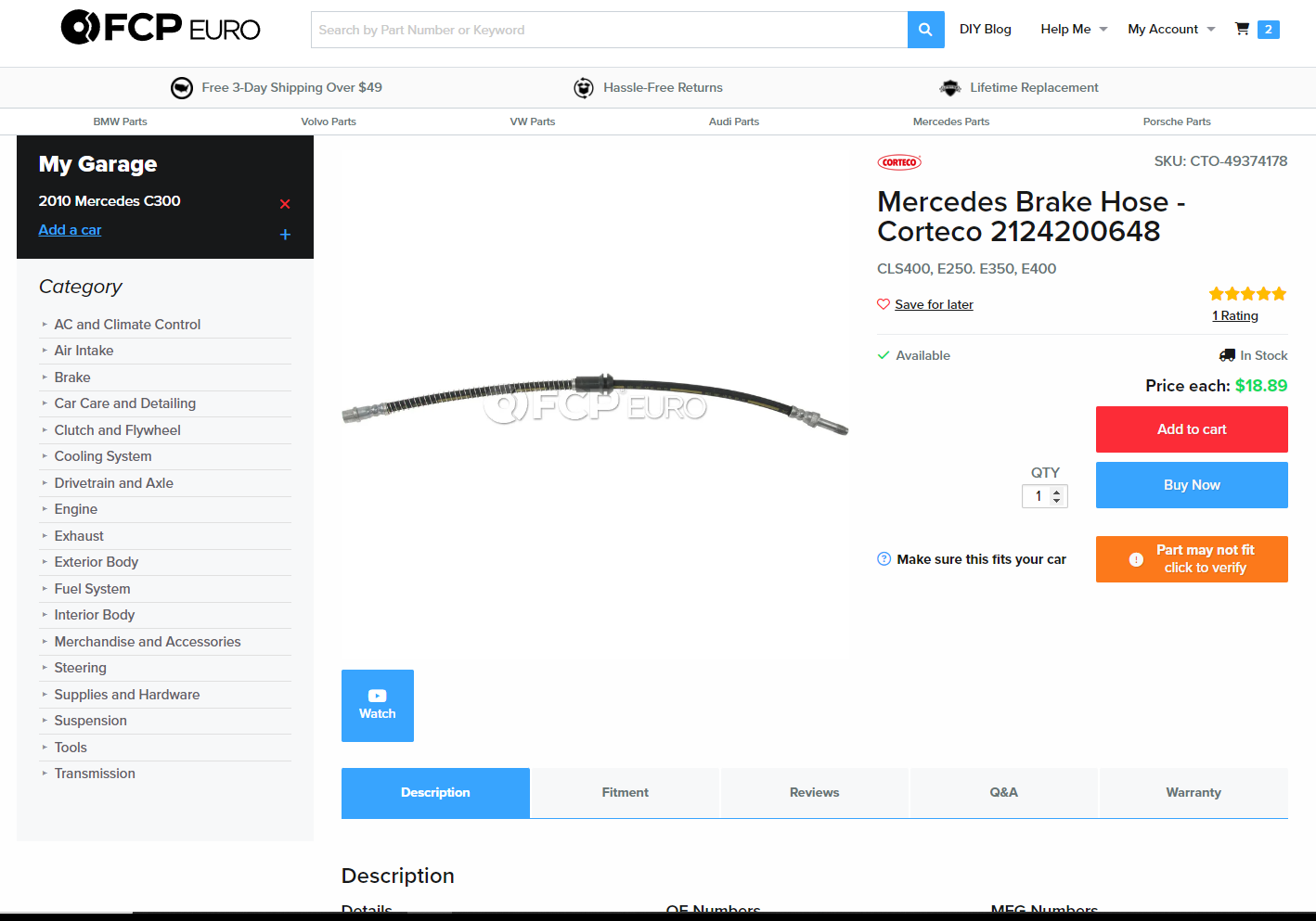

I would just get the regular flex lines from FCP. If they ever wear or crack buy new ones and return the originals for store credit as part of there lifetime warranty.
That Viva performance says limited warranty and only if installed by licensed mechanic. Id be doing the work myself so rules me out.

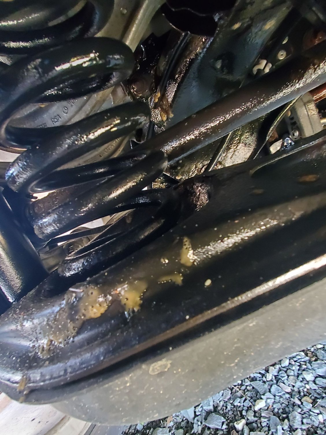

I recently replaced a severely rusted passenger rear hard brake line. The line was so rusted I could not unscrew the fitting to the flex line, had to cut the line then even a socket would not budge it. Thankfully vice grips worked. I replaced the rear part of the hard line with nickel-copper line. I used genuine Mercedes fittings. For the flex line I used ATE from FCP.
I dont have a crystal ball but I will bet if the car is located where there is snow in the winters then the hard lines will rust. On mine I noticed the hard lines are rusting at all the bends and fittings, basically anywhere the poly coating has been stressed/scraped/removed. Its just steel under there.
I looked up the genuine Mercedes flex lines at my local MB parts dept and they are $80 front and $62 rear. The Corteco lines at FCP are looking like a very good option in my opinion.
I cant say I ever drove a car with stainless flex lines though cant see how they would make a noticeable difference.
I don't think I currently have this problem, but will get a better look soon as I do some work around those areas. I didn't realize that Mercedes had shifted to crap hard lines. I have had late 70s and 80s Mercedes that all probably still have decent hard lines to this day. I have an 86 560SL that had a leaking hard top with water eating away the wooden shelf, both sides of the rear floorboards, and the top of the gas tank. Hard lines are still in great shape. So this area has been off my radar until now.
There is a ton of road salt here, but somehow I have avoided any new rust during the time I have owned a vehicle here (my wife had a Subaru and it didn't fare so well). Mercedes has typically done a great job of rust protection and I rinse the entire car off multiple times a week. The W212 does have many more belly pans that block water spray than even the W211 though...
I replaced my 2013 brake lines from front to back last year early spring, if you are in Chicago and the car is from there, you are already on borrowed time, WCG is right, Copper-Nickel is the way to go. I also replaced all the rubber lines, they were still ok but I was in there and they were 11 years old and the mounts needed replacing.
Your in Chicago - I PROMISE YOU that the lines will rust out in not too long.....(been there, done that). Go the heck out of Illinois (as anyone with a brain does).

Took a peak at the front ones while working on my washer bottle and they are still fine.

Really disappointing that Mercedes made that switch, but the lines are still OK for now.
I'm not a big fan of Illinois, but I'm not going to let the terrorists win. I'm staying until I decide to leave for reasons unrelated to the crappy government.

Heres a thread i made documenting replacing my rear passenger brake line last October: https://mbworld.org/forums/c-class-w...ake-lines.html
Has all the parts I used. I recommend using the genuine Mercedes fittings since they are very good quality. i bought some AGS fittings and they didnt seem to want to compress the line and the machining was just horrible. The Titan iso/din brake line flare tool is excellent.
It looks to me that my drivers side rear brake line has been replaced at some point, it was in much better condition than the passenger side. Both front brake lines look ok. This winter i sprayed both Fluid Film and Surface shield, and even used CorrosionX HD under the car to try to prevent rust. I never bothered trying to prevent rust before, so we shall see in spring if it was worth it.
The undershields do a good job protecting the underside at the front. Seems to be the rear is where road salt gets kicked up on everything. Most things under the car i replaced was due to rust. The front struts, rear shocks and springs, now the passenger brake line. last winter I replaced the rear shocks and they were covered in road salt. Had to replace the transmission pan due to rust.
heres after i sprayed the corrosion protection, removed the wheel liners to get the brake lines: CorrosionX HD is thick stuff but seems to pick up sand and rocks.
