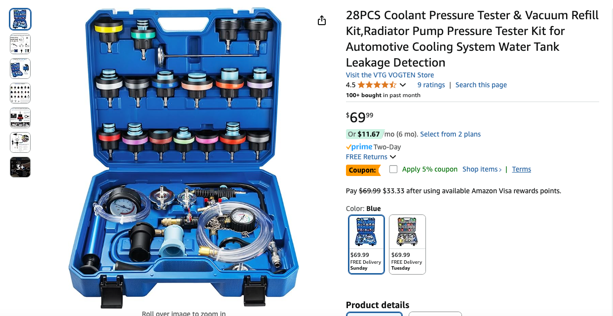

The coolant level sensor is in the reservoir. That's where you should add fluid.
Makes me wonder whether the shop had to disconnect a radiator hose to remove and install the bumper. Was it the entire bumper or just the bumper cover?
There is a proper process for draining and filling the coolant on the M276 (and other) engines using a vacuum refill device.
https://a.co/d/i8ba3ZG
