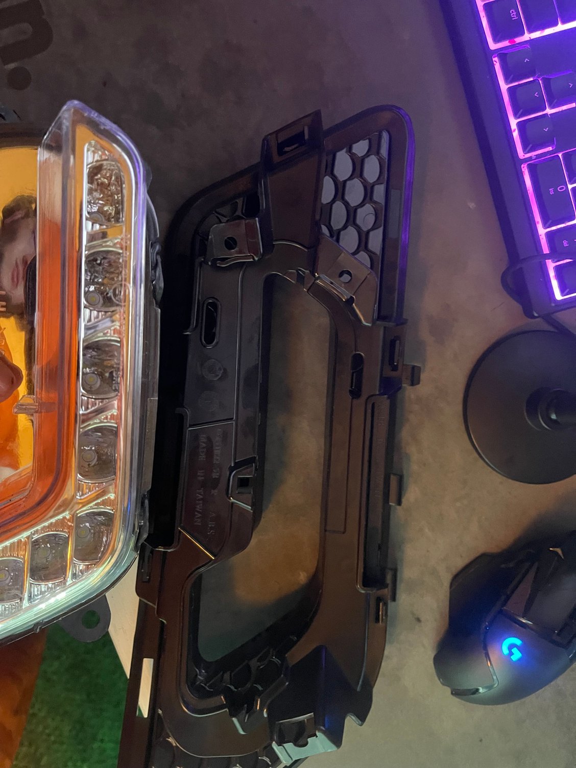

How in the hell do get these to mount on… a screw a bolt ? Does anyone know the exact size I have 0% tent for medical reasons so these will come in handy at night it’s going on my 2013 e350 if someone can send a link for it on Amazon the lord will bless you

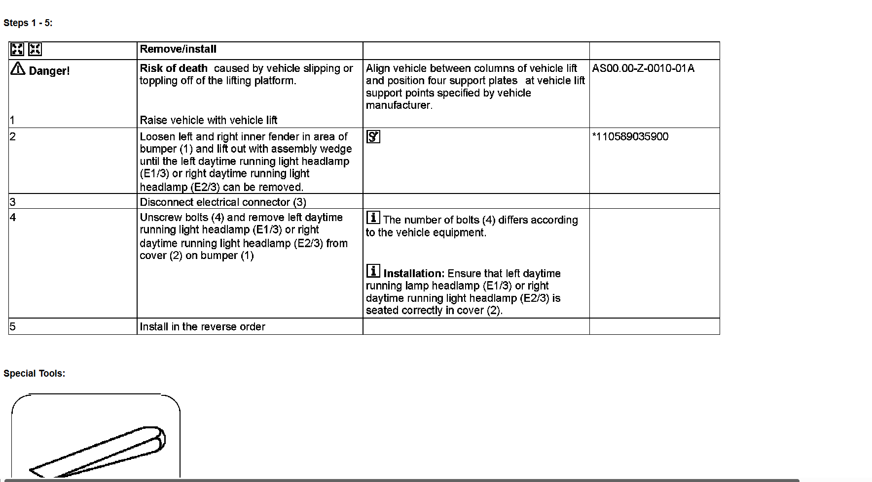

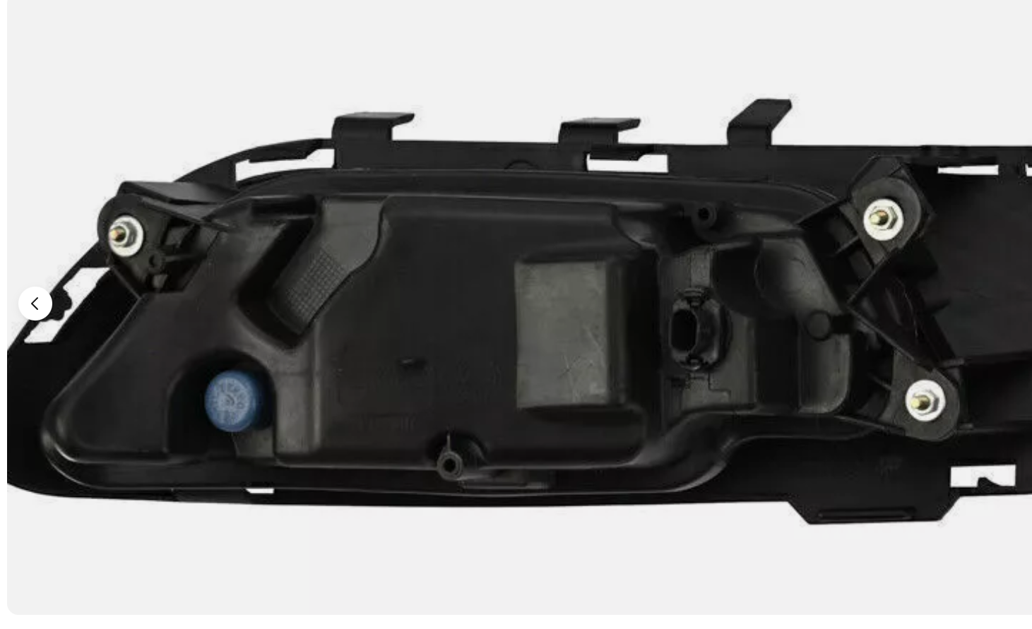

I dont have those lights so looked around for photos. Seems it shops a few small nuts, bolts and washers holding them together. Id need to know more about the lights, whats the exact part #, where did you get them?
Theres no hardware they came with?

From inside the bumper under the car.

Im guessing the surround will snap in to the bumper at the tabs.

Yes, there are plenty tabs.
