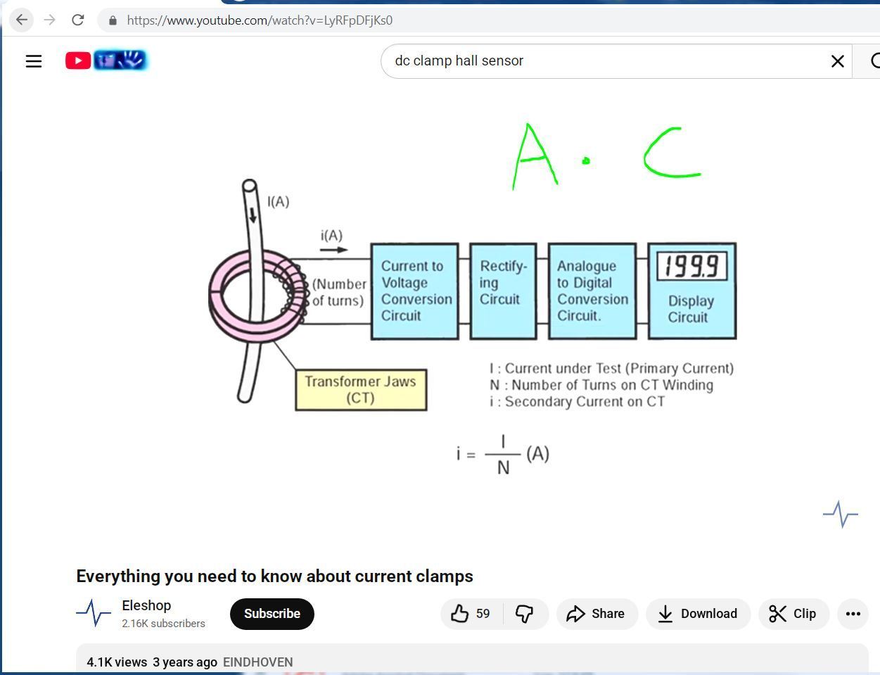

Current clamp is AC mode is easy, DC mode is a different story and sensor.
Both AC or DC current clamp read magnetic field, but alternating current 50 or 60Hz to be accurate to say 1-2 milliamps is quite easy because
the split core current transformer ( sensor ) gets pulsating-polarity-keep changing magnetic field from the AC 50 or 60 Hz, the device processor can filter out easier near-by
magnetic field from ferrous metal which is not pulsating at 50 or 60hz and has single polarity usually.
DC clamp sensor is using hall effect sensor.
Those who like to learn, below is good :

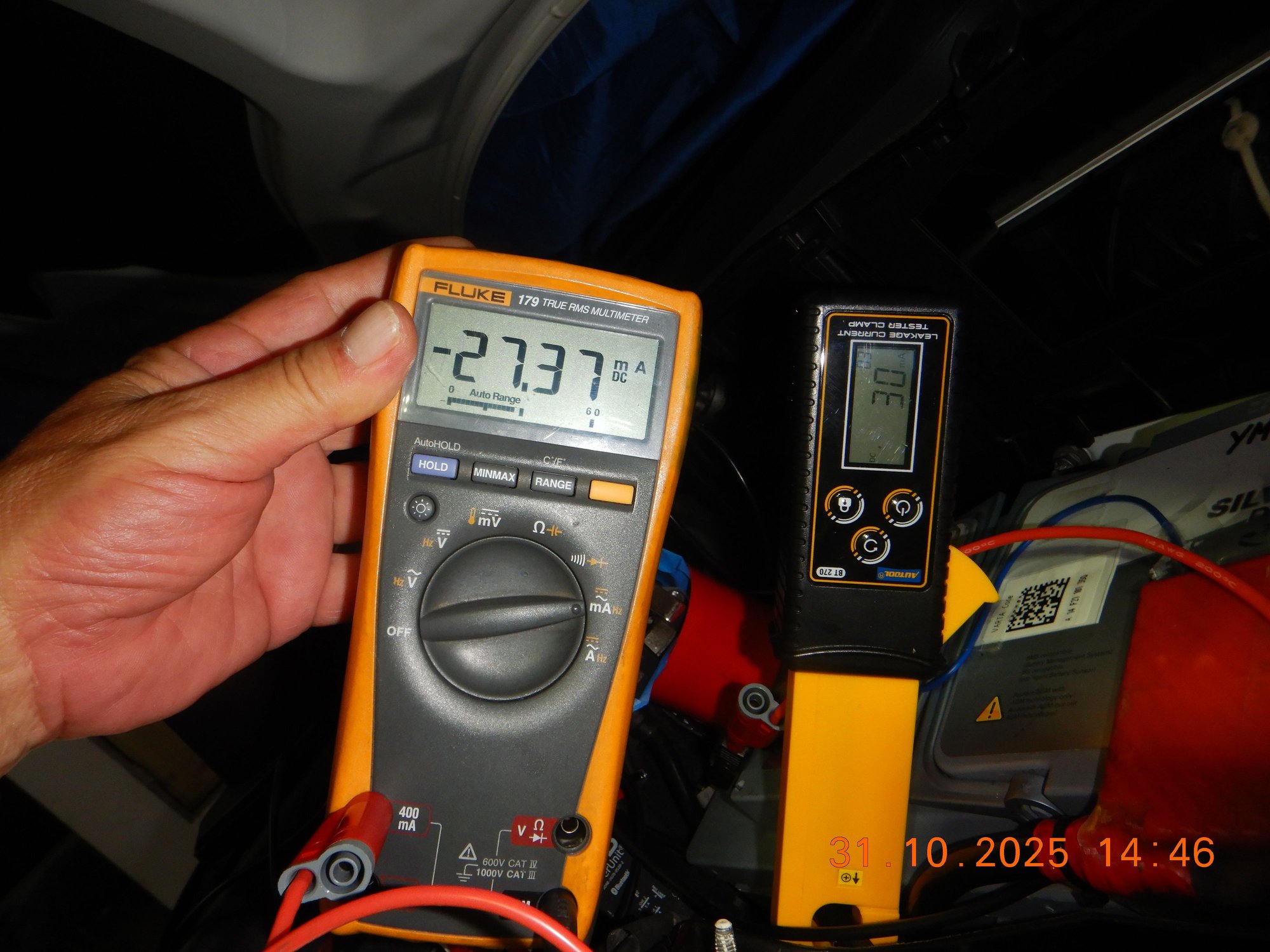

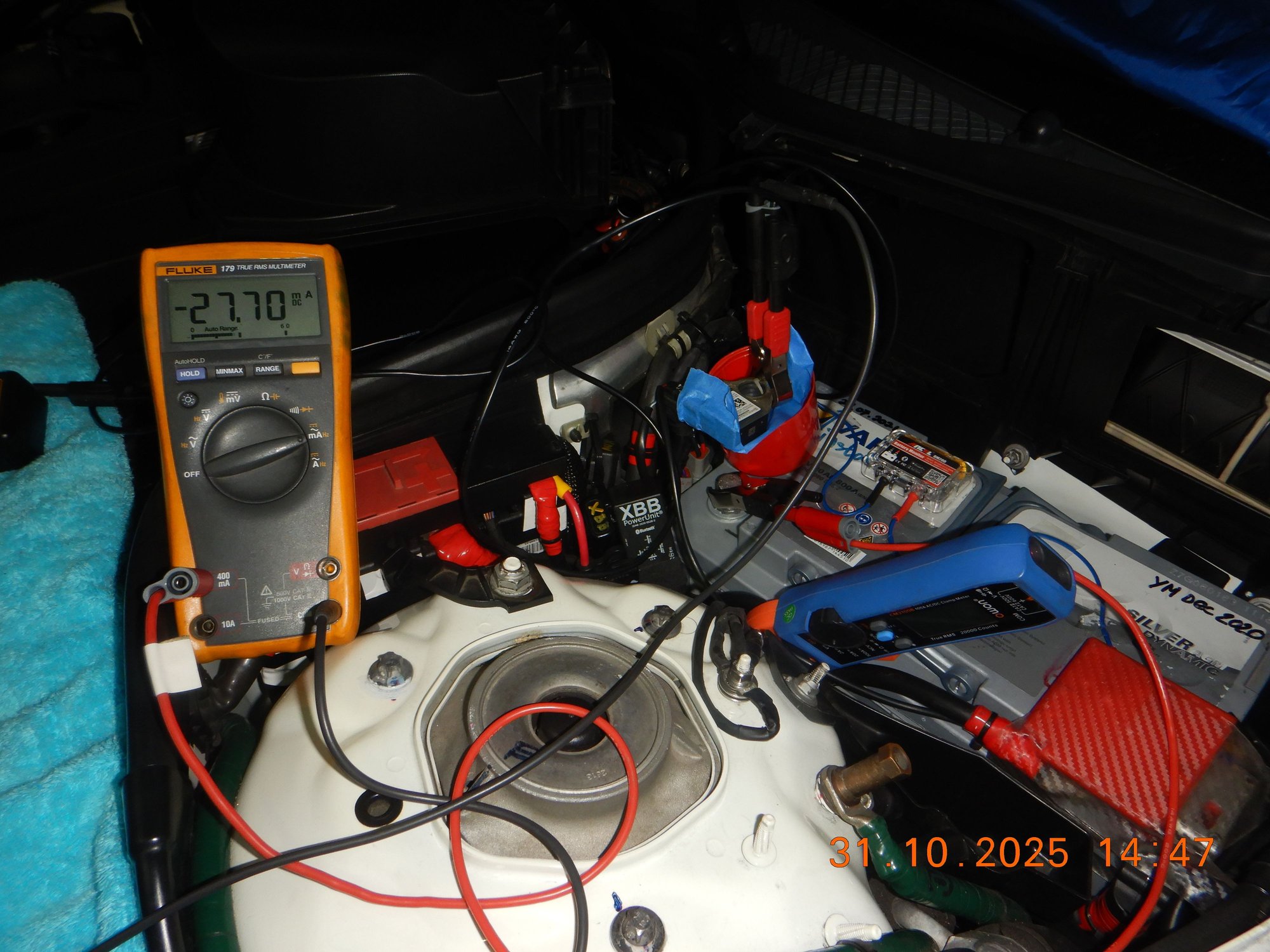

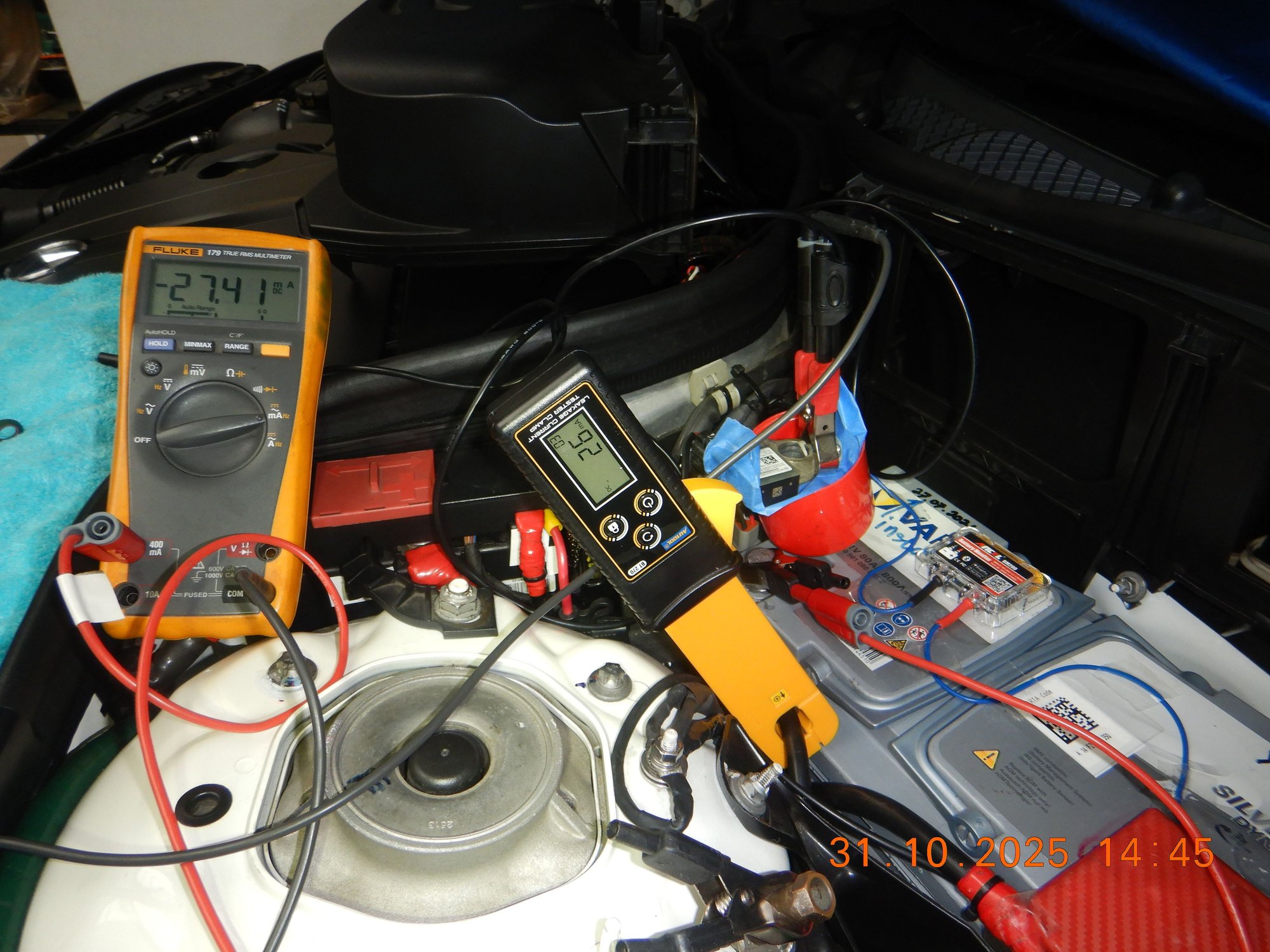

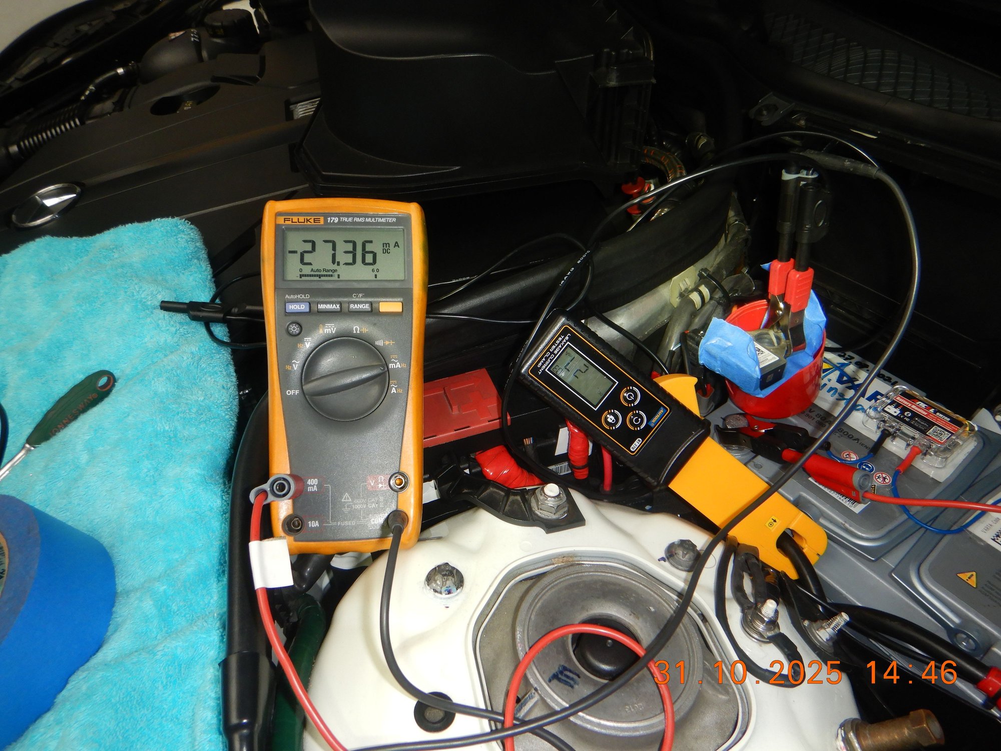

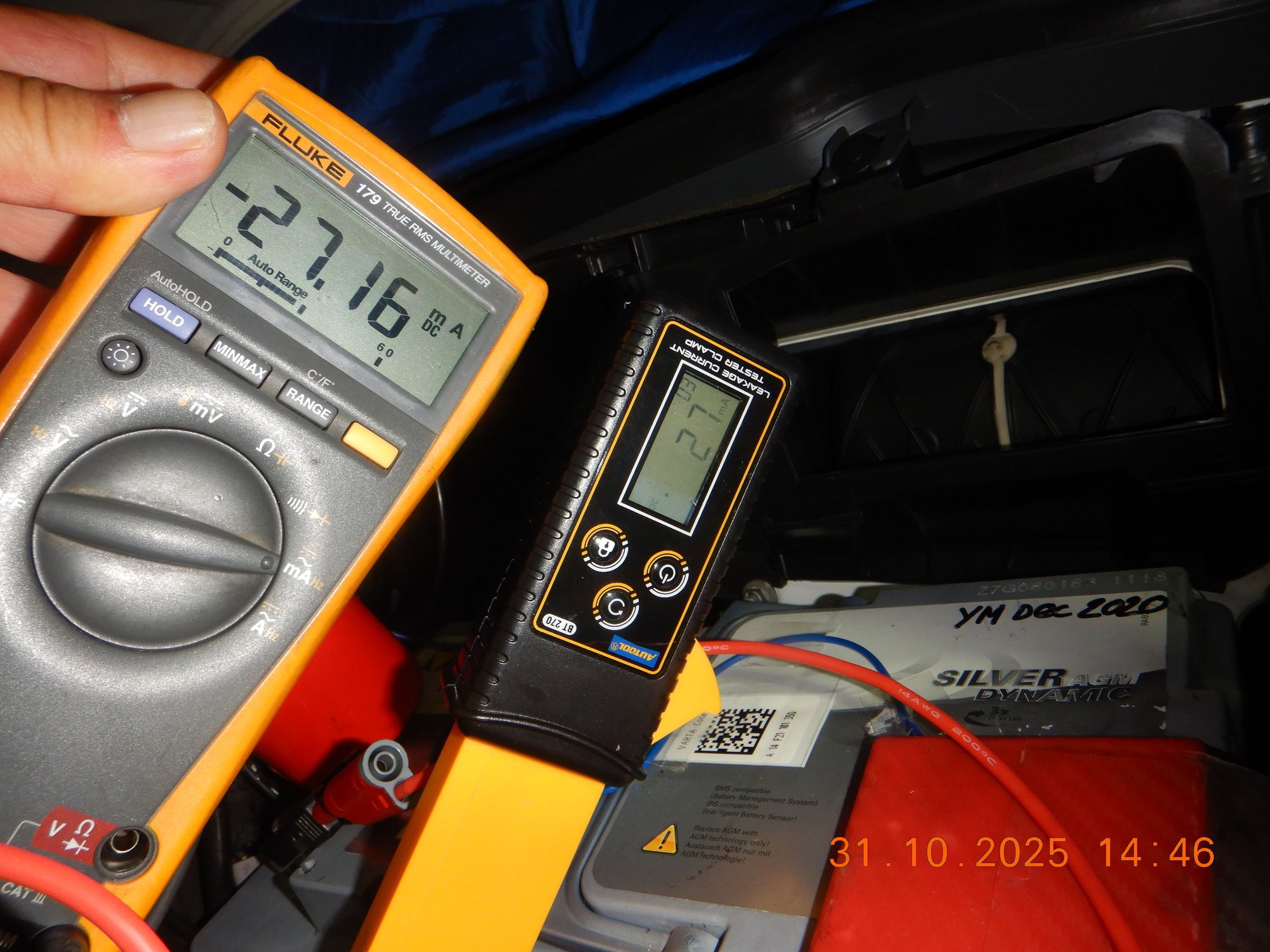

Real test on the car, at 26 to 27 milliamps load, car sleeping and 2 of my OBD2 device is still being powered via OBD.
Autool BT270 , leaning to the left side
Leaning a bit to the right
Leaning a lot to the right
Lean back to left again
