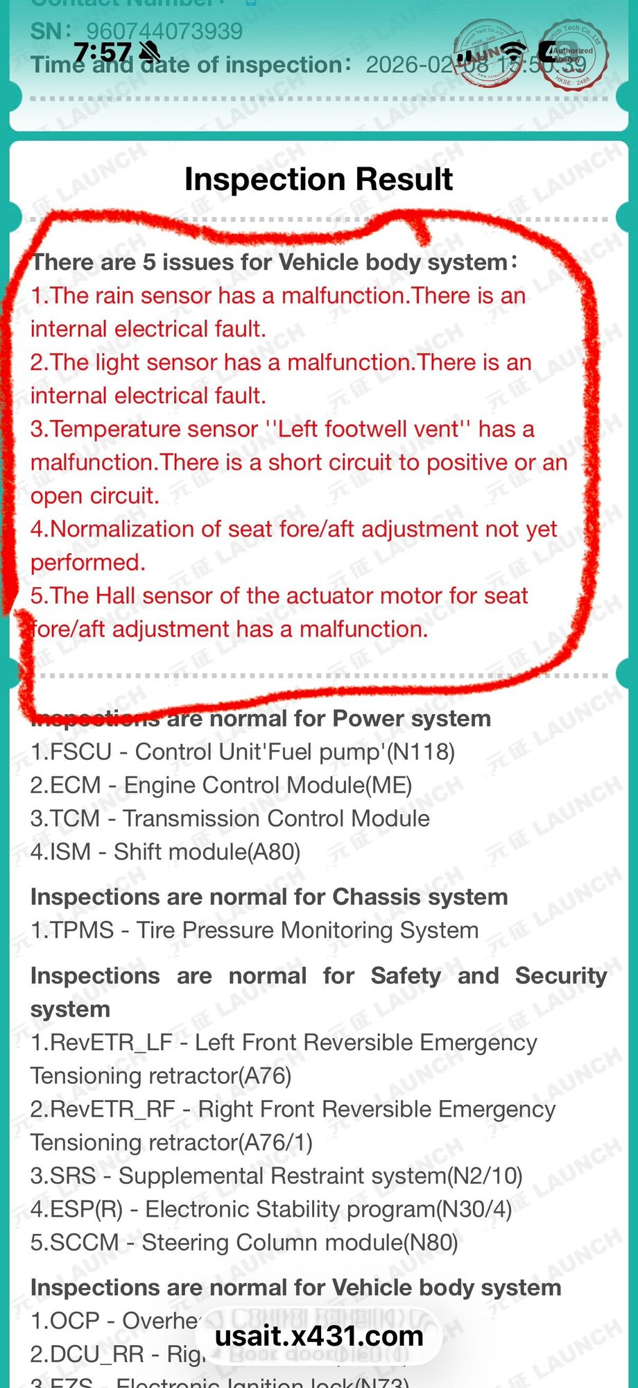

Ok the battery is fine but it did go bad last year and I replaced it. I cleared all the codes and interestingly the car immediately started running better. It ran ok before but just a little rough I thought and that little bit cleared up immediately when I cleared the codes. These five codes are all that are left see the attached pic. The core and aft of the seat codes are because the power seat stopped working and I had to replace a motor. It works now but it’s a little wonky and I think that’s why it still gives a code. The other codes are only the rain sensor, light sensor, temp sensor that I don’t think I really need to worry about. Thoughts?
Mike

yes, these faults are from low priority modules. The essentials are showing all good.
Mike
Normalization of the seat movement should be just to move seat all the way forward and aft holding the button for five seconds in each end.
This same normalization method works for all windows too….
The other three codes can be from just poor connection at the wire harness. So the first thing is to disconnect/reconnect each for a couple times. It could do wonders.
In my 2010 E550 I had to replace the light/rain sensor as my rain sensing wiper stopped working. It started working like the two sensing steps were time steps. New sensor fixed it and the same sensor is also some kind of a light sensor. Easy to replace and no coding needed.
