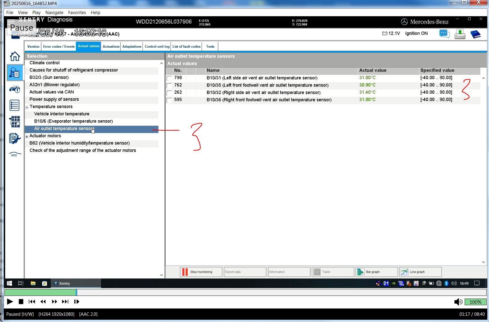

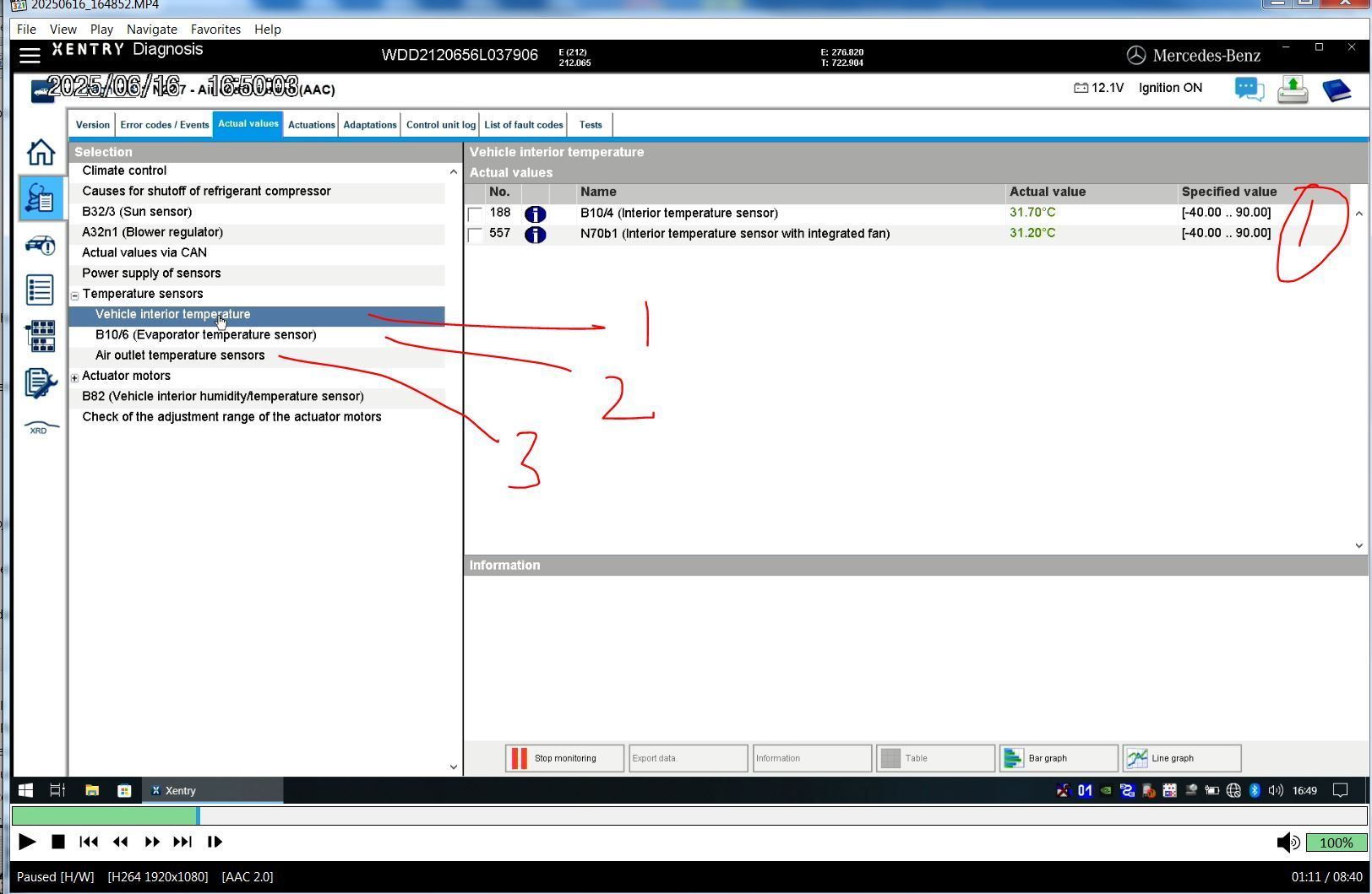

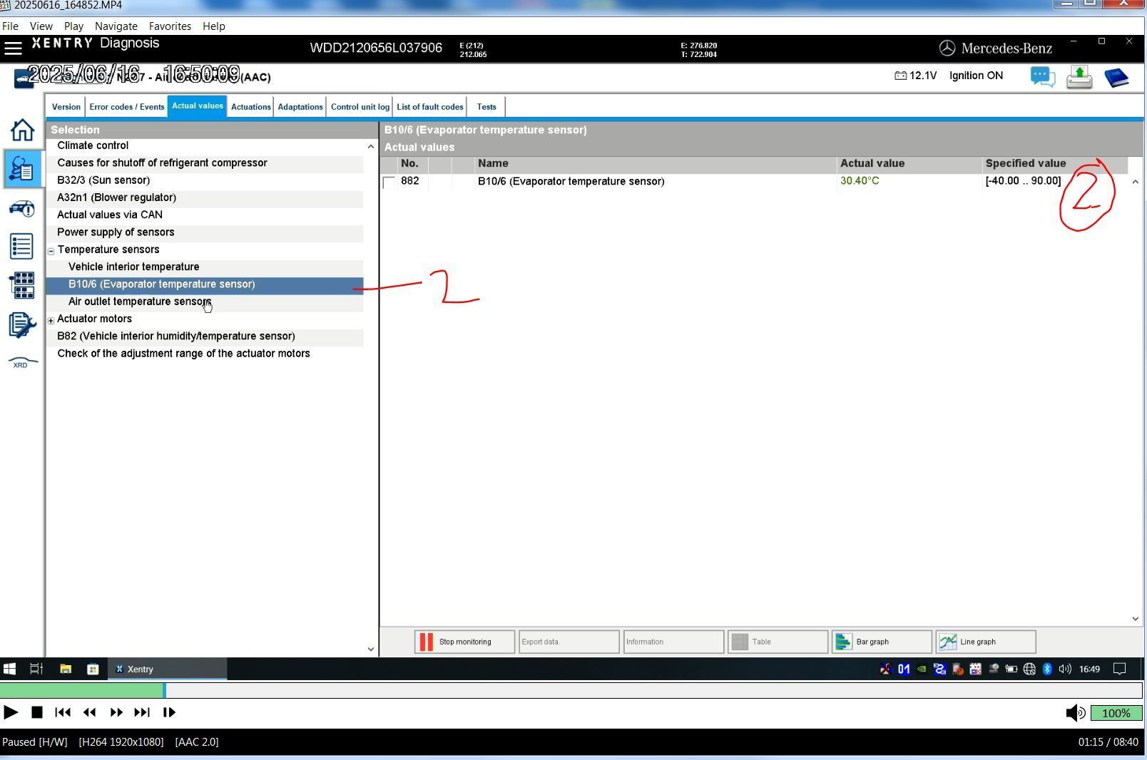

Use a decent scanner and check all temperature sensor readings on the car, see which one is OFF/BAD/DRIFTED
Start with ambient temperature and slowly see its decrease/cooler and use heater to make it warm too, see how the sensors response.
N70b1 Interior Temp Sensor with int.fan, is known to sometimes go bad or whacky data.
Its location is at the sunroof control.
Read here : https://mbworld.org/forums/e-class-w...ml#post8764892
If your N70b1 somehow went whacky and produce say cooler than 3 Celcius, I think you hot air blending flap will be open by HVAC computer...maybe.
Good luck with troubleshooting..........
