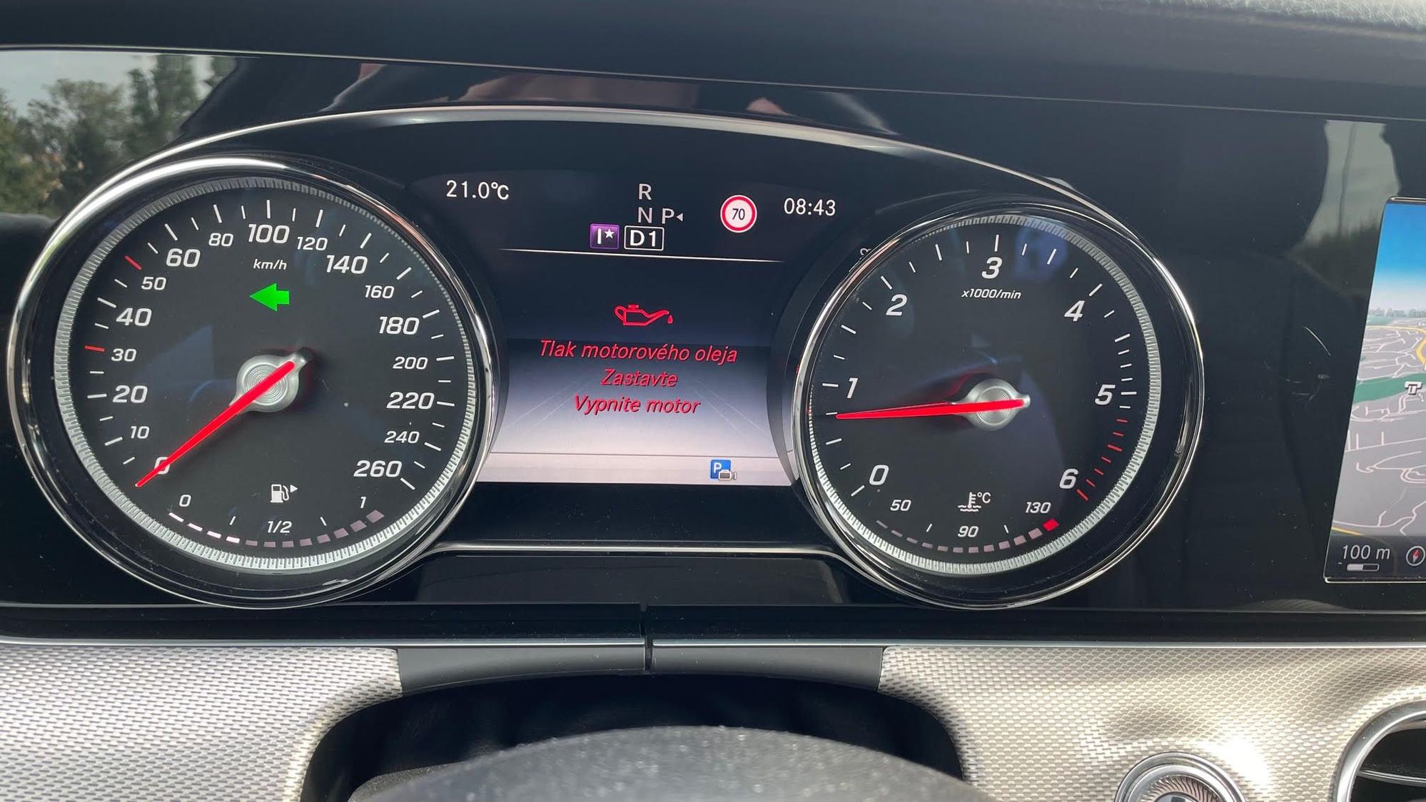

Hi all do u know where can be problem?..MB service have no idea, like they said..warning means: "Engine Oil Pressure Low. Stop Engine immediately"..did someone have same problem?. where to start? sensor oil pressure?..or just computer bug?..if oil have rly bad pressure i think i couldnt make few tousands of km...this warning show maybe few times a year and doesnt matter if engine is hot or cool..just show when it wants, but in MB said "we dont know" and let me go home with it. thx for any advice

ofc i did it at mb dealer..they didnt want to believe me till i show them this pic..cs when i came to mb..it didnt show already..my colleague had same problem...warning like my..nothing solved at mb service..no errors..
