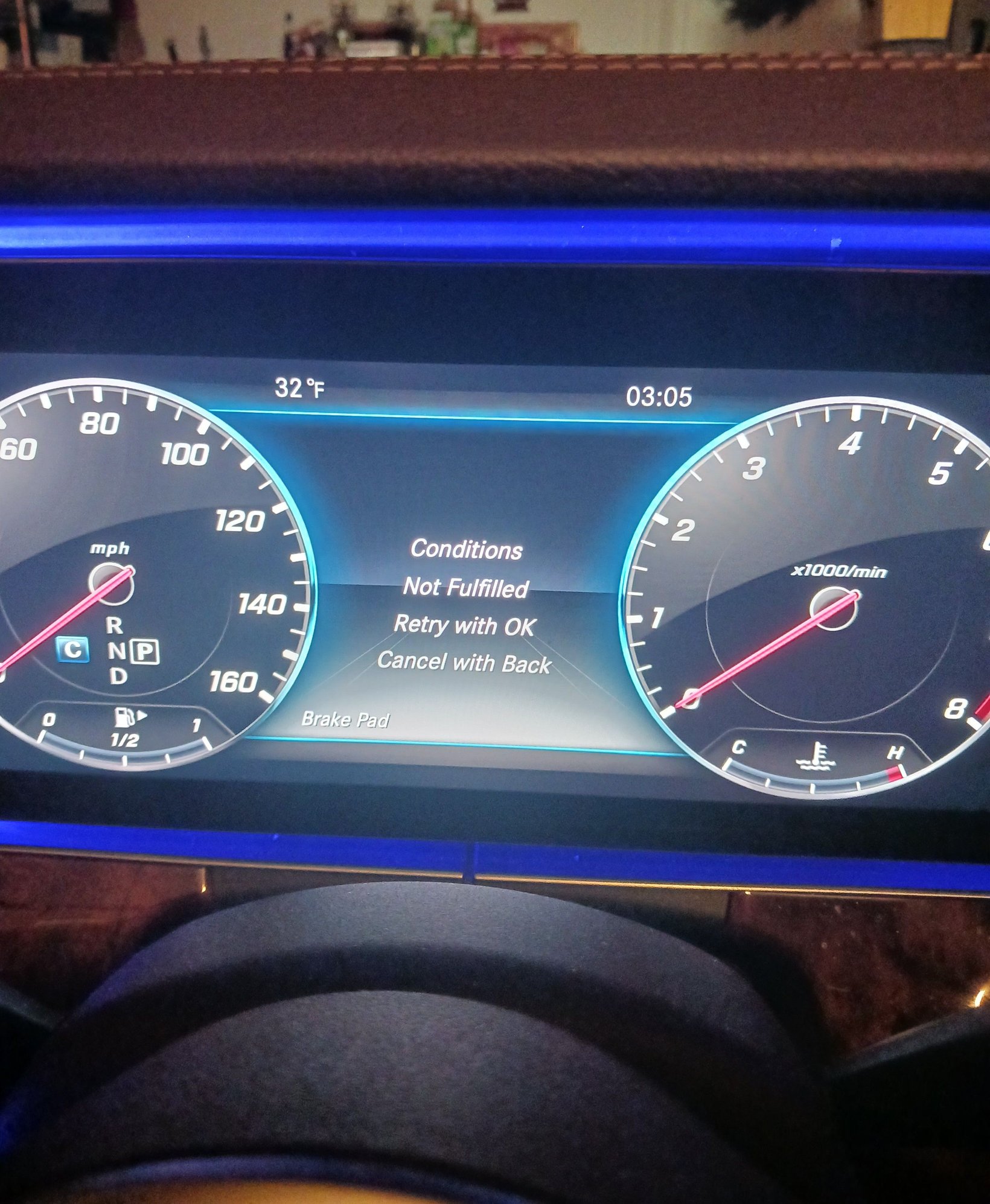

Thanks to the various posters' help on here and through trial and error I was finally able to get into the Workshop mode. Taking baby steps lol plus limited time because of my job. Anyhow got into Workshop other day but this message came up. Just need to get to the Fitting position mode so i can get the rear brakes finally done. Thanks guys!!!
Got stuck on this screen, im trying to get into the
Got stuck on this screen, im trying to get into the "Fitting position" screen so i can start with the rear brakes. This screen is in the "Brake Replacement" mode menu.
Old Feb 17, 2025 | 07:29 PM
W205C43PFL's Avatar
Posts: 32,511
Likes: 6,348
nice, sounds like you made progress, when this message appears, it is usually the trunk not closed, the doors not closed, key not in vehicle and/or parking brake not (released?)

It seems like i was pressing the wrong buttons on the steering wheel. What finally worked for me to get into Workshop mode was too hold down the "back" button for a few seconds and then press the middle "ok" button for a second. Worked for me to get in to Workshop.
Old Feb 17, 2025 | 07:59 PM
AZCardinals's Avatar
Joined: Feb 2025
Posts: 9
From: New Jersey
ok, thanks, I will check

Yes it did, thanks guys for all the advice, I was able to finally get into the Fitting Position screen in Workshop mode. I had the parking brake on like you mentioned it could be and thats what gave me the error message. But now it looks like I can finally finish the rear brakes. Will do.it in a day or two. Thamks again and if any issue comes up Im sure I will bother you guys again lol
