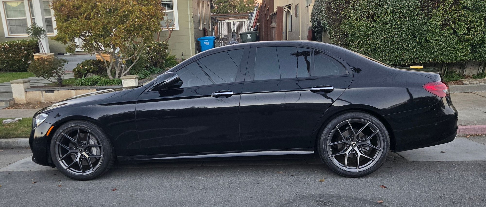

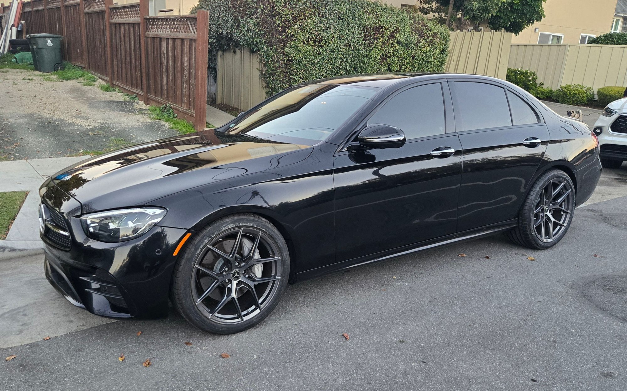

Just got them mounted with higher sidewalls 245/40/20 & 285/35/20.
Offset is key.

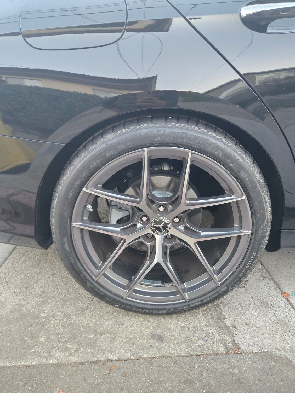

Avantgarde 580R
Front 20 x 9. 35mm Bridgestone Turanza
Rear 20 x 10.5 41mm Bridgestone Turanza Runflat
Rims are much lighter than stocks since they weigh 25lbs Fronts and 27lbs Rear.

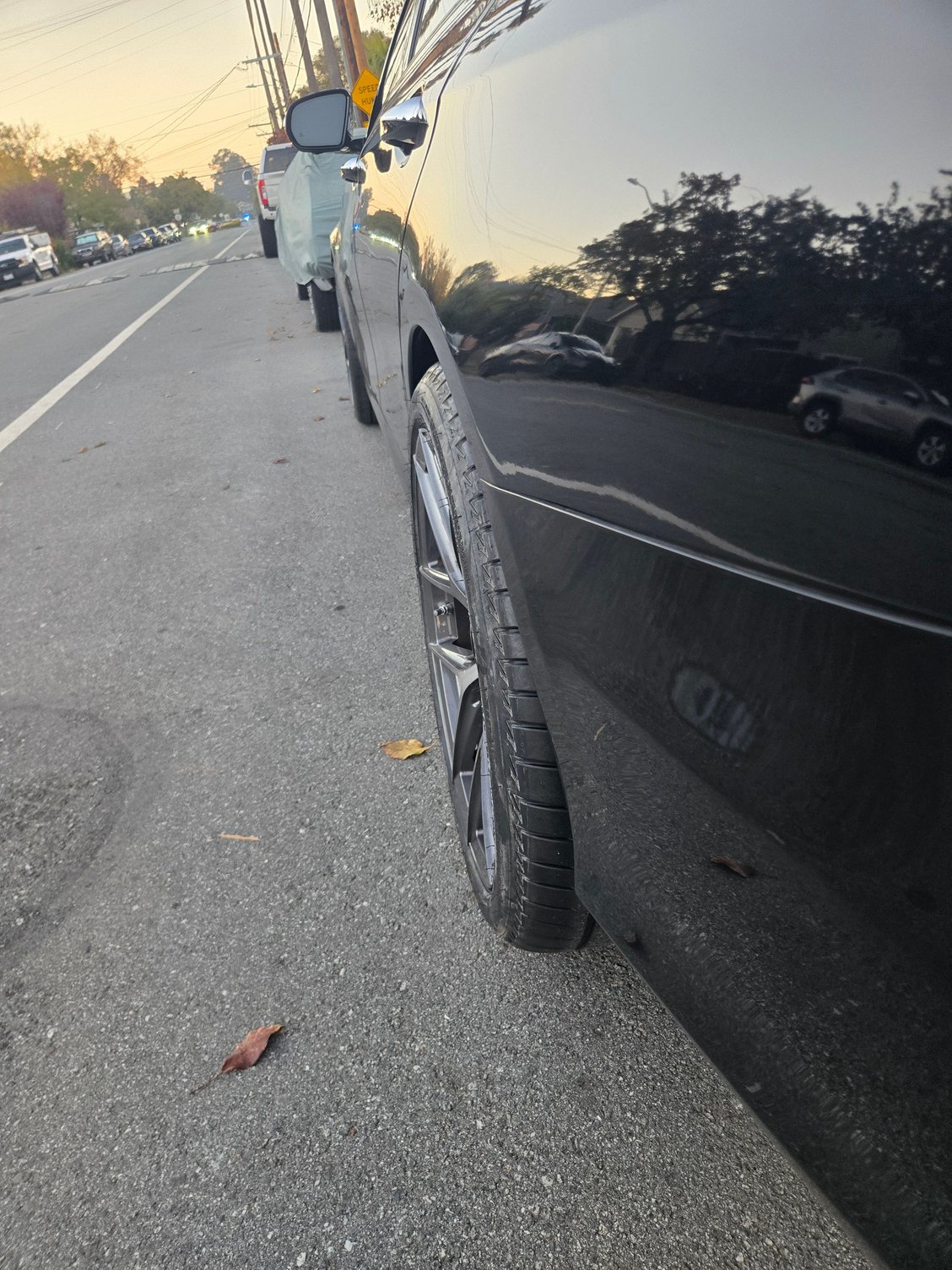

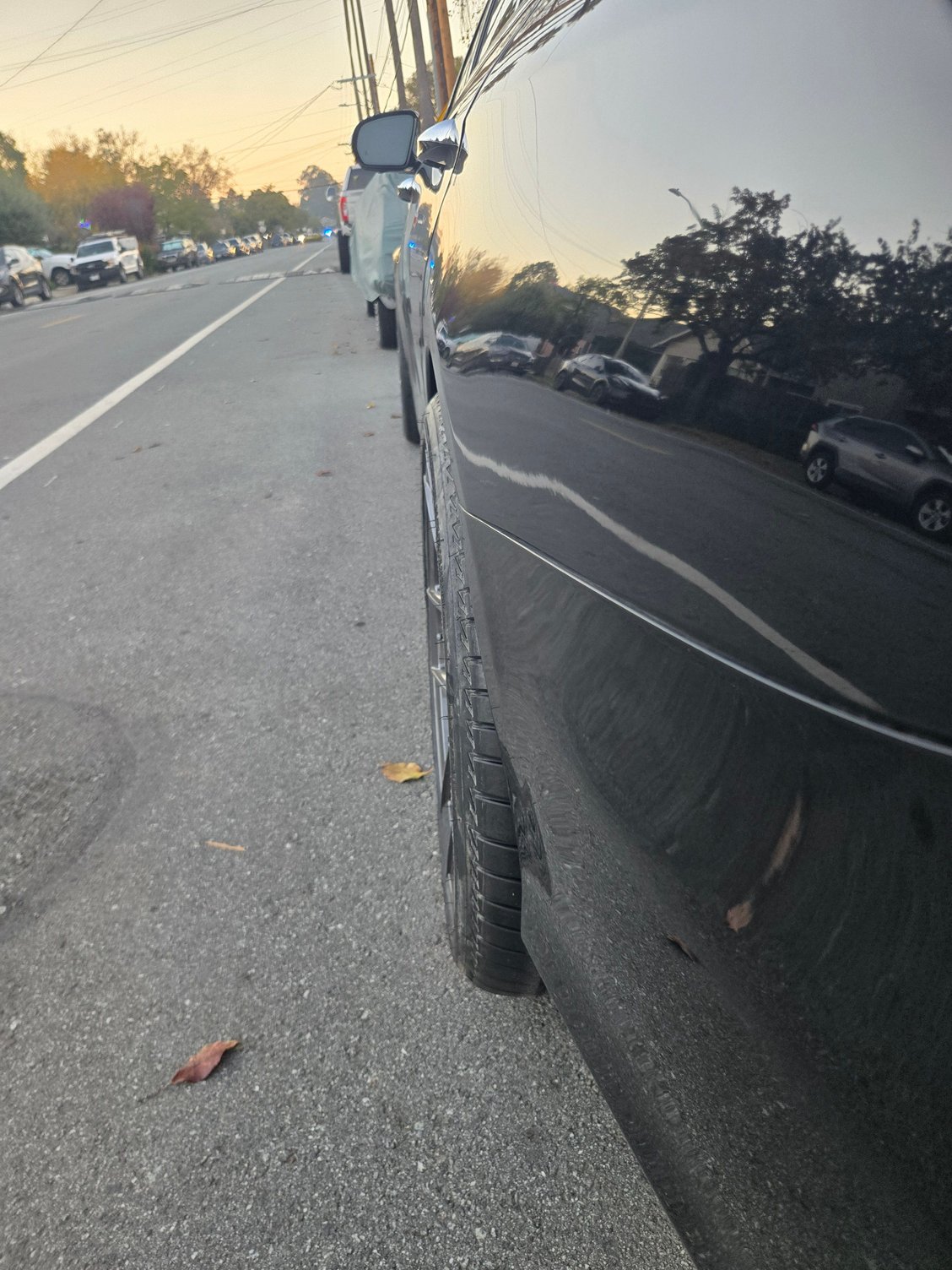

Over speed bumps and high incline driveway a little scuff depending on speed you are going from the front.
No rubbing on full steering wheel lock turned.
Fills up the wheel well.
