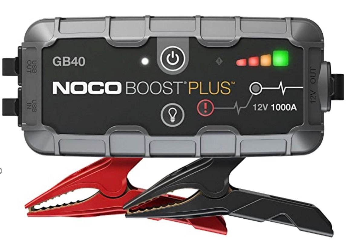

Though not quite the same beast, the Prius Hybrid suffers the same threat from the 12V battery. If it goes flat, the car will not Power ON. Since the 12V in Hybrid/EV does not have to crank an ICE as in other cars, manufacturers put in low capacity 12V batteries, just enough to power up some electronics and bring the big battery online.
After being stranded by a flat 12V in my Prius, I learned of this NOCO backup battery and it has already saved me one additional time. After a simple hookup to the 12V in the car, I was back on the road in a matter of seconds.
I know for sure you never want to use traditional jumper cables to revive a Hybrid/EV from another conventional vehicle. But these backup packs are super safe and won't allow reversed connections or other anomalies to fry your electronics.
