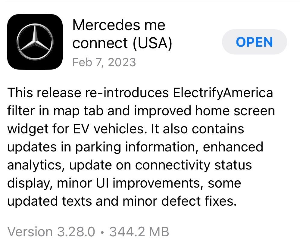

There was an update last week, which changed it to 12V battery and changed the explanation. Looks like you are running an older version. Some new features specifically for EVs.
How do I get this new release? App Store?
Yep, it's in the App Store. Go to Updates and pull down to check for new updates or wait until it installs on its own.
I think I got it. It says it updated just a few minutes ago.
I didn’t get a warning message this morning. I think that the updated software suggested above fixed it.
