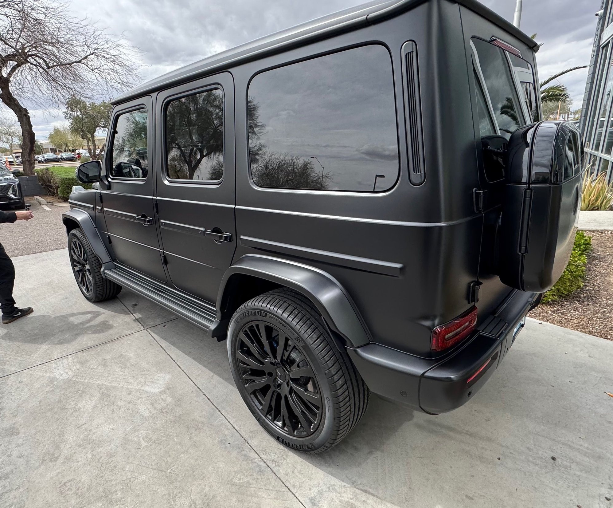

I recently removed the side molding from my G580 since I was never a big fan of it. My truck has the Night Package along with all the standard G580 features. Added 295/40R22's After getting the vehicle PPF’d, I made a few discoveries—most importantly, the truck looks incredible without the side moldings! Even after installing the black AMG G63 kit I purchased to replace the factory trim, I still love the clean matte look with a side molding delete.
Here are some photos showing the evolution of the build. I also swapped out the front-end star and badges with matte or glossy black replacements for a more cohesive aesthetic.

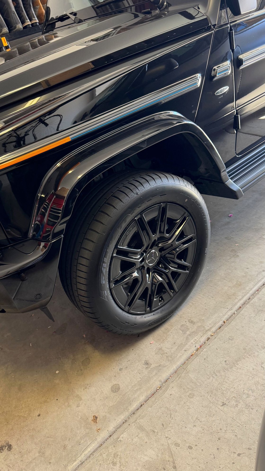

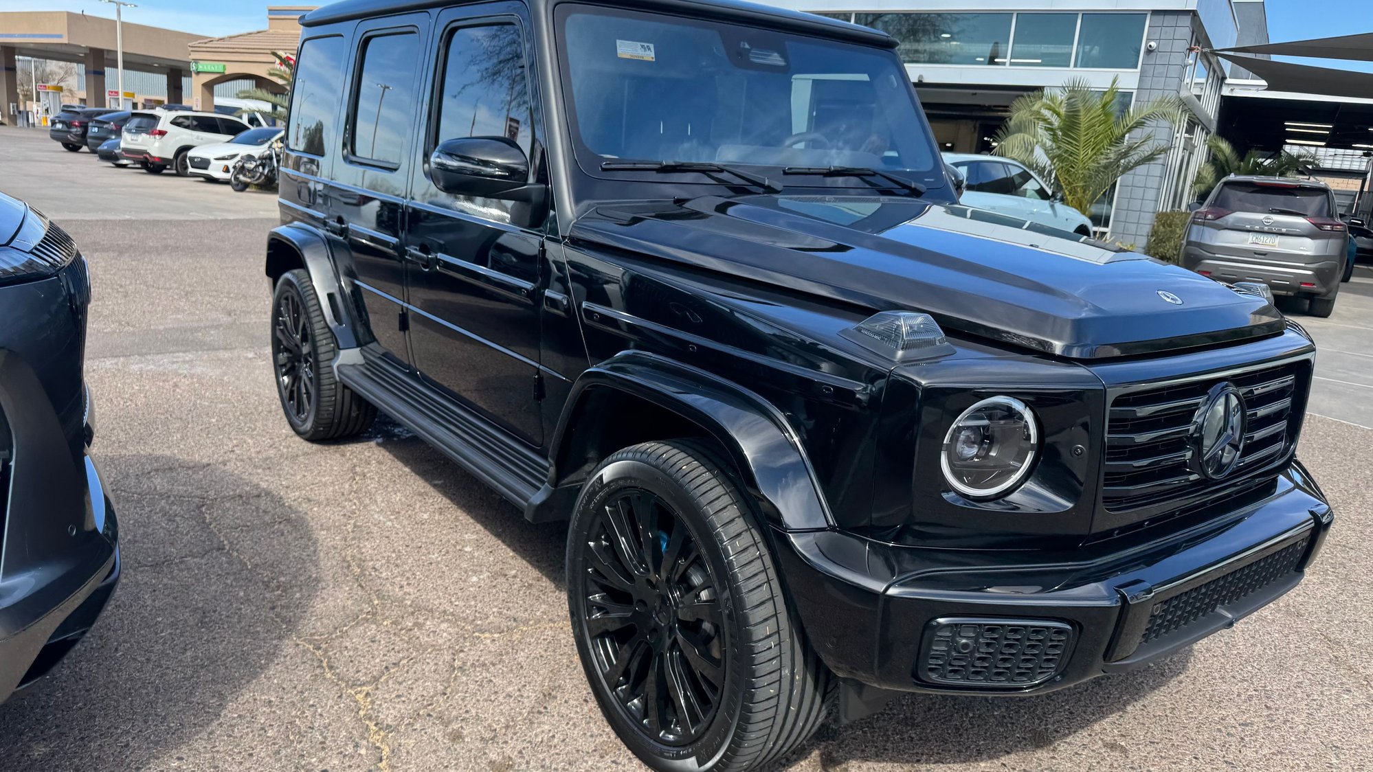

Factory Wheels and Molding

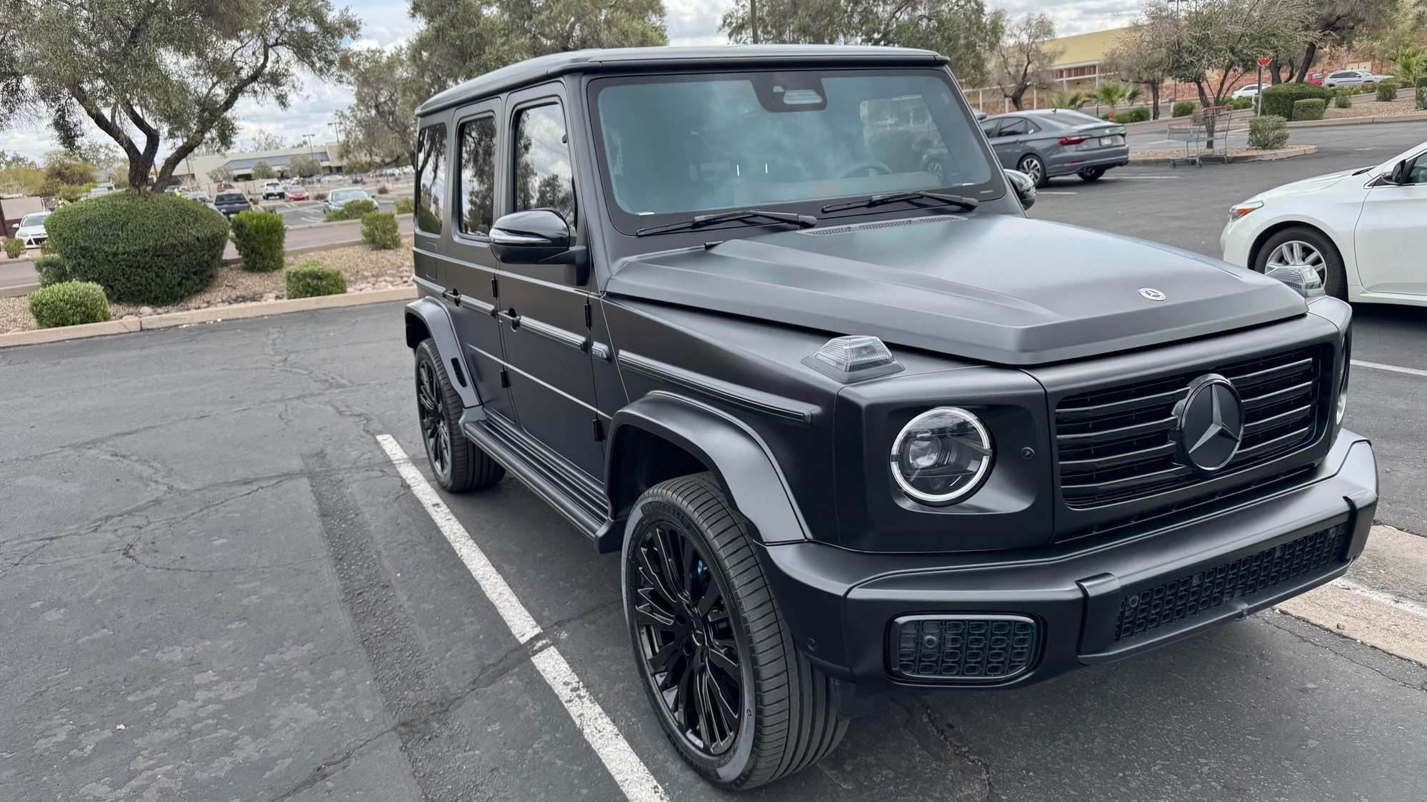

Molding removed.
Molding removed.
No Molding PPF
No Molding PPF
New AMG Molding
New AMG Molding

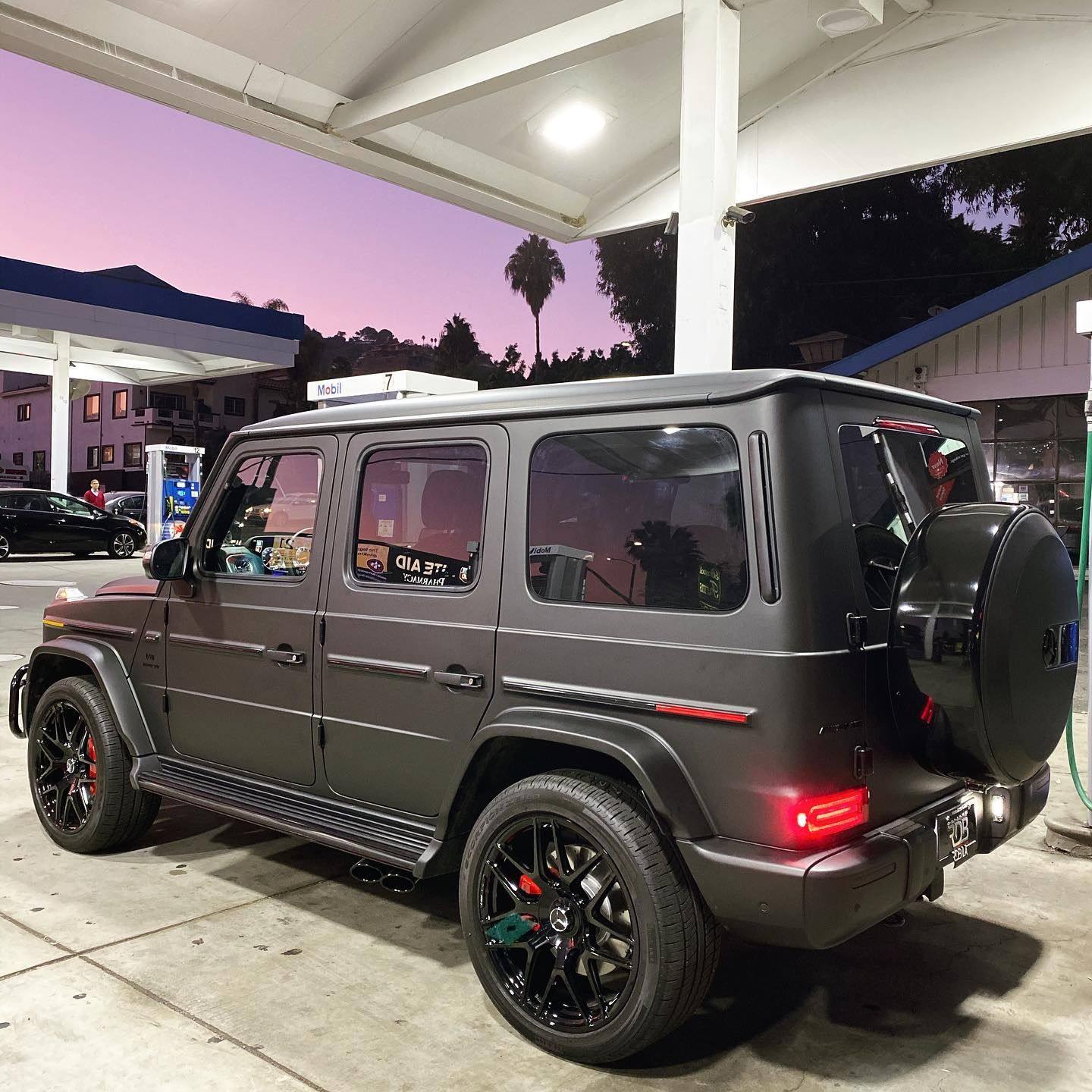

Here are the mods to my G580, in case anyone's looking to replicate the G63 look or do something similar.
🔧 Step 1: Decide on Your Style
The first choice is whether you want to go with the standard G63 look (with reflectors) or a cleaner, "blacked-out" version.
  • Standard G63s have orange and red reflectors at the corners.
  • If you’re going for the Designo Night Black Magno G63 look, the side moldings are all black with no reflectors (aka "reflector delete").
🧩 Understanding the Parts
The side moldings are made up of two components:
  1. Protective Strip – Matte black, non-glossy outer trim that attaches directly to the vehicle.
  2. Ornamental Molding – Glossy black trim that fits inside the protective strip. Counterintuitive, but this is the inner piece.
Pricing:
  • 8 Protective Strips (OEM): ~$400
  • 8 Ornamental Moldings (OEM): ~$2400
  • 3M Double-Sided Tape (Optional): ~$7
  • OEM Reflectors (Set of 4): ~$40
  • Black Reflectors (Amazon - iJDMTOY): ~$66
  • Aftermarket Protective Strip (eBay): ~$150
  • Aftermarket Ornamental Molding (eBay): ~$120
🔄 Configuration Options
Here are the three main setups you can go with:
1. All Black, No Reflectors (My Setup)
  • 8x Protective Strip (OEM)
  • 8x Ornamental Molding (6 OEM, 2 aftermarket to cover reflector gaps)
  • 3M Tape (if needed)
  • Note: OEM ornamental molding leaves a 6-inch gap for reflectors, so you'll need aftermarket trim to cover that if you delete them like I did.
2. All Black with OEM Reflectors
  • 8x Ornamental Molding (OEM)
  • 4x OEM Reflectors
3. All Black with Blacked-Out Reflectors
  • 4x Smoked Reflectors (Amazon - iJDMTOY)
💡 Tips & Lessons Learned
  • Be cautious when buying parts from eBay or Amazon. Many aftermarket moldings are for older G-Classes and won’t fit. The inner ornamental molding for 2024/25 models is 11mm wide, whereas older models use 14mm — they are not interchangeable.
  • I tested OEM and non-OEM parts, bought multiple sets, and did all the removal and reinstallation myself. ( this is a totally doable DIY )
  • My final setup: OEM Protective Strips, reflector delete, 6 OEM + 2 aftermarket Ornamental Moldings.
I documented everything and have photos of all the parts and install process. Happy to share details, recommendations, or pics if you're interested.
Feel free to PM me if you want to chat further or need help with your build.
Hope this helps someone out!
