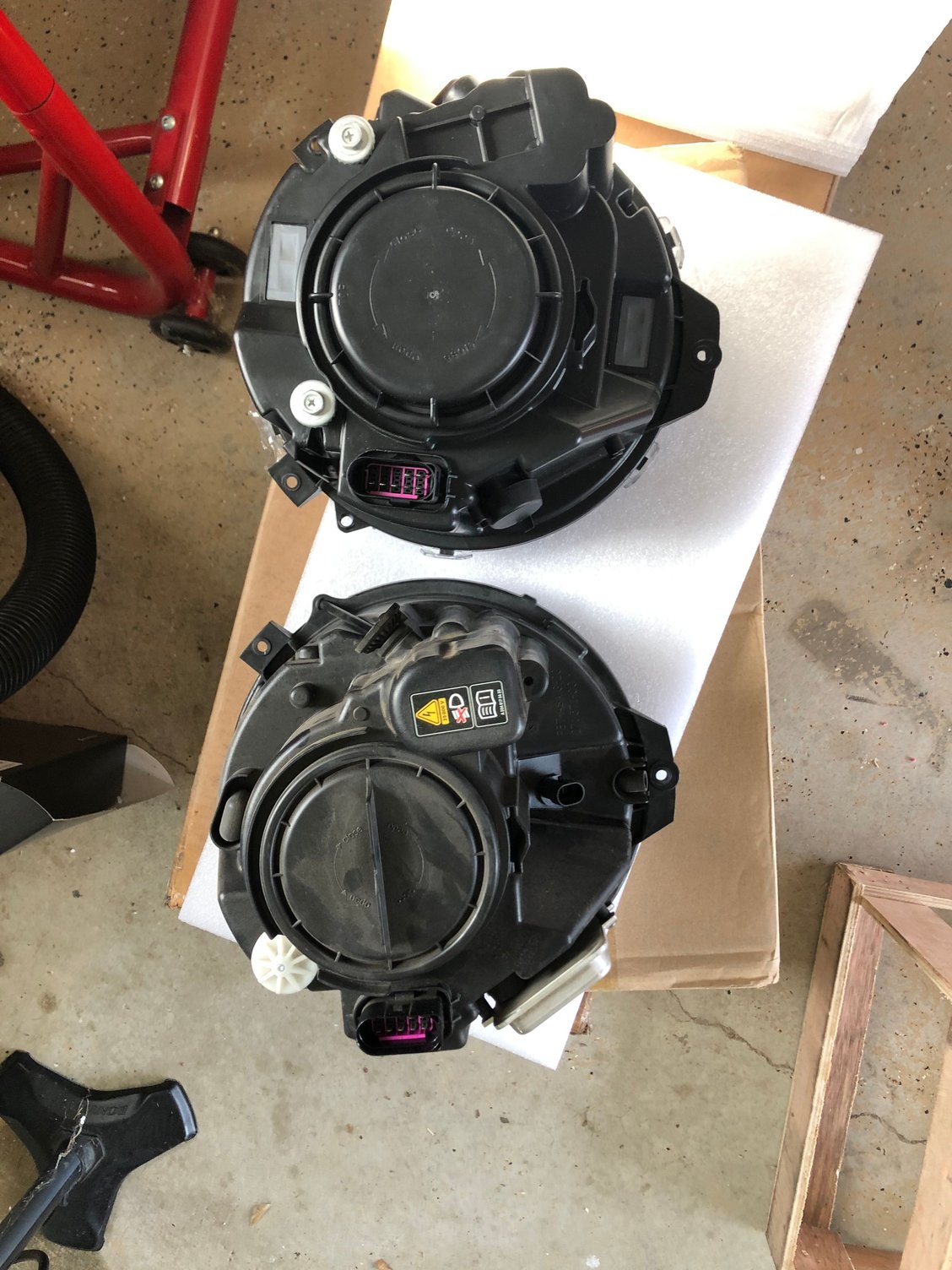

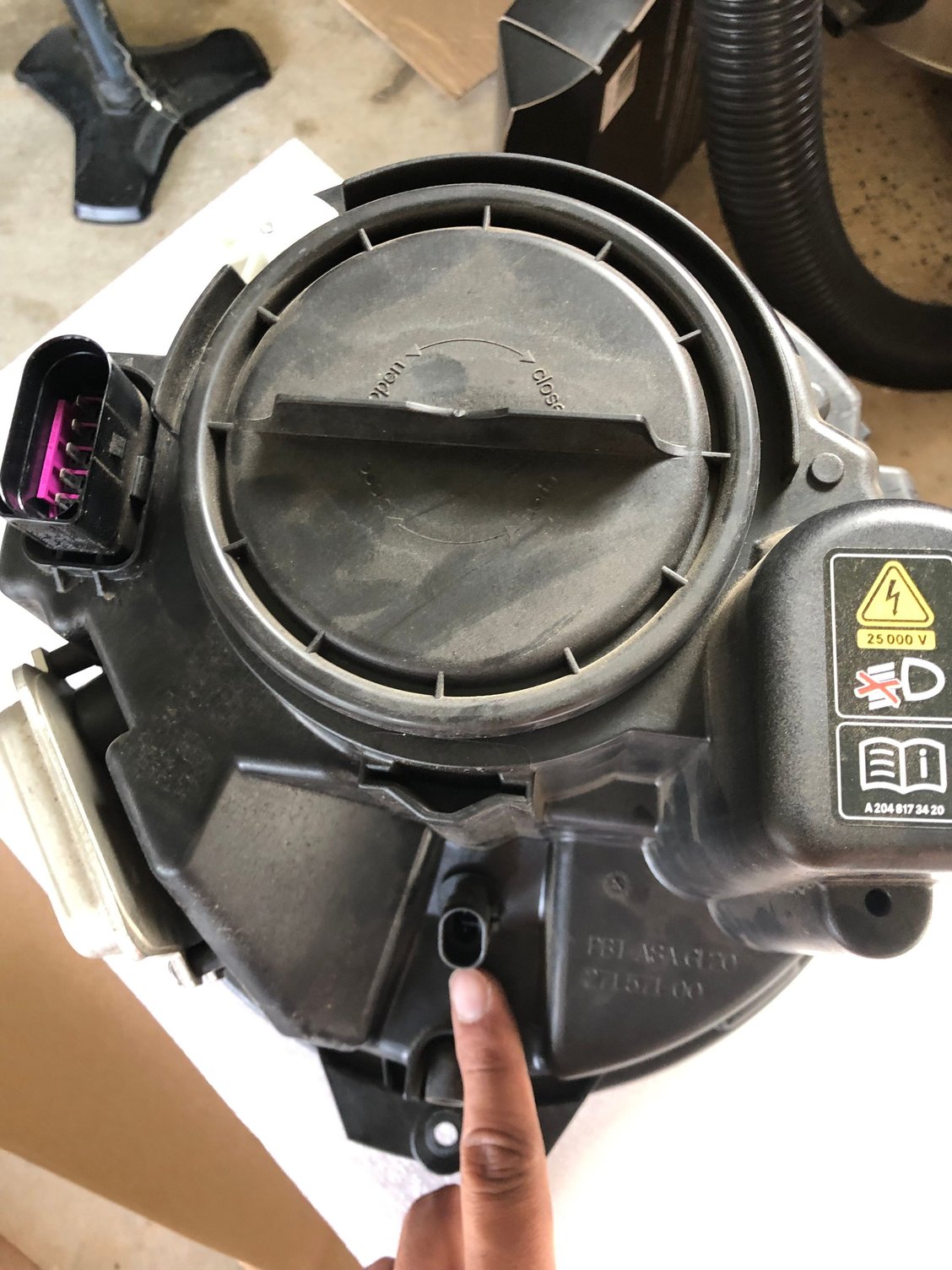

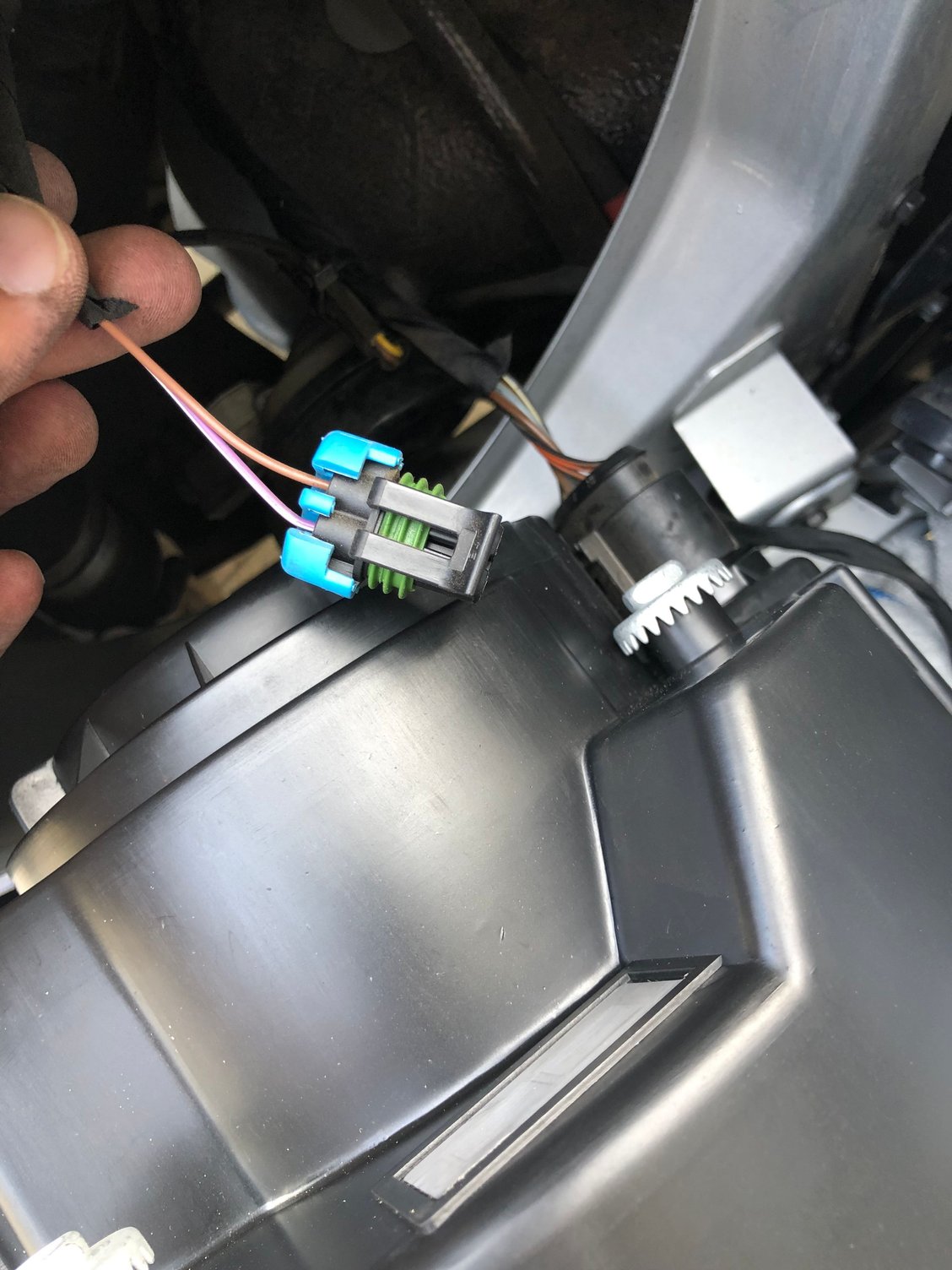

I’m swapping my stock headlights for led ones. Simple enough swap except it seems there are two connectors for the stock ones and only one for the led ones. Leaving the bottom connector(pictures) still seems to allow function, but the new led headlights supposed to have turn signals too. What does this bottom connector do? And what should I use it for now? New headlight functions for regular beam, daytime running lights and high beam(so exactly the same as stock except the new led turn function doesn’t work).
Stock below, new led above
The unused connector
This is where the unused connector used to go

Question: I assume you're replacing HID headlights, I see the ballast at the bottom of the old lights.
Maybe the extra connector on the old light to power the HID ballasts or the self leveling features.
To get the turning functionality, my guess is one of the pins in the purple harness has an extra pin (compared to the old light) for the turning functionality. You would probably have to tap into the turn signals to enable that.

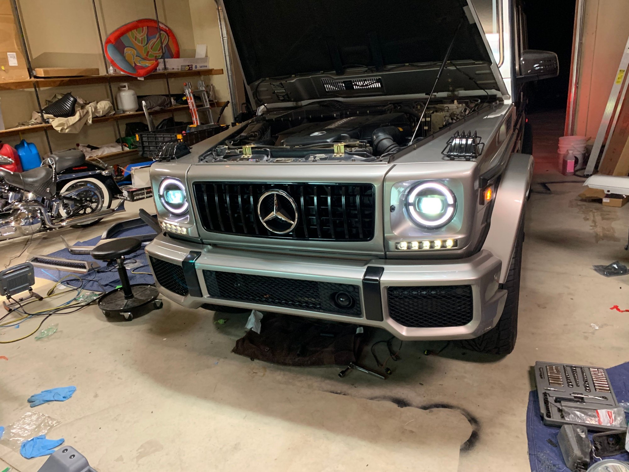

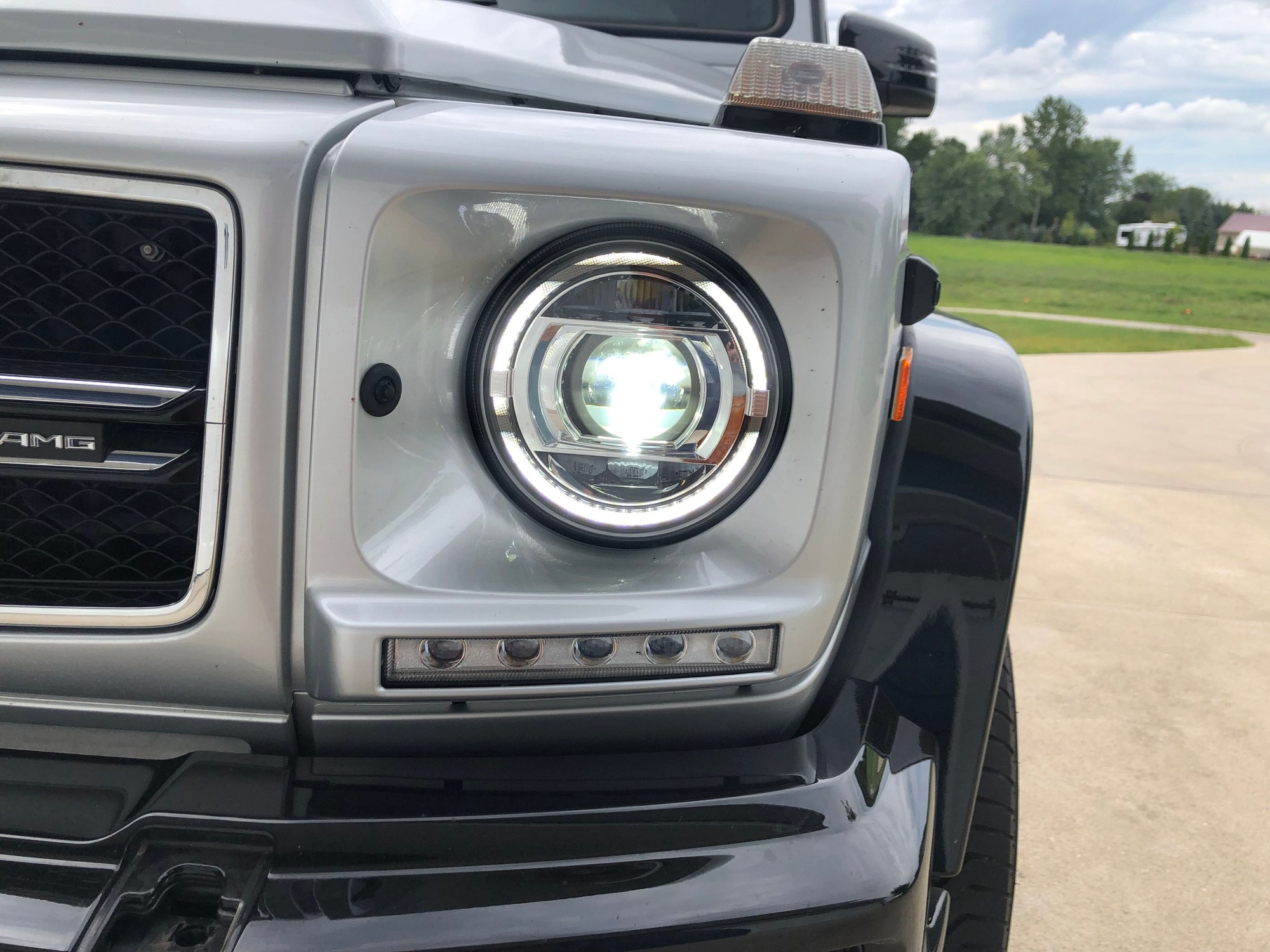

Lit up. The outside hall lights works as DRL
Turned off
Curious to see what the LED lights look like, mind sharing the front side?
Ah that leveling makes sense and yea I’m swapping from HIDs. I left them disconnected and taped to other wires just to keep it in place. Taking photos of LEDs show flickering but it’s not really there. The outside ring is fully lit.

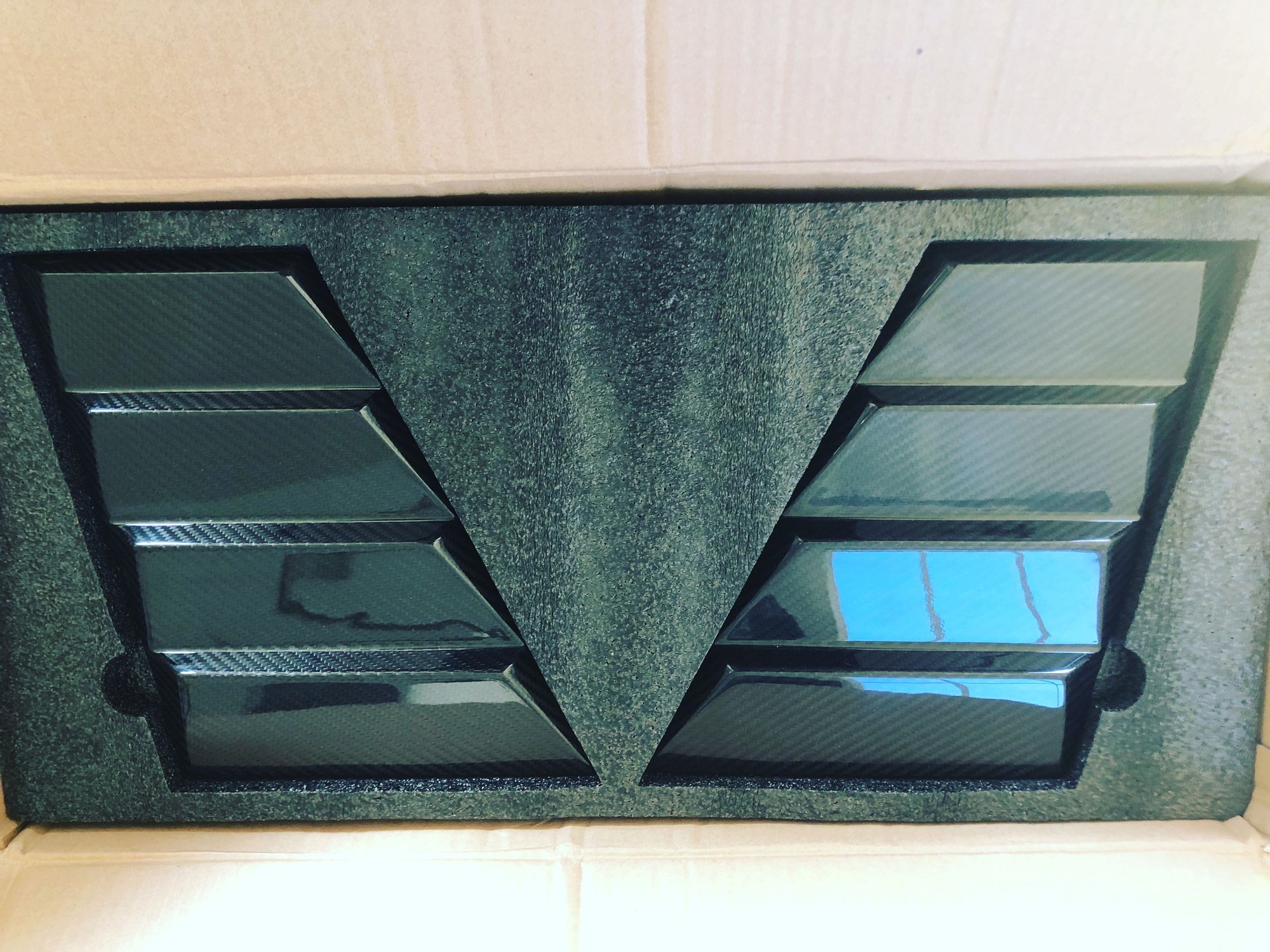

Got these fender “vents” too and they were very well packed and the weave was perfect. Zero complaints. They also instructed me on how to connect the turn signal on the new headlights(just have to tap the positive wire on the turn signals to a yellow wire inside the headlights)

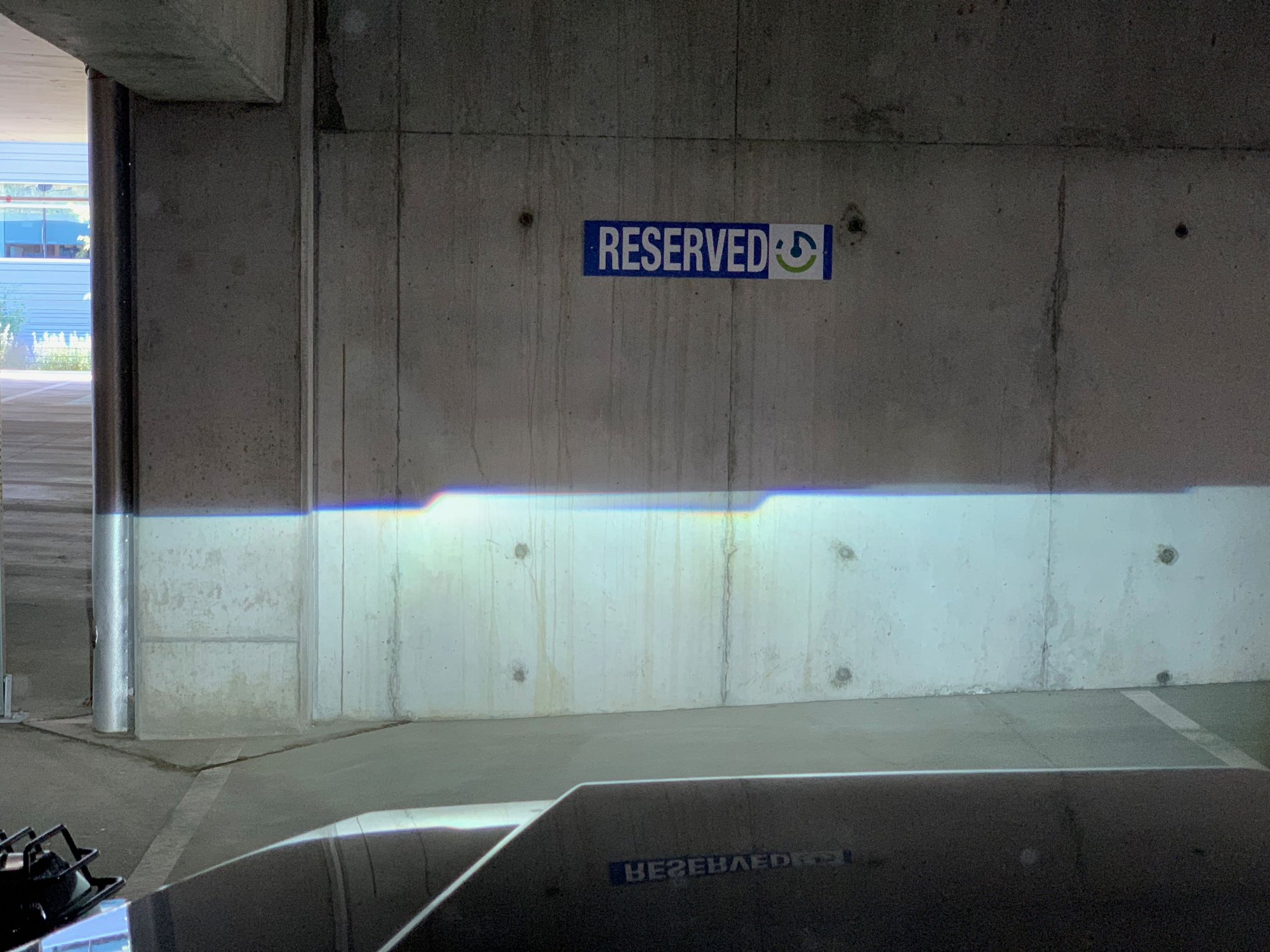

Here's a pic of the cutoff...
Old Aug 30, 2019 | 10:57 AM
horse86's Avatar
Joined: Apr 2012
Posts: 179
Likes: 49
Range Rover, M5
Looks to be a very nice cutoff and even output. The stock HID might put out a bit more brightness though...not sure.
Definitely possible. I'm using the Morimoto 35W HID kit with it - I've used them on a few other cars so they've been good to me.
