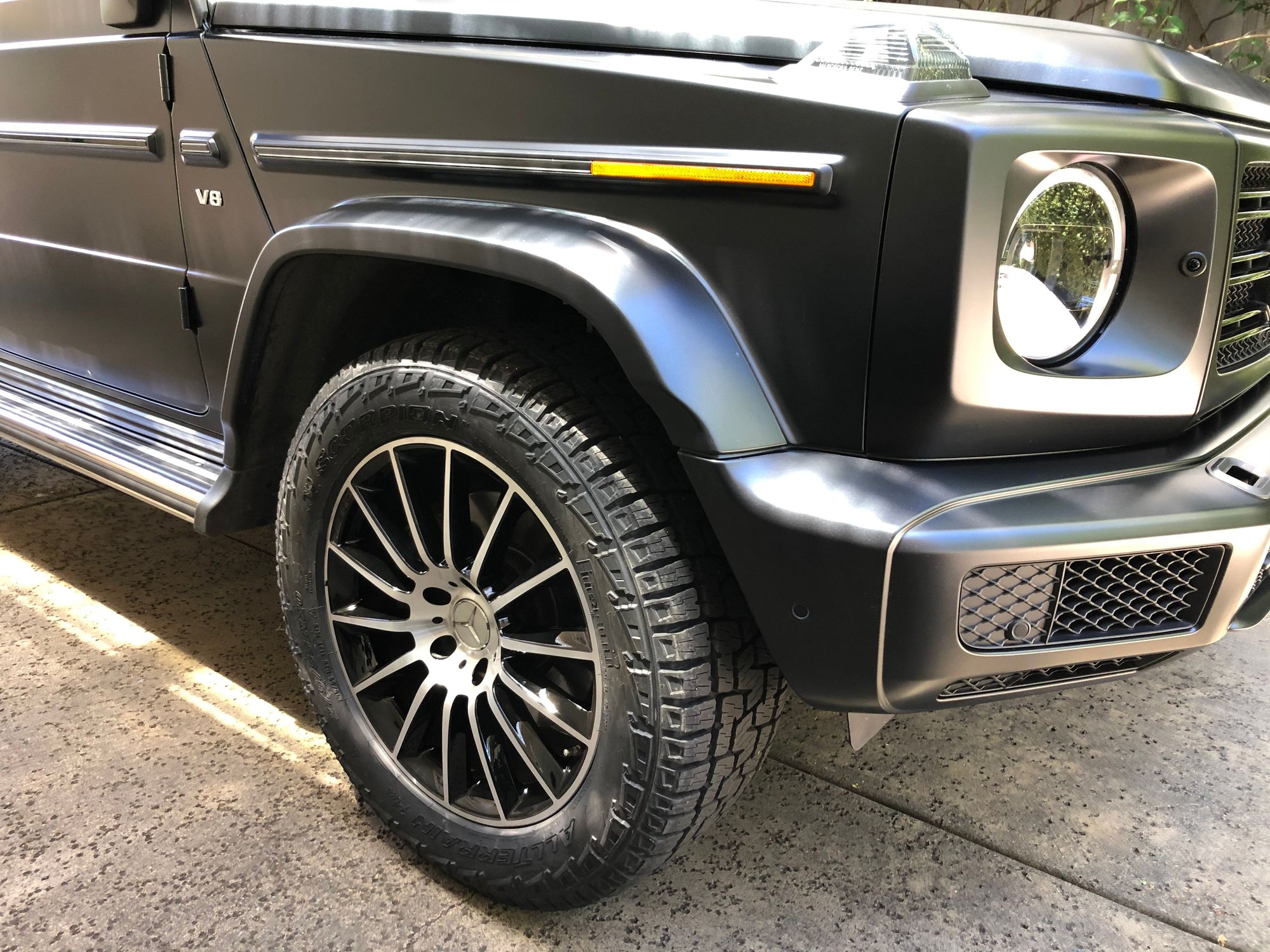

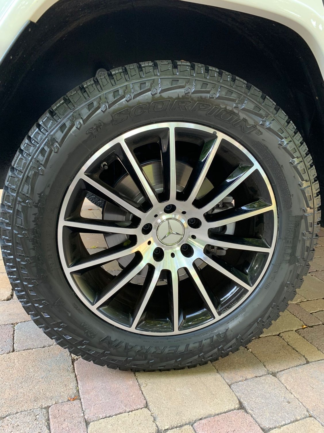

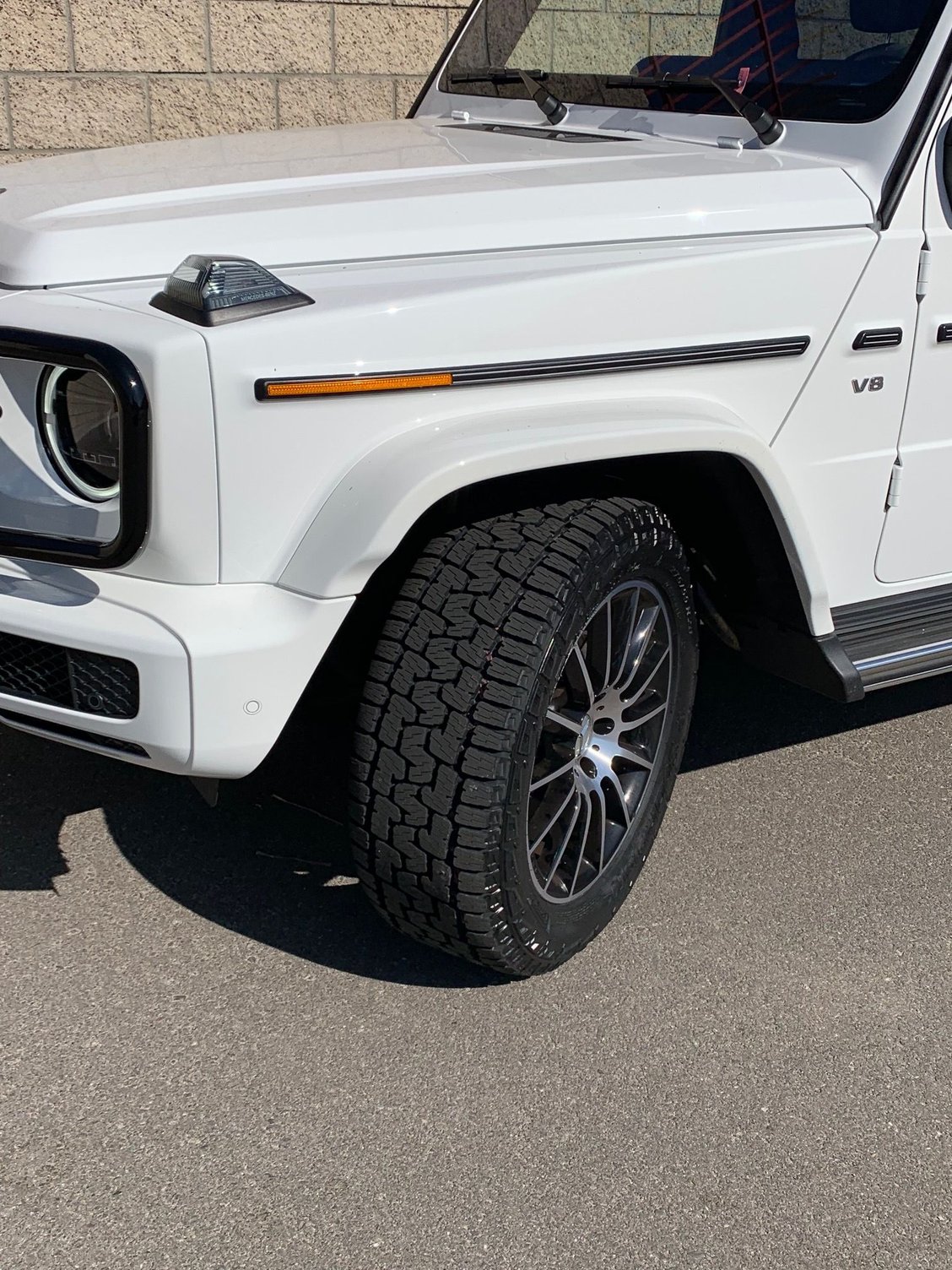

I put Pirelli Scorpion All Terrain Plus 275/55R20 in place of my 275/50R20 stock tires. These are not loud, as a matter of fact, I can't tell the difference from stock. They have made my speedo about 3 MPH slow at 65 MPH, so you have to be mindful that you are speeding when you don't think you are. They made my car about 1/2 higher. Super Happy with these.

Any rubbing issues? I'm going to be ordering 285/45/22 which is just a tad taller then the set up you have, from what I've seen on old G's it will work but just want to confirm.
Thank you

No rubbing at all with my setup.

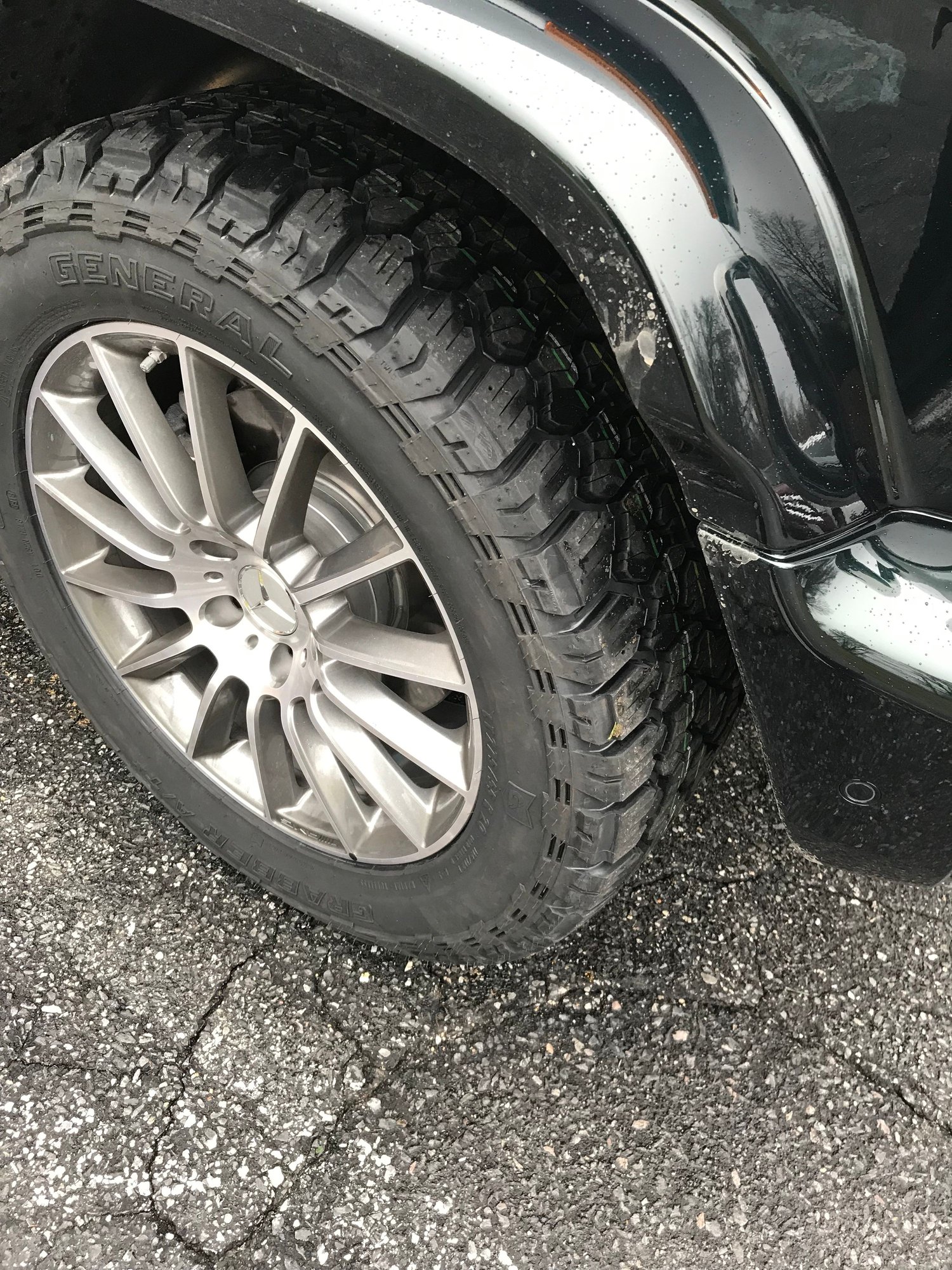

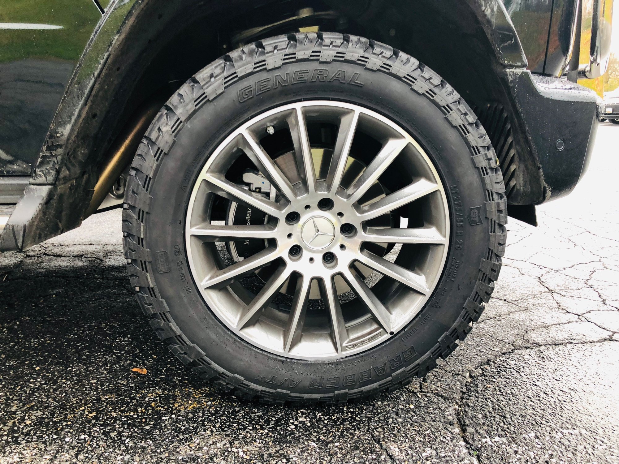

Adding the General Grabber ATX 275/55R20 to the pics. I also bought a larger spare so that it would match the new tire diameter.
General Grabber ATX 3/4
General Grabber ATX Side
