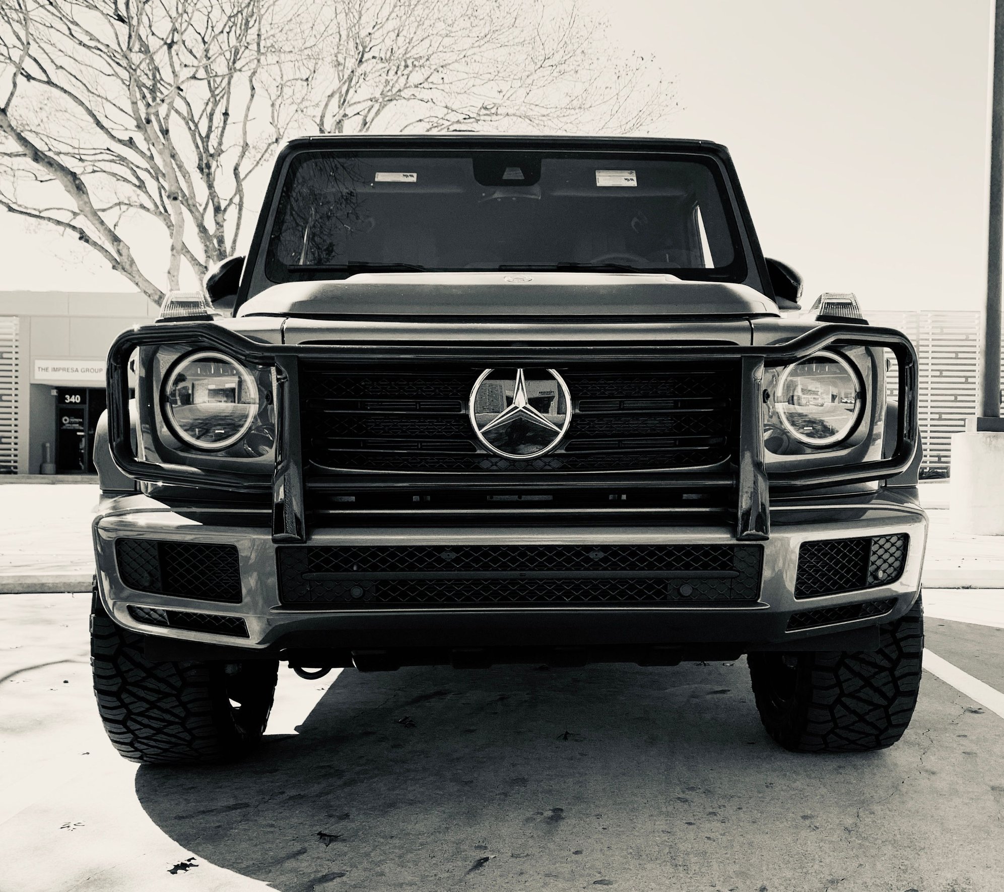

Literally just got home from getting the Ridge Grapplers put on. No idea about the we stuff but they look killer!

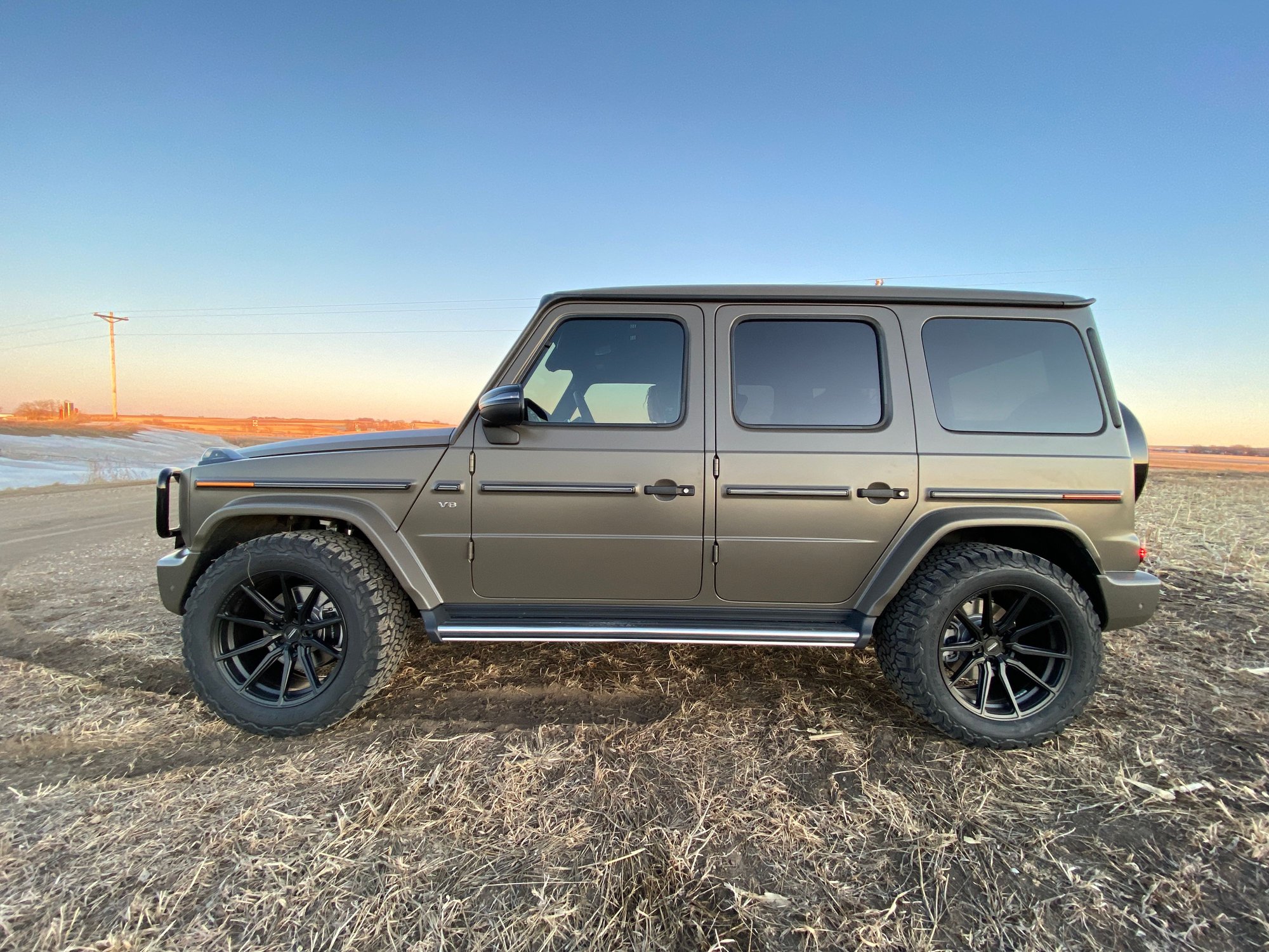

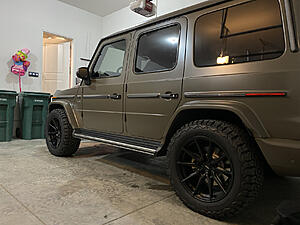

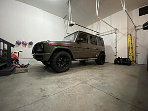

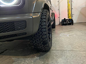

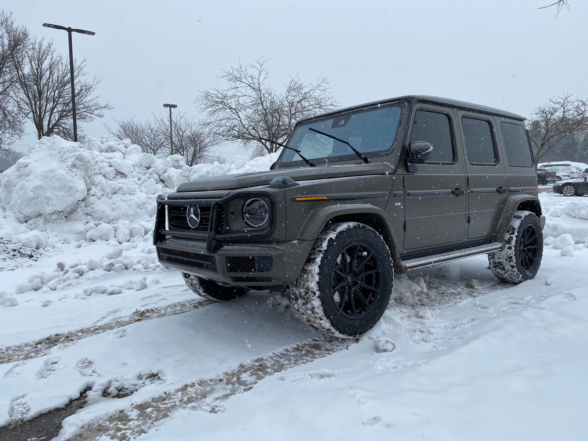

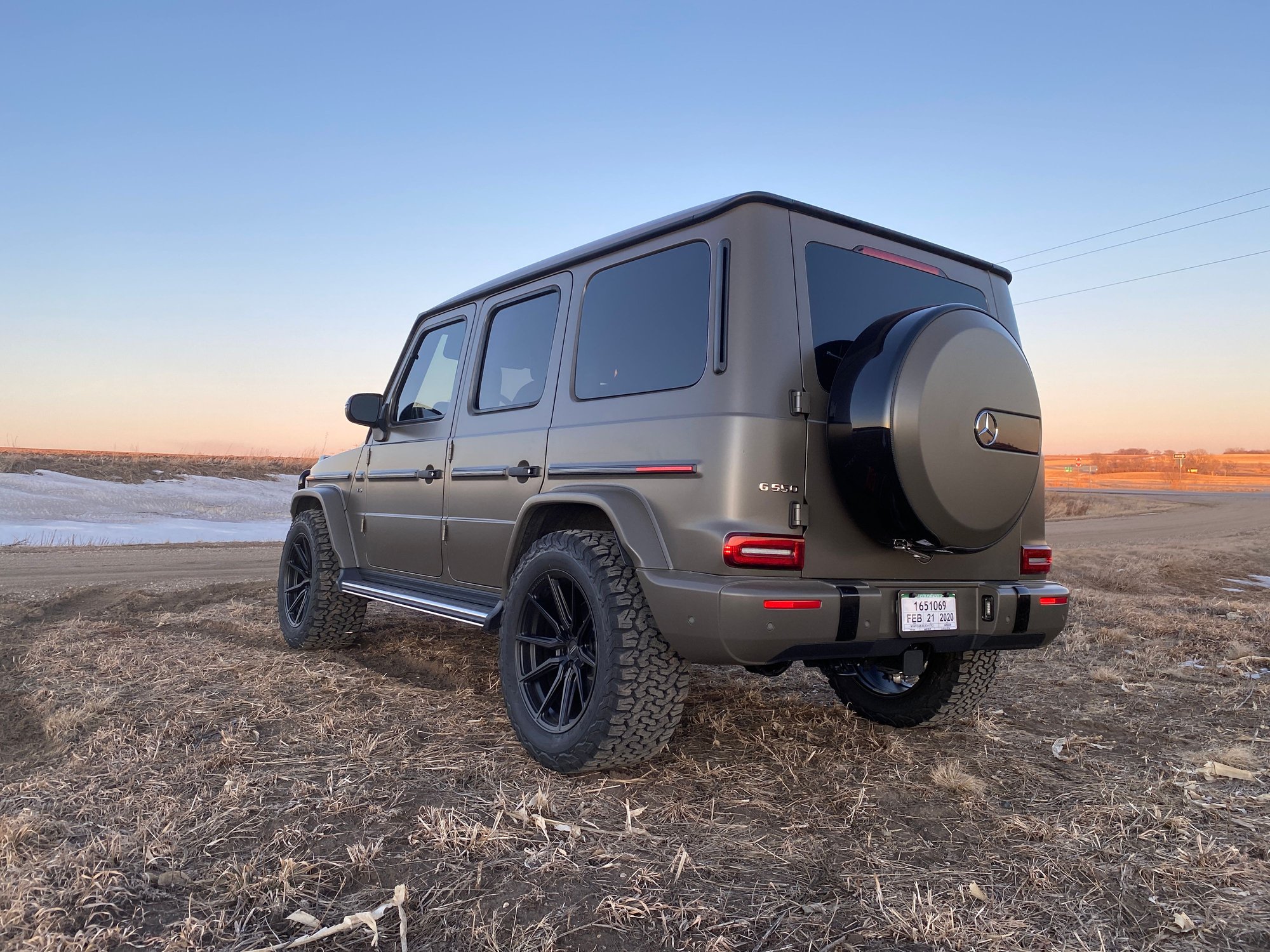

Old Jan 10, 2020 | 08:10 AM
kj71109's Avatar
Joined: Sep 2019
Posts: 24
Likes: 14
From: South Dakota
G550/991.2 GTS
Originally Posted by kj71109
Vadarmerc, those look amazing on the OEMs. Thanks for posting pics. I'll have my setup soon to post. Both G and wheel/tire should be here next week. Going with 33x12.5 BFG KO2 on 20x10.5 vossen et25. I'm hoping for minimal rub.

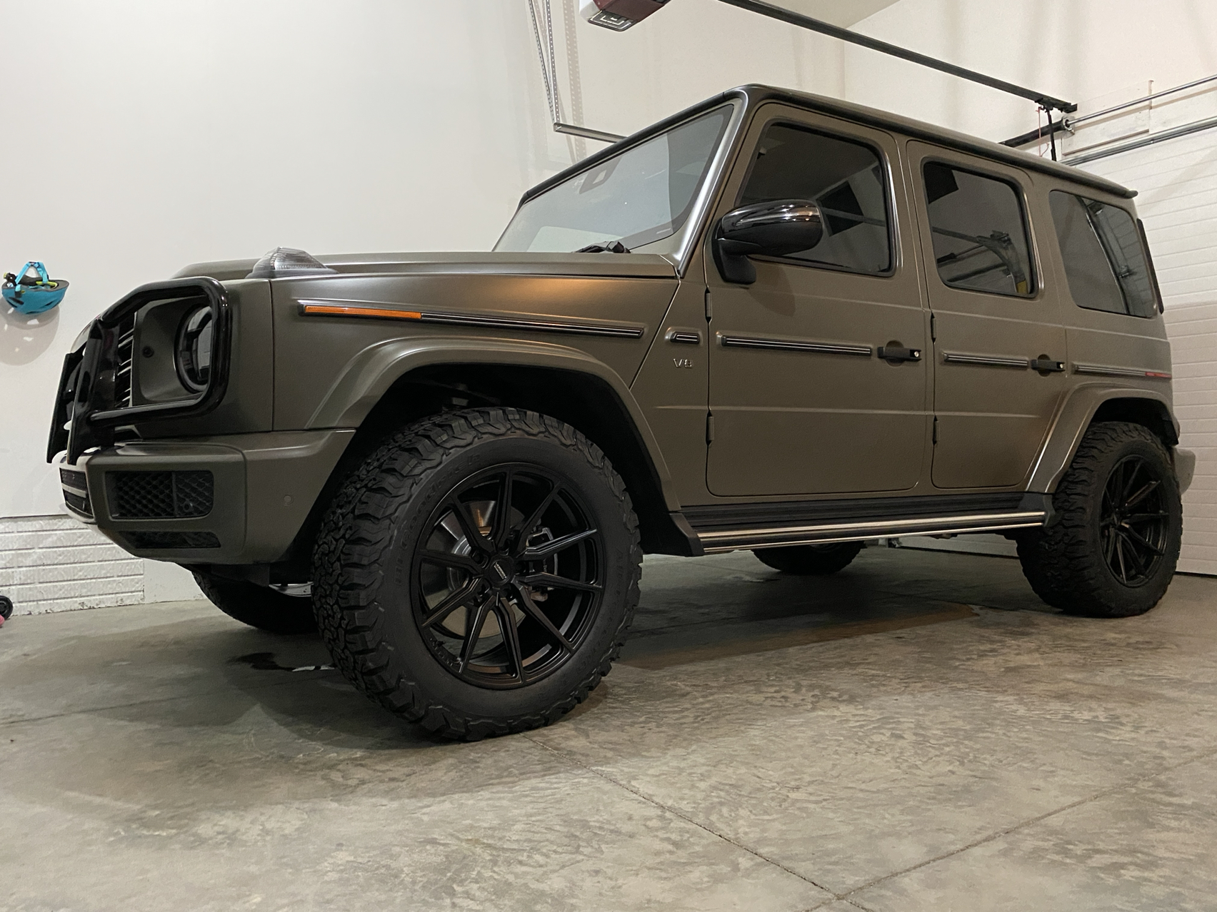

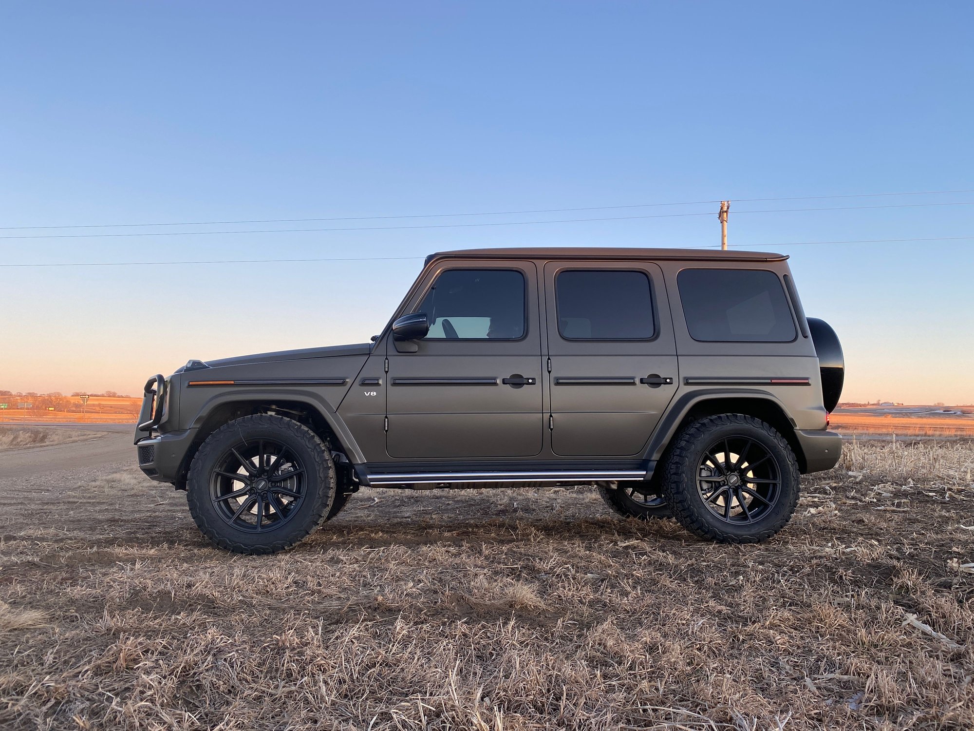

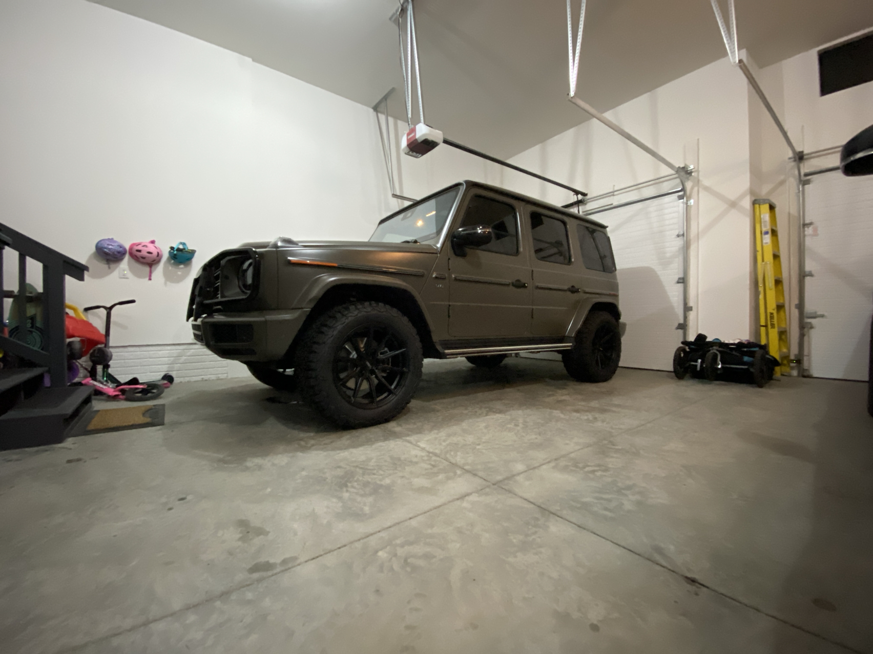

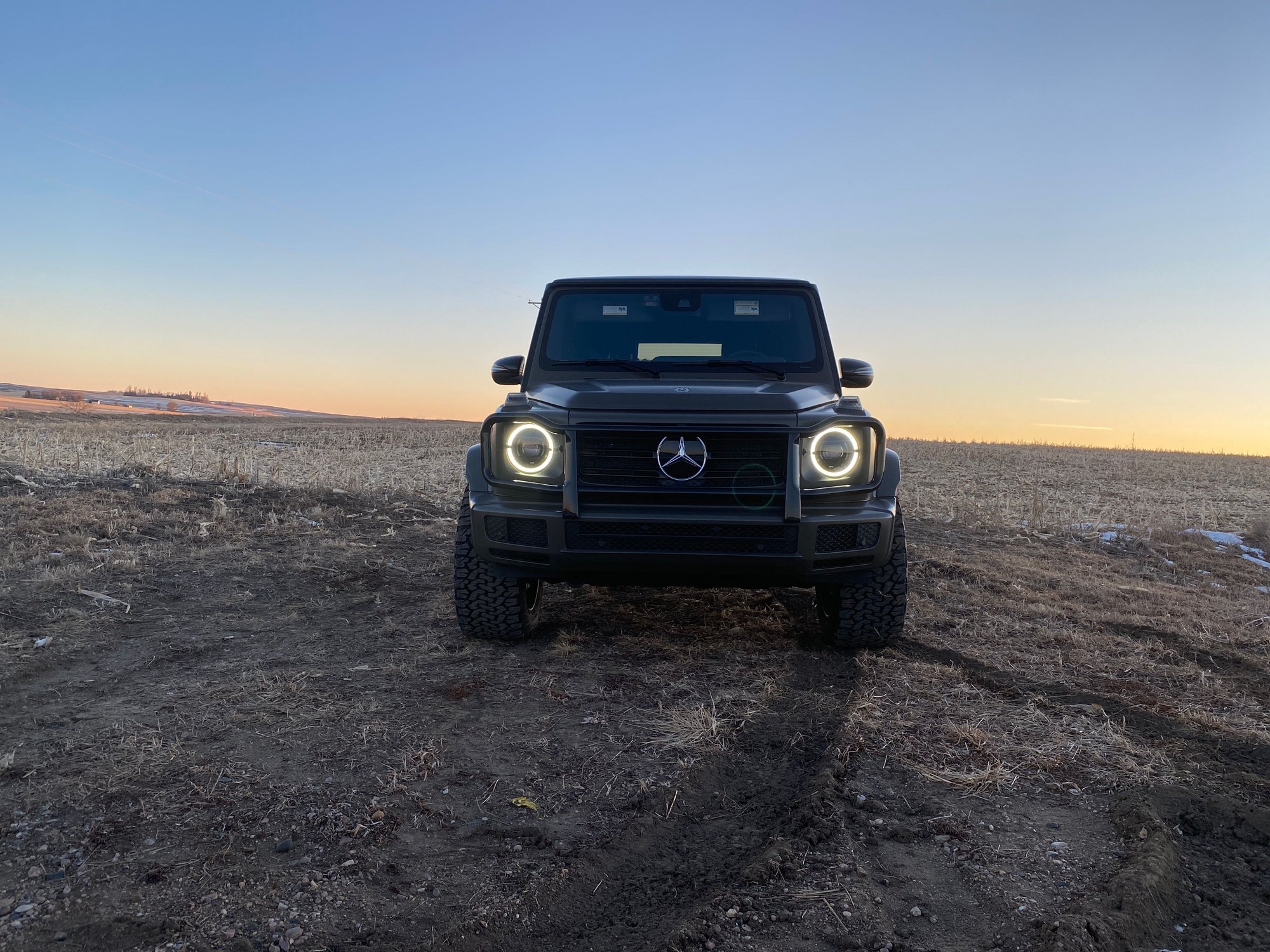

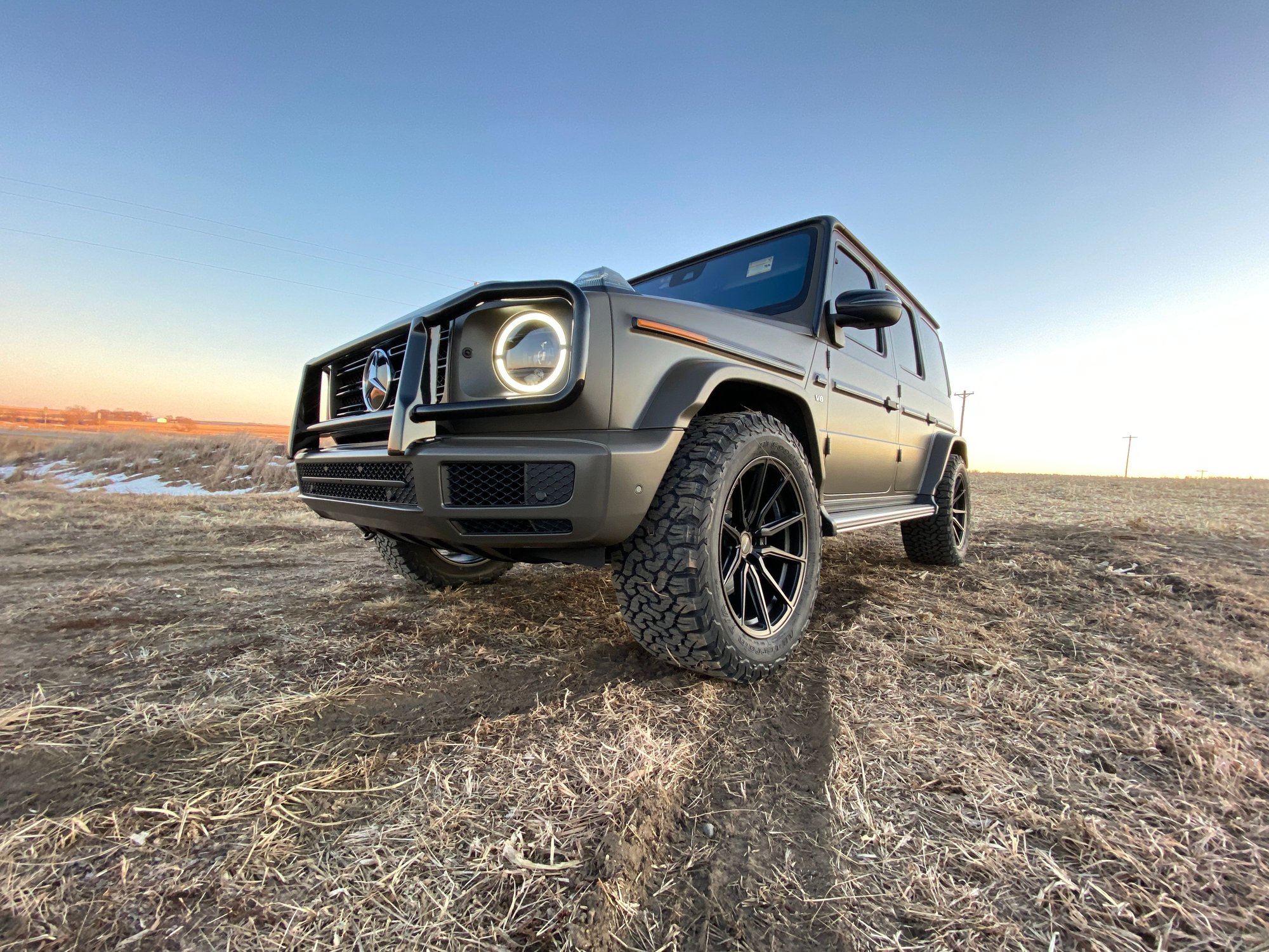

They rub on the fender vent when turning. Have not had a chance to flex it yet. Appears I will have to do minor trimming. Will keep others updated.
Attached Thumbnails Aggressive tire recommendations-photo738.jpg   Aggressive tire recommendations-photo466.jpg   Aggressive tire recommendations-photo837.jpg   Aggressive tire recommendations-photo518.jpg   Aggressive tire recommendations-photo948.jpg

Old Jan 13, 2020 | 11:21 AM
kj71109's Avatar
Joined: Sep 2019
Posts: 24
Likes: 14
From: South Dakota
G550/991.2 GTS
Couple weekend trips this past weekend. BFGs performed flawlessly. One trip in a snowstorm.
Nice set up, your g look great ! I plan to order a set of AGL44 20x10.5 et20, with Toyo open country MT 305x55R20. Hopefully no rubbing.
Old Jan 16, 2020 | 01:55 PM
kj71109's Avatar
Joined: Sep 2019
Posts: 24
Likes: 14
From: South Dakota
G550/991.2 GTS
My guess is you will be in the same camp as me, maybe more rub. It appears your inflated height on that tire will be 33.5"x 12.4" which is taller than my KO2 at 32.5" x.12.5". There was a guy on Instagram running 285/55/20 BFG KM3 on 20x10.5 ET13, which is 32.4" x 11.7", he also reported rubbing, even after a 1.5" lift. His rubbing was only on the fender vents in reverse, and he flexed the rig fully with no other issues. That's the reason I went with my setup. So far I have trimmed the bottom two fender vents off, and no longer have rubbing. There is an open hole now in the wheel well. When I get more time, I'm going to try and come up with a solution to fill this.
