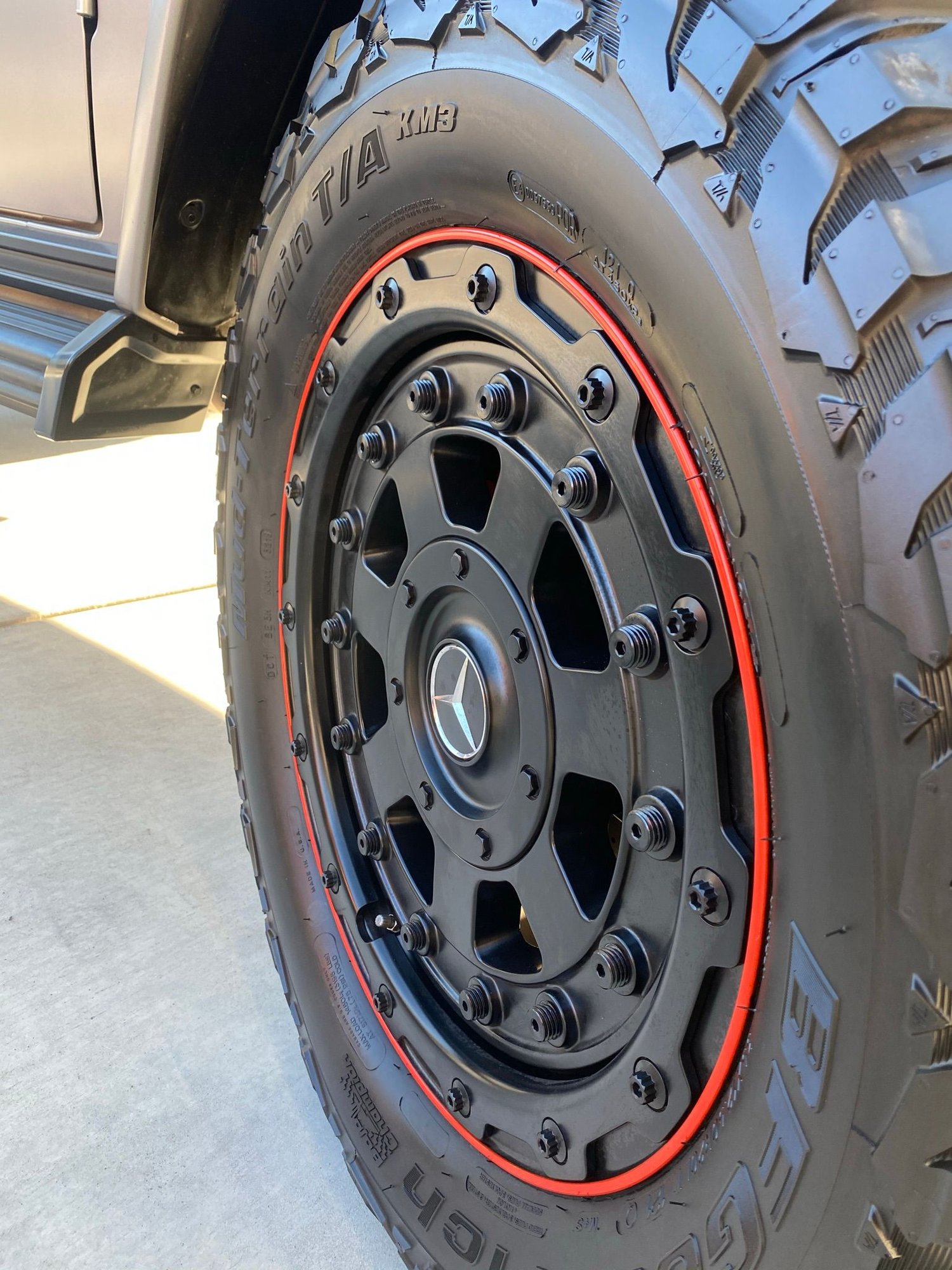

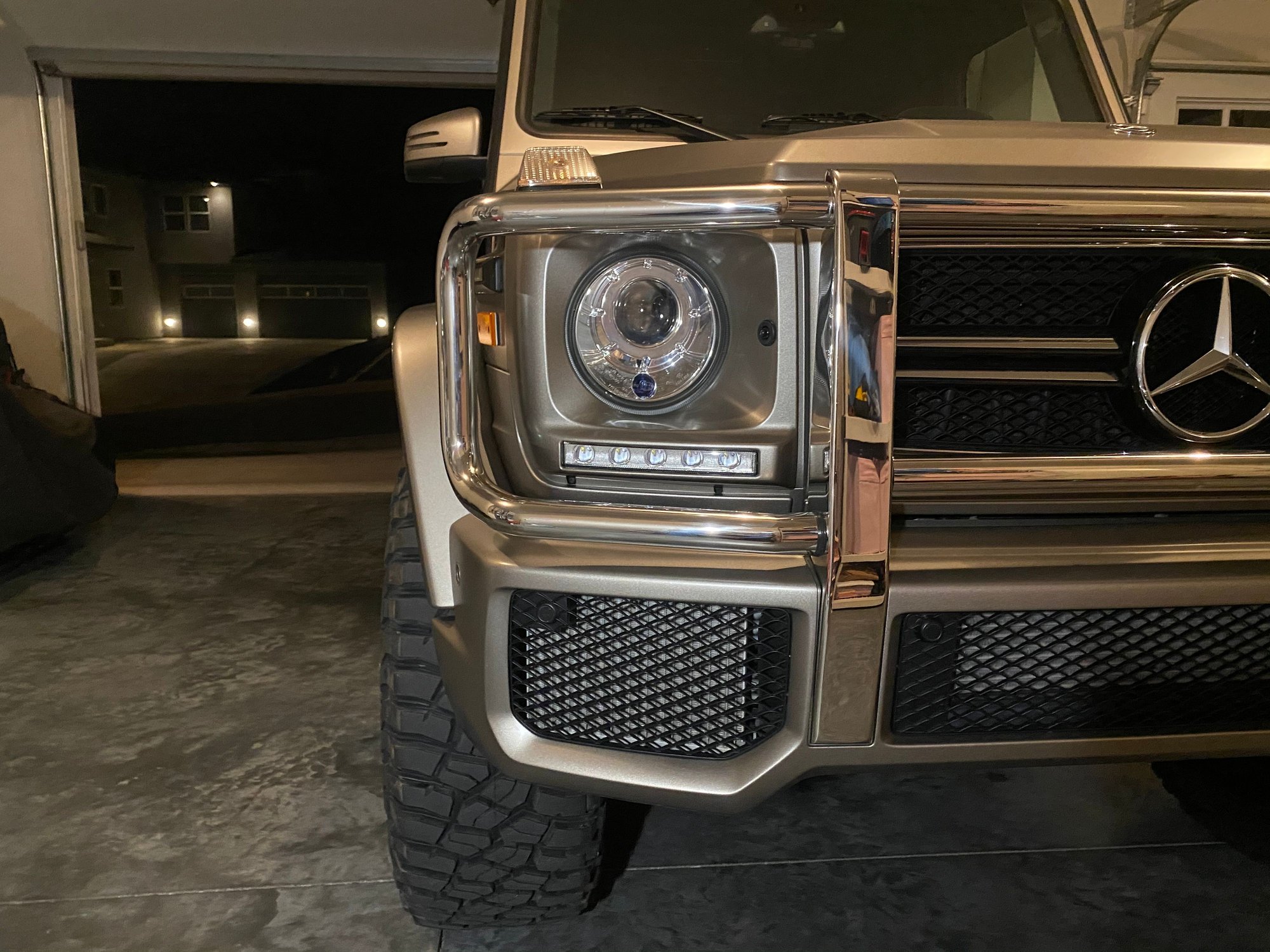

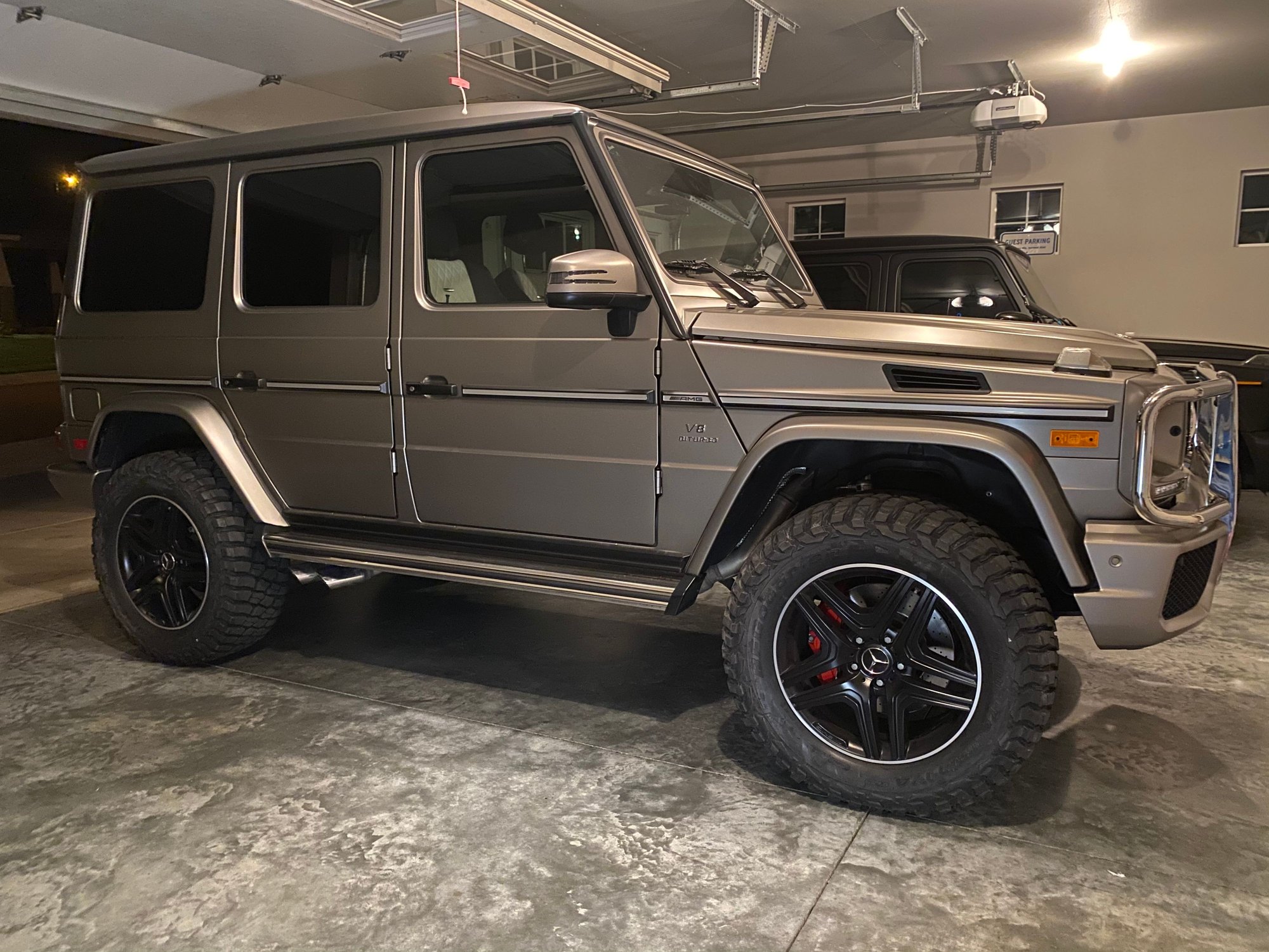

I like the offset and these 35” tires have no rubbing issues. The guys at Eurowise let me borrow a set of Bilstein shocks as the Kings I want are on back order. Besides the tire noise and feel, the G actually drives smoother and the alignment is better now. I did add the front and rear panhard bars and radius arms to stabilize it at highway speeds.
next comes the rack, brush guards, rear tire carrier, blackout of stainless, etc. The fun part.

Theothrknd looks good. Did you use Eurowise’s radius arms?

Yep, I did. I haven't been able to verify yet, but I think the provision they add to those bars for headlight adjustment worked well. It's interesting that the lights get adjusted by a sensor on that part.

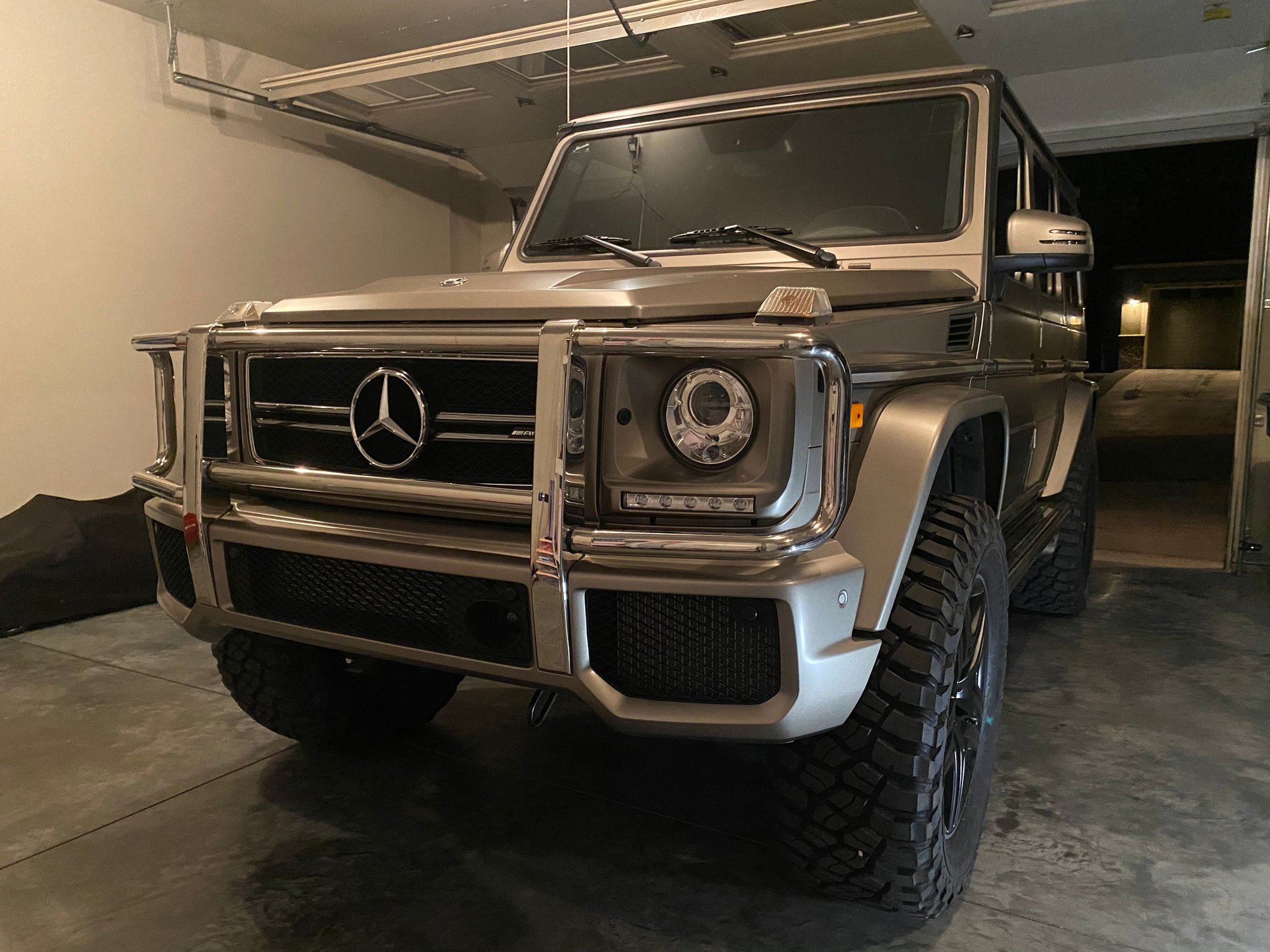

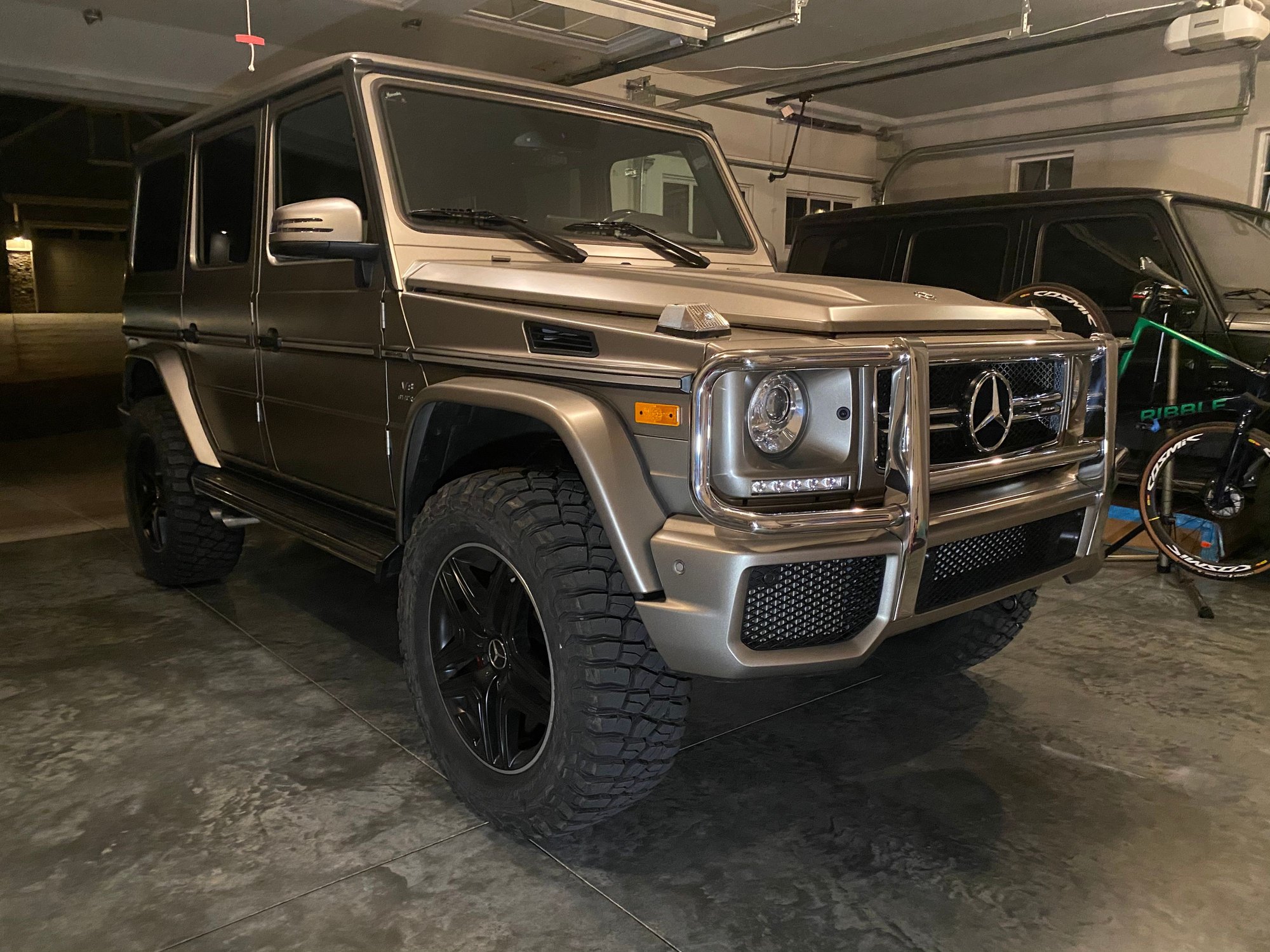

Stage 2 complete.
Originally Posted by C240-Merc
Have you been able to finish the build? Looking forward to what Stage 2 will look like.

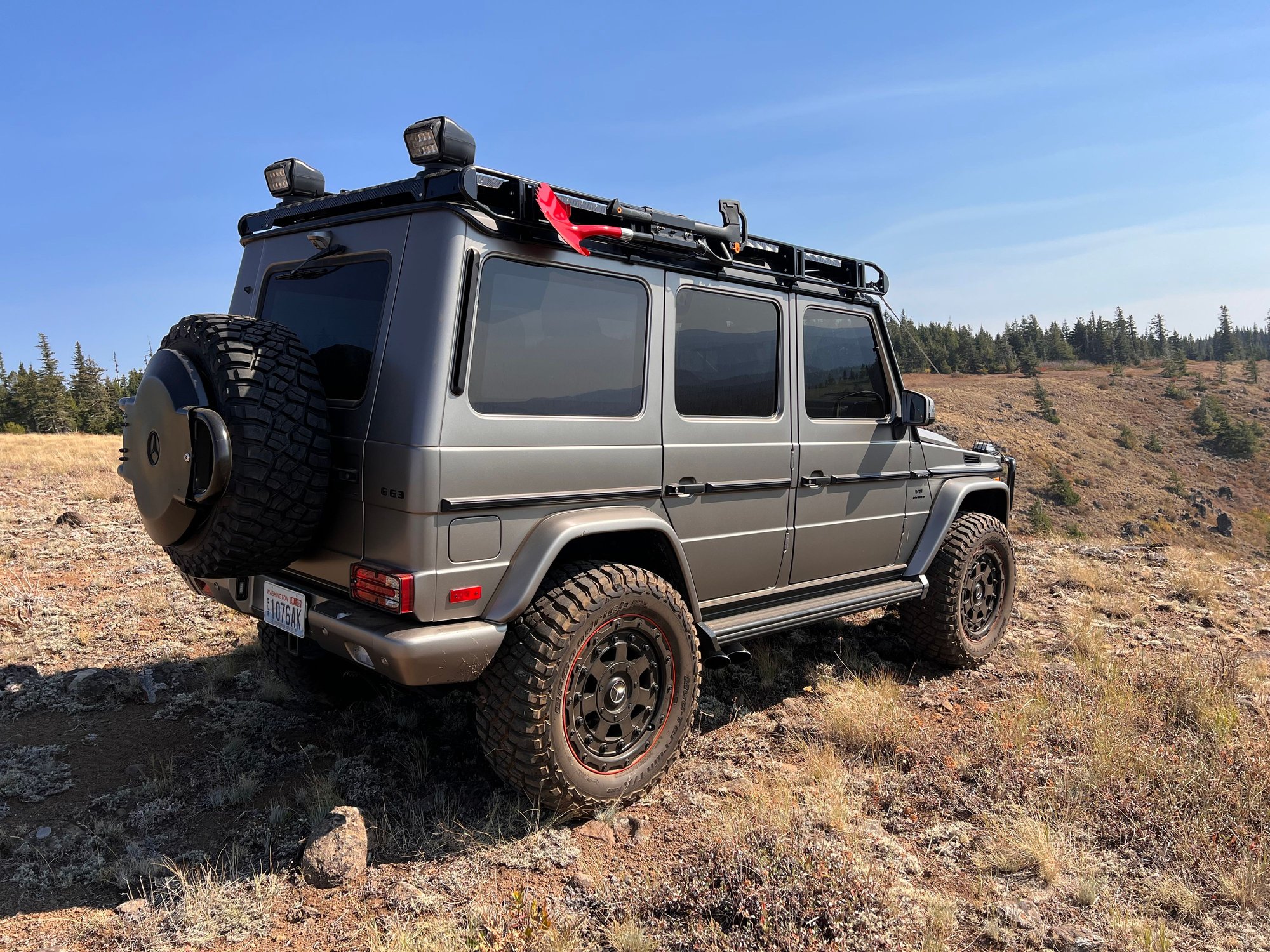

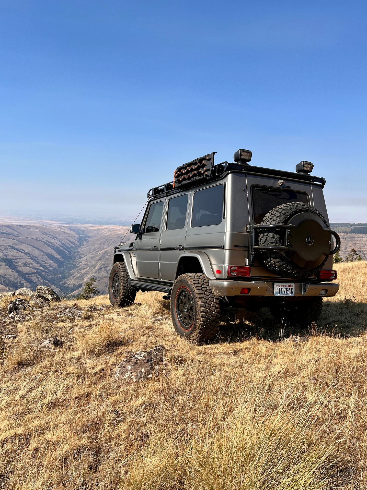

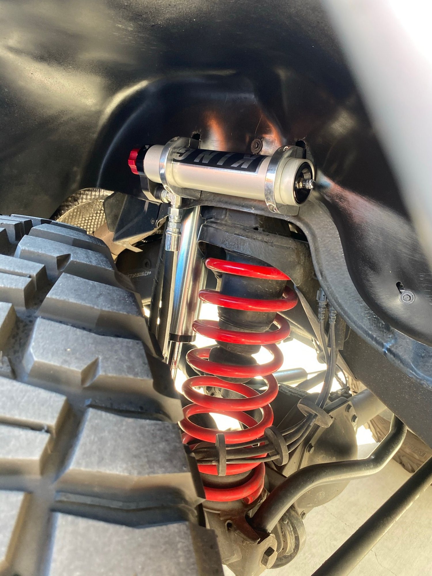

It did take a while, but it’s done. Pretty cool too. The King suspension was a vast improvement over the bilstein. I changed plans along the way a few times as some ideas didn’t look like I wanted, like the front spoiler, etc. the look now works for me. Thanks for asking.

I’m not sure about the Thor set up. Butcher probably knows. I do know that my ride is far smoother with the 100mm and Kings than it was with the original AMG setup. It does seem like too much power when you need to get out and pass someone on the highway, but I suppose a G550 would have been a wiser choice. I just like the AMG vehicle better.

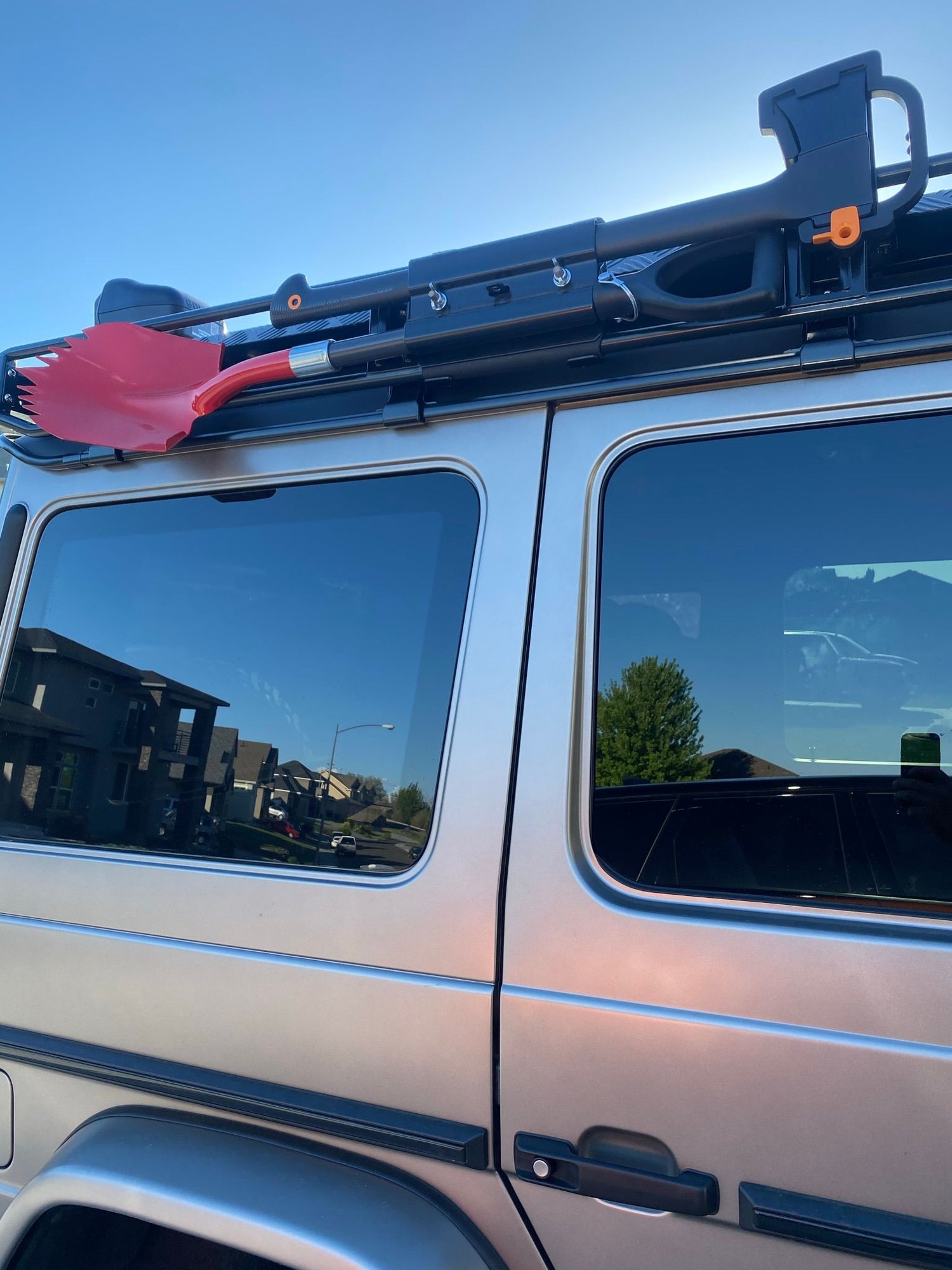

could you please give a description and links to your roof rack and accessories? these are very good-looking. thanks
Old Oct 17, 2021 | 07:11 PM
3WD's Avatar
3WD
SPONSOR
Joined: Aug 2011
Posts: 3,659
Likes: 40
From: Las Vegas
Car
https://shop.3wdistributing.com/prod...v=b0c4bc877c29
We offer it but it's not updated with the W463 items.
Old Oct 18, 2021 | 10:41 AM
Theothrknd's Avatar
Joined: Sep 2020
Posts: 48
Likes: 23
From: WA State
G63 AMG & G63 AMG Edition One.

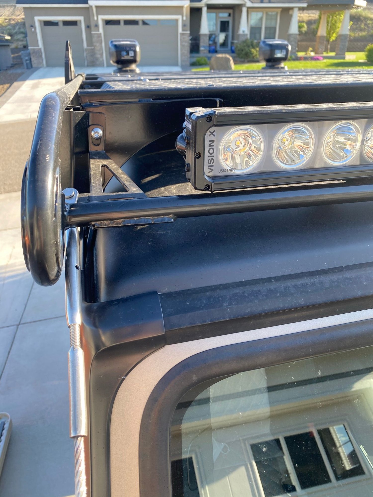

The roof rack was inspired by the Brabus Adventure package rack. Turns out, it’s made by LeTech. The source I purchased it from is no longer available, but here is a link to the same thing at Viking off-road. It’s important to note, however that my G is a 2018 model and there is an ever so slight difference in that vehicle than the 2017 and back. The rack was 4mm too narrow. I had it widened at no small expense so that it would not touch the roof. Otherwise, it will not clear. The recovery boards are easy to source and come and the manufacturer sells the brackets as a universal fit. The axe and shovel mount is a cheap Smittybuilt accessory as the nice ones are custom one offs and I am still in search of something close I can modify so I needn’t start from scratch. You may, depending on your color wish to wrap your roof black. After installing the rack initially, it looked amiss as you could see the color through the rack. Wrapping it matte black helped. I did purchase the front spoiler like the Brabus and spent $900 getting the matte paint finish correct and sourcing the black LED lights, but in the end, I like the look I have now, but it’s noisy due to no aero. If you want the spoiler, I have one cheap! Like really cheap. The lights were a challenge to wire without drilling a hole, but I was able to run them up the A pillars with no modification to the vehicle. Keep that in mind when you begin if you are going to do lights, as it is not super easy to do it without drilling and a 2018 model year uses the MB Bus technology, so splicing into things isn’t an option. The GoGo lights are remote control and turn 370 degrees around and 20 degrees up and down. Very fun actually. I will post photos of lights up close. The are cool. Oh, don’t forget the spare tire carrier, They are not cheap, but it really completes the look.
