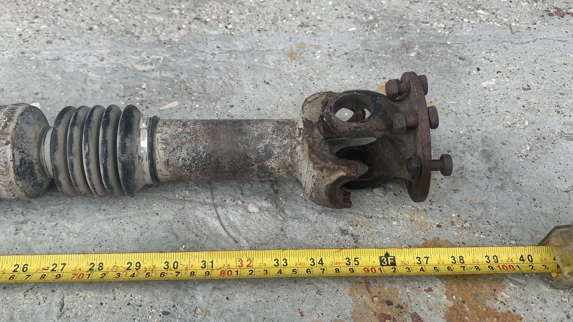

300GD front shaft
Broken yoke , need some info about the shaft

Yikes! Did that rust through?

300 GD driveshaft
37 years off road driving,can’t complain

Front driveshaft specs
Originally Posted by streborx
Just noted your location -- you OK down there? Probably not much available in parts even in the best of times. Are you looking for a p/n, source or both?
greetings, anything will be better than nothing, manufacturer in Newyork never heard about the G ?? Claims to make the impossible, possible, but he needs some measurements to work with

I think the part number is A460 410 20 04 or alternately A460 410 43 04. Try www.expeditionmotorcompany.com, www.couchoffroad.com, www.mastodonmotorcompany.com, or www.mbzparts.com. One of these places might have a salvage part or find one for you.
Other shops do repair (www.driveshafts.com), but this requires both-ways shipping.
