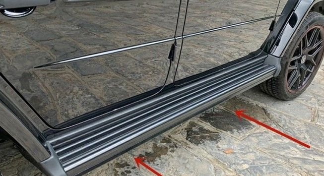

Vender is providing two quotes for powder coating. Vehicle drop off or running board drop off. How difficult is it to remove running boards.
Appreciate any response.

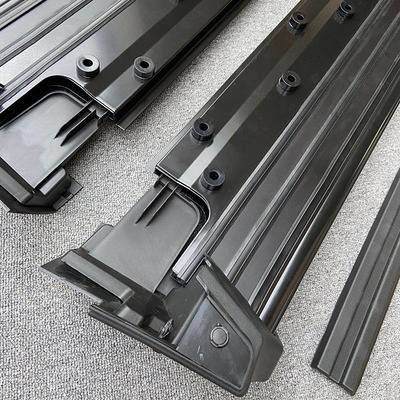

So we will see......ordered a direct replacement new set which is black electroplated stainless steel. $1000. to my door air freight in 10 days or so.

Dalien Eurocar which is a manufacturer for exotics in China.......... I hesitate in giving you contact info until it has arrived and I have been able view it in person. I'm happy to be that guy who takes a chance. I did have fairly extensive conversation with the factory regarding material and process and was satisfied with their answers sufficiently to place the order. It is stainless steel and they claim it is an exact copy of the original with the exception that it has been electroplated with a black process.

I hear you....the problem is that OEM and Gwagenparts base their pricing on the assumption that individuals can not get to their manufacturers in China. I suppose I have spent too much time in China dealing with manufacturers to understand that it is very much possible to get to the source. Lets wait and see what arrives. I will do a fairly decent job in assessing. I'm not interested in devaluing the vehicle by putting inferior components on it.

It seems this eval will require some framework. I'm thinking:
1. Side by side visual
2. Weight comparison
3. Material comparison
4. Gauge thickness
5. Grade 304 vs 316 (should be able to get this from manufacturer)
What else do you need?
