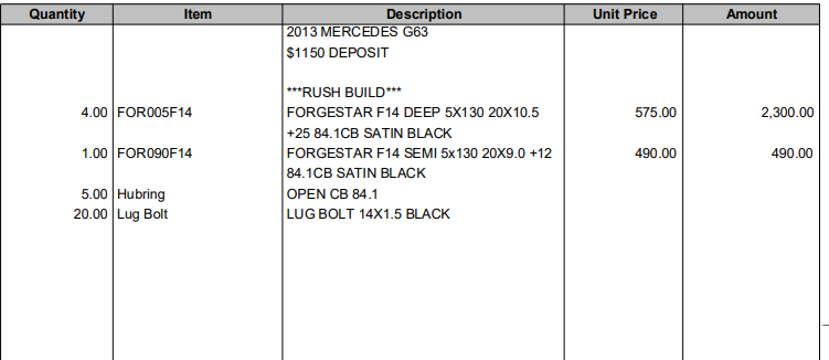

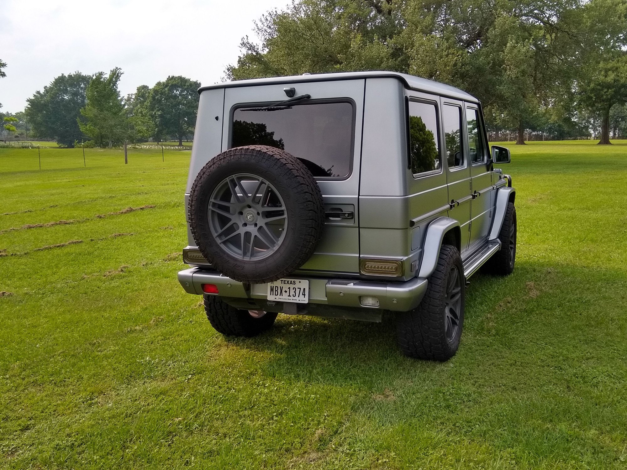

I ran 20x10.5 Forgestars with Et 25 on my 13' G63 with a wide 305 and they fit perfectly..... 0 would be aggressive, but perhaps doable depending on the tire width

The Toyo At2's ran really wide in a 305 - other brands or a 285/295 would likely work fine if you wanted to be conservative.
