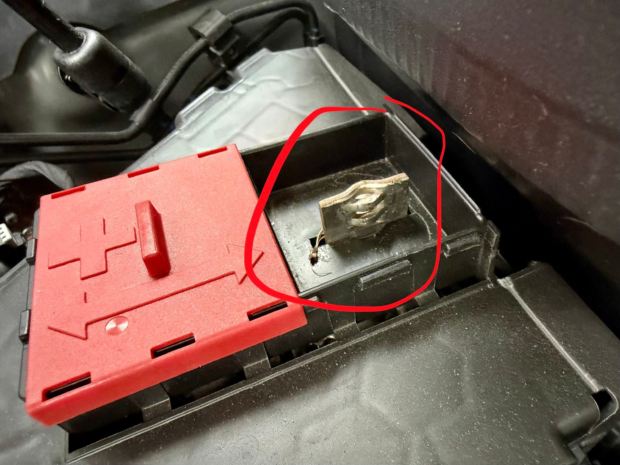

Love my Noco genius 5. Can charge using access under hood. Positive to the terminal under the red plastic cover and negative to the bolt sticking out from the side. That’ll take care of the message.

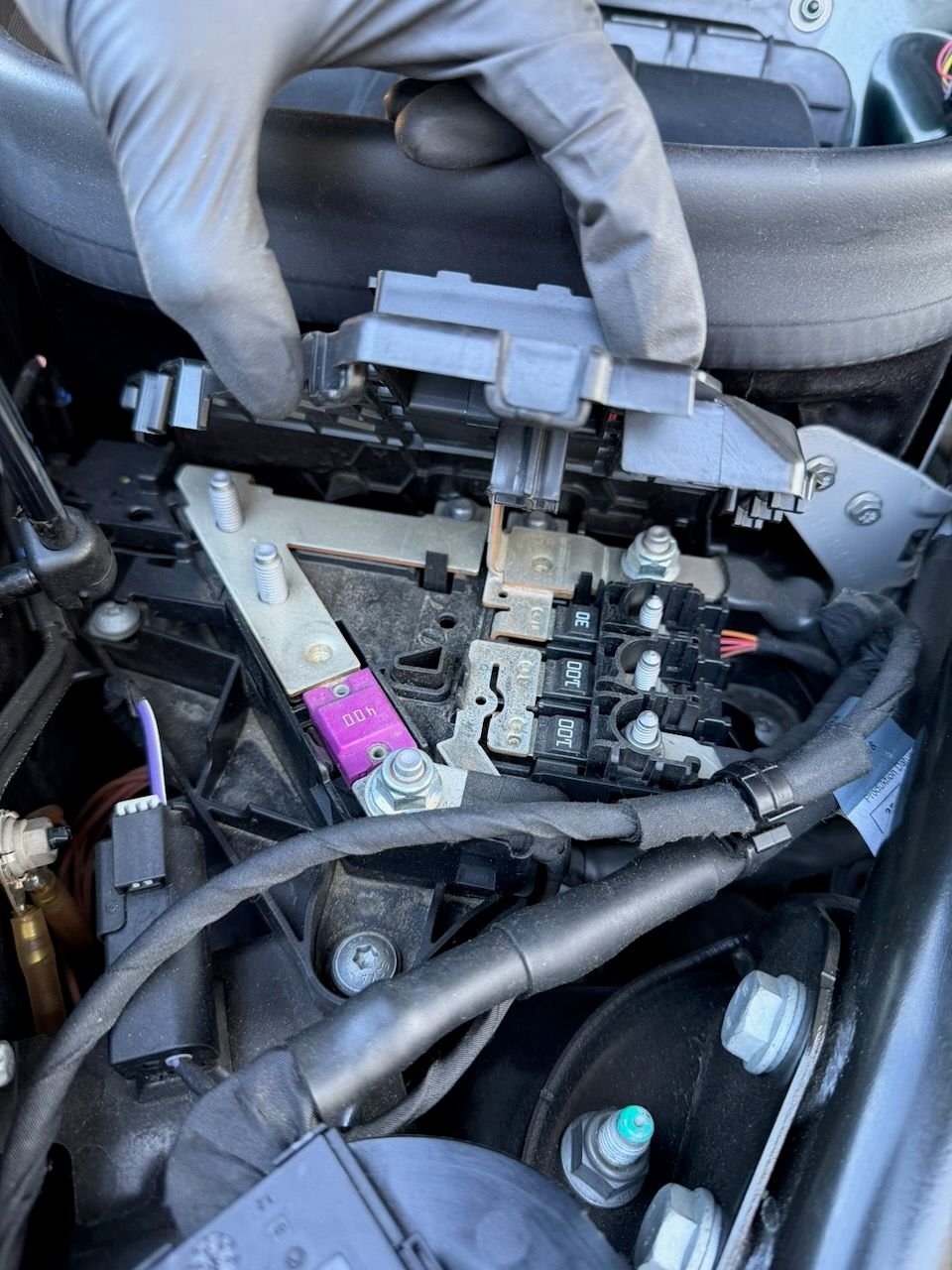

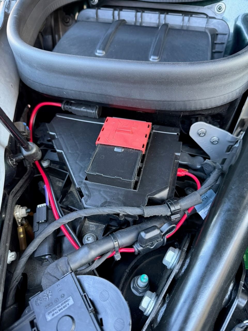

How did you attach the pigtail eyelet to the positive terminal under the hood? And did you use the M6 or M10 size eyelet adapter harness that Noco sells? See pic.

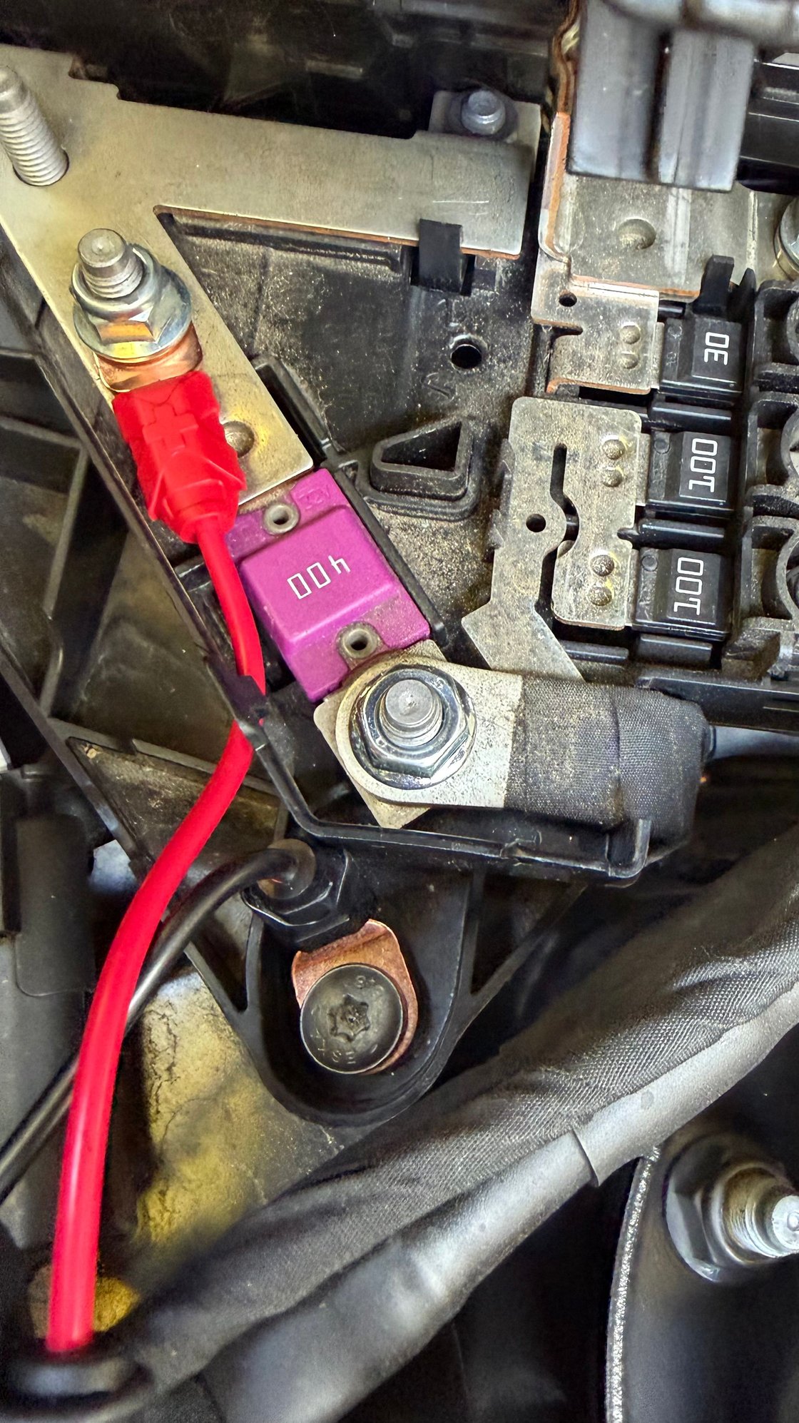

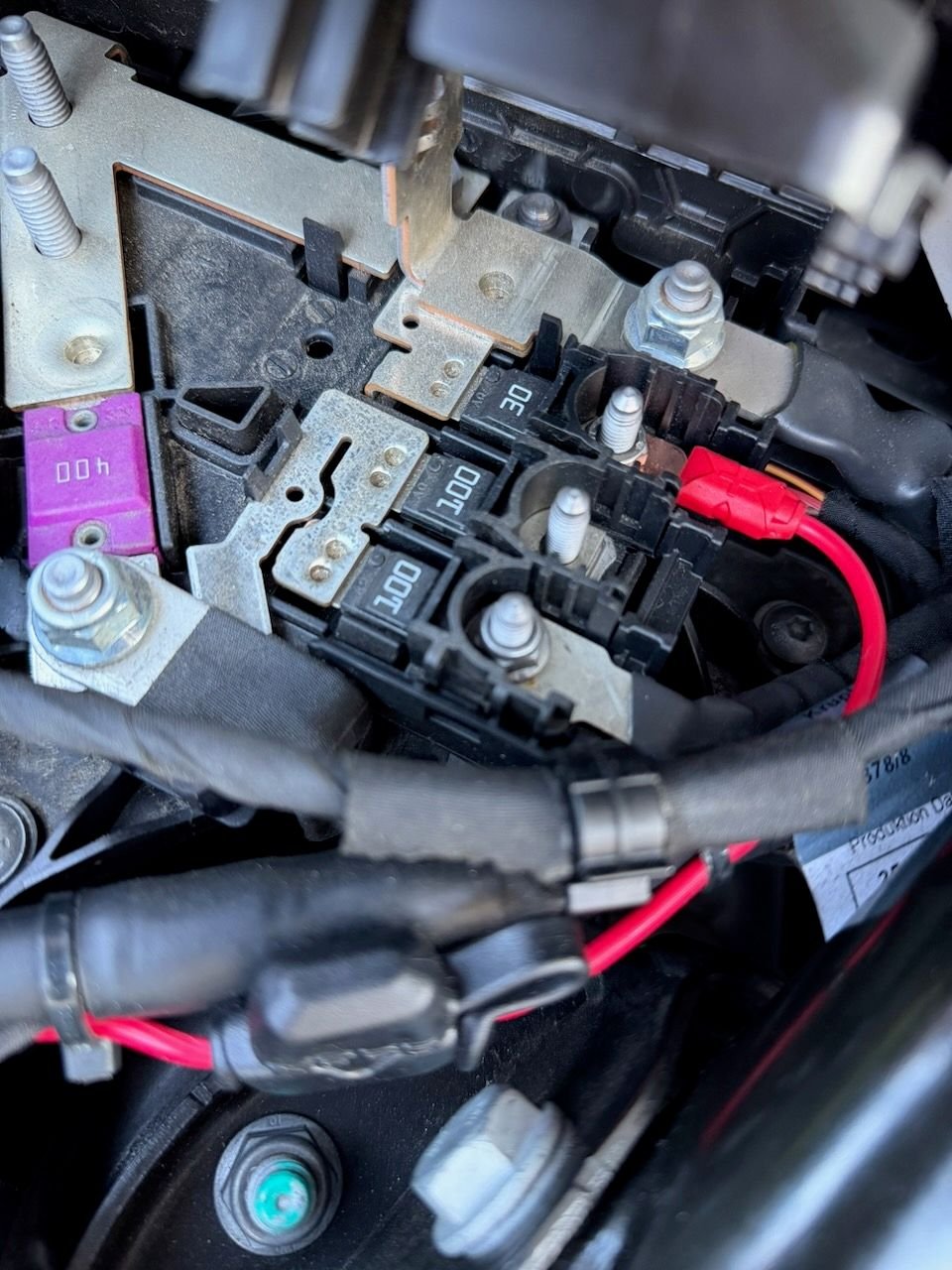

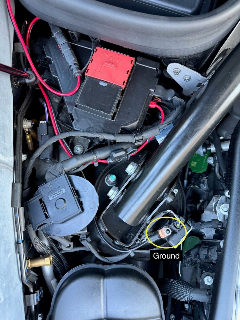

I popped the plastic cover off and tied the +12 eyelet directly to the busbar that's cabled to the battery, and tied the ground lead to a nearby chassis bolt. I have several Noco chargers, but the one I use regularly with my G is the 1A unit that's a wall-wart. I have a wall outlet just a couple feet away, so the cable is plenty long to reach the pigtail.

I did similar to @streborx except I used a Noco GC002 M6 harness
Amazon Amazon
, and two M6 metric nuts. I secured it to an unused stud on the 30A bus. I grounded it nearby on the strut tower.
