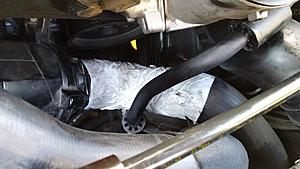

Found my reason for transient power loss (no boost/under boost) P0299

just happen to have some duct tape and 4in hose clamps.

this setup held while on my way home. CEL went away but the P0299 stayed on my ELM. Going shopping for a aftermarket reinforced silicone hose. yay... PN 1645282182 Item marked #2 on MB diagram

Doing a little research, this is a common problem on Sprinters.http://sprinter-source.com/forum/showthread.php?t=29053
there is a "repair" kit, but IDK if is just an emergency fix or permanent.
http://www.eurocampers.com/Repair-ki...ine_p_211.html

Haha nice fix. I did the same on my old XC90 - lots of duct tape did the job for a week till I got the new hose in. Didnt need the clamps but you definitely did it proper! I dont even think you needed a new hose haha.
I think thats just the repair kit. I would just replace the hose and forget about it.
