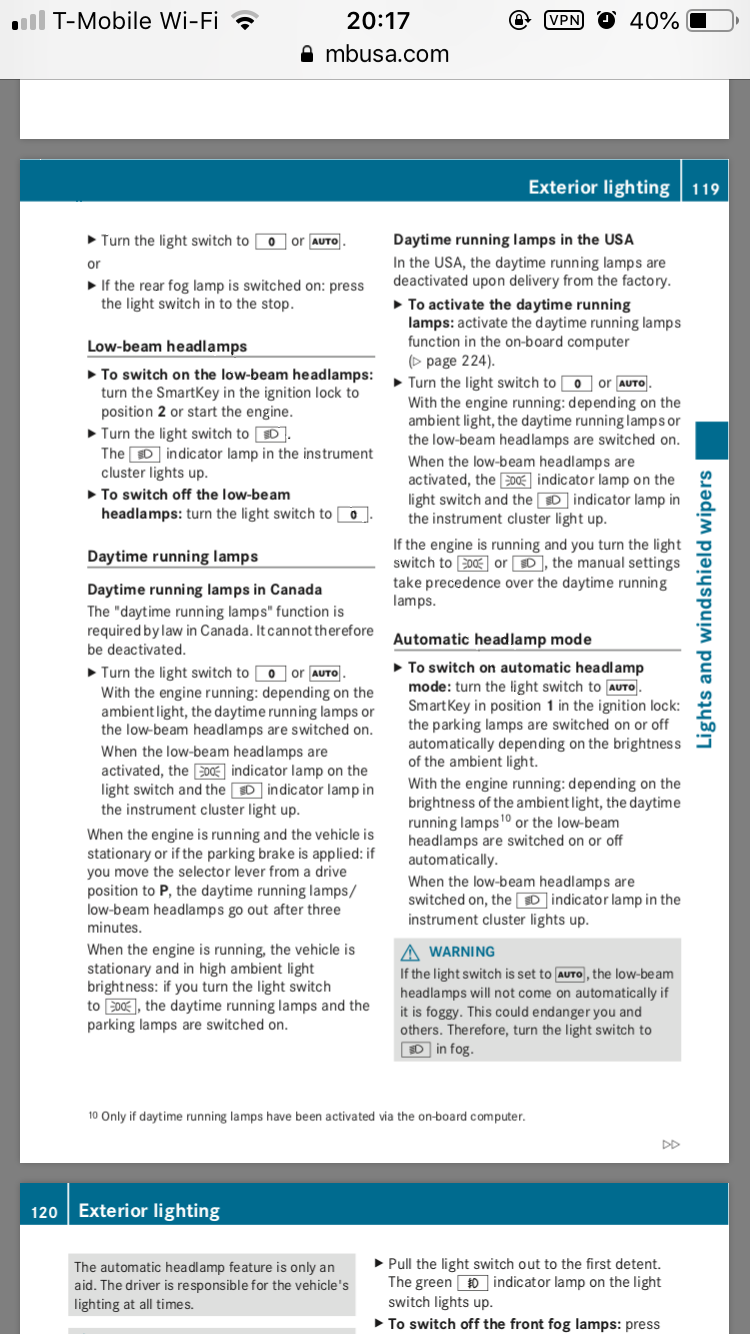

Have any of you guys checked the manual to see if there's a way to turn them off (again, mine is a '08, but they stay off if I want them to)? Maybe some sort of switch-turning combination?

Originally Posted by Tek.To
Yea weird. Mine are like that too. Mercedes Benz 2011 GL550. I leave the DRLs "On" in the dash/speedometer cluster portion. If I try to turn the headlights off when I'm in a dark location, they stay on, even at the "0" portion.
yep.
It says they tuen off if you engage the park brake. Have yet to try that.

It appears there are different "rules" the car follows depending on whether it was originally sold in Canada or the US, as well.
