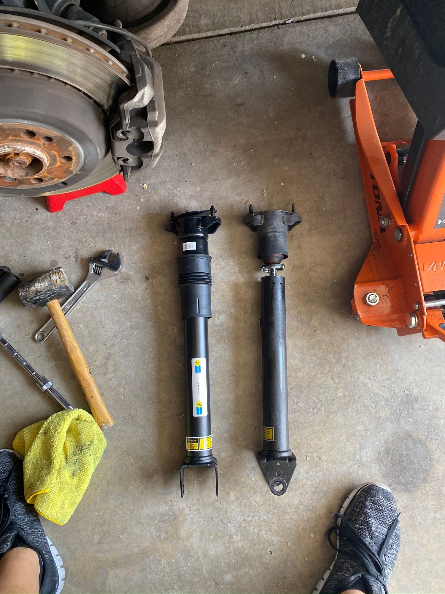

A couple of years ago I decided it was time to replace the rear shocks that were leaking at ~180K miles. Since I didn't expect to keep the GL for an extended amount of time and I couldn't find Bilsteins (with ADS) for less than the ~$1000 MAP price, I went with some no-name Chinese replacements off I think Amazon for about a third of that. I was expecting an improvement in handling and didn't really notice one which was surprising given the age/mileage of the I think original shocks. Not a good sign in hindsight. Since then, the ride and floatiness from the rear end has gotten progressively worse and worse to the point I really didn't like driving it, I noticed one of the rear shocks was leaking again and one of the rear tires was starting to wear in a cupped fashion, which is a symptom of a bad shock. Since Rock Auto carries Bilsteins for ~$650, I decided to replace them again. It wasn't hard to tell the difference this time. Both ride and the wallowiness of the rear end both improved dramatically. If you're doing the rear shocks, spend the extra money on the Bilsteins - it is well worth the extra cost.

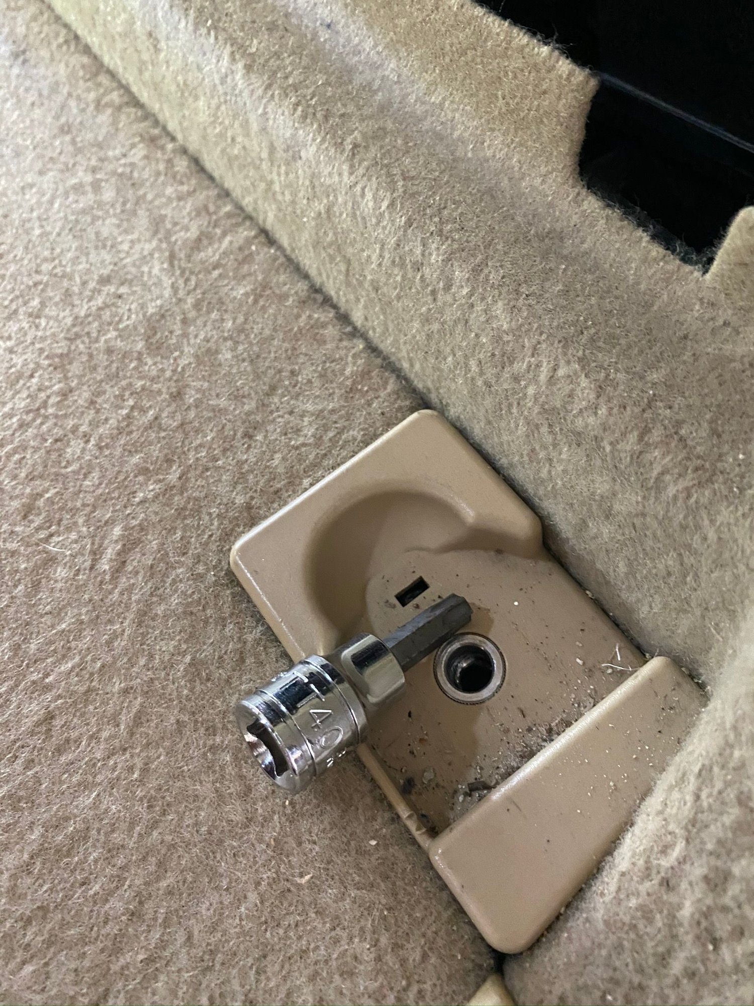

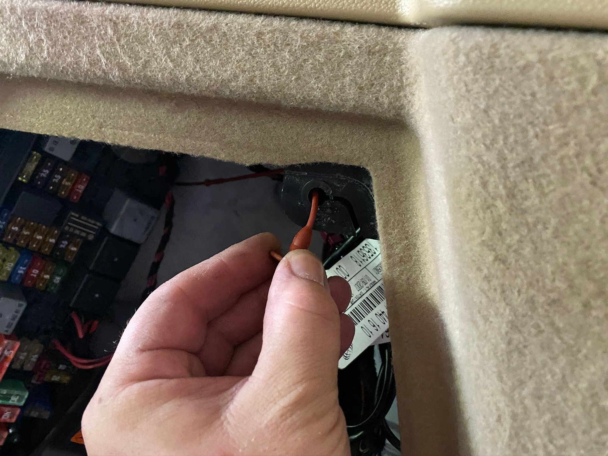

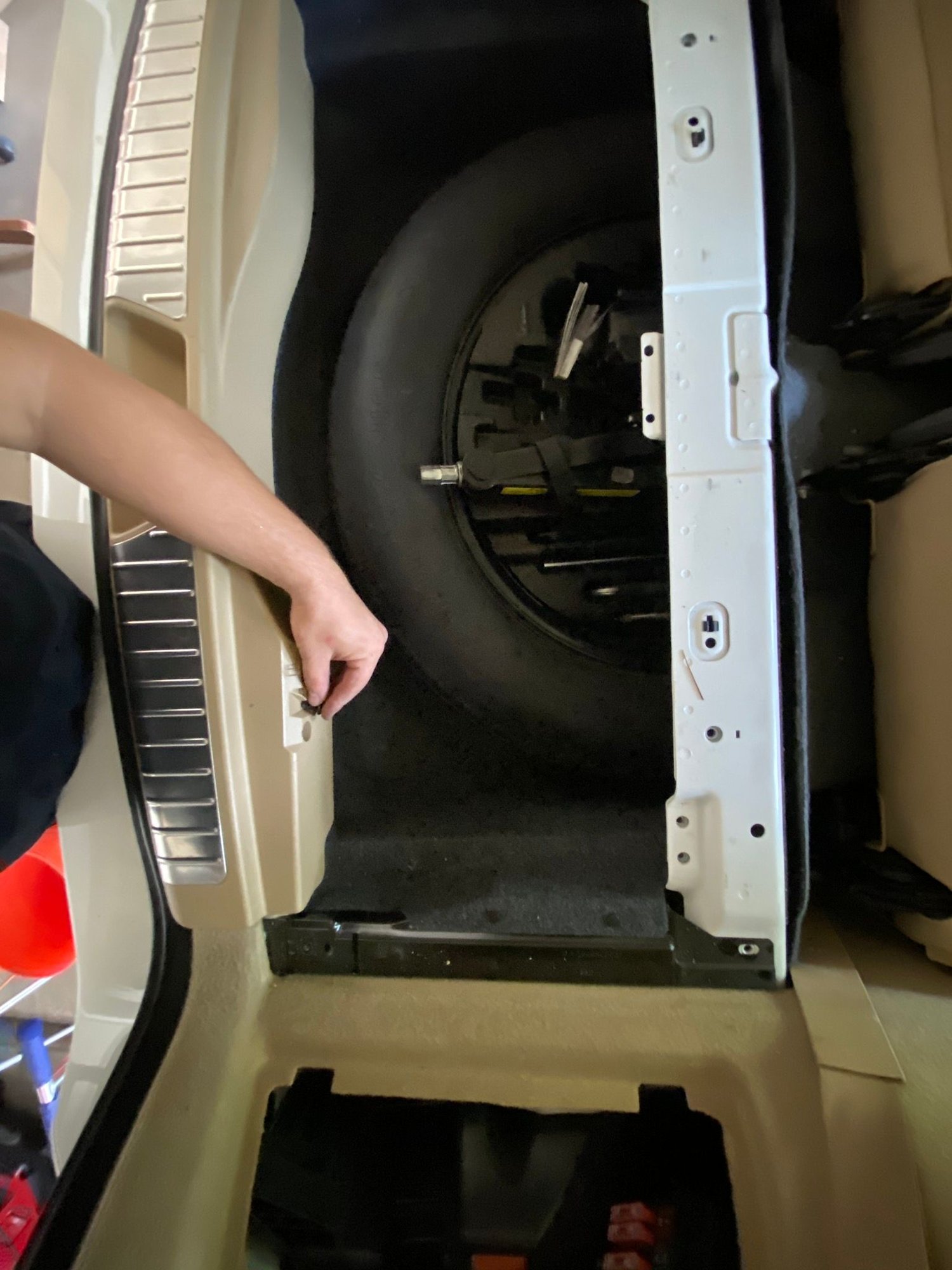

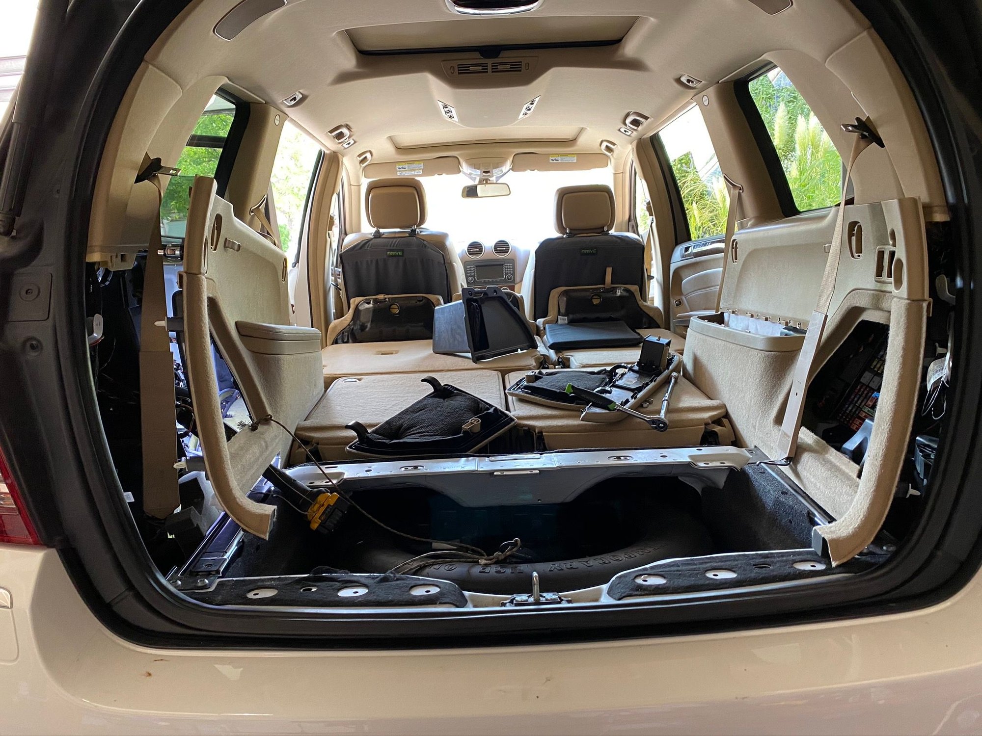

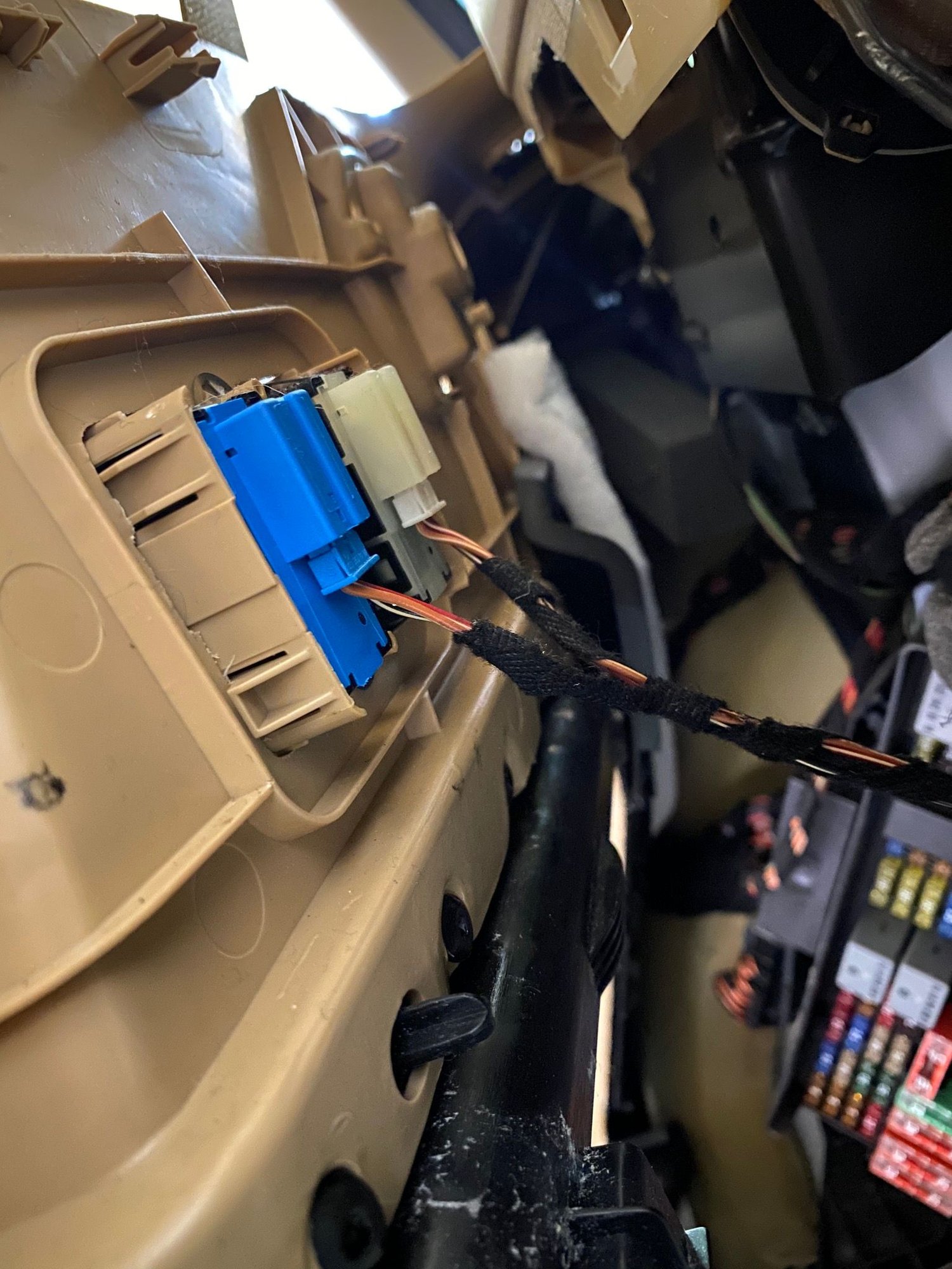

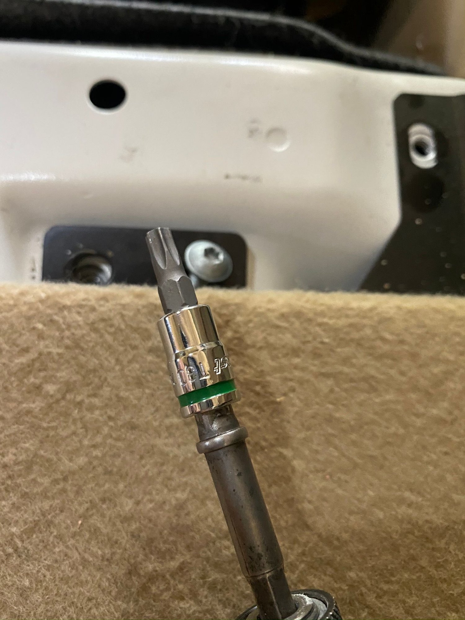

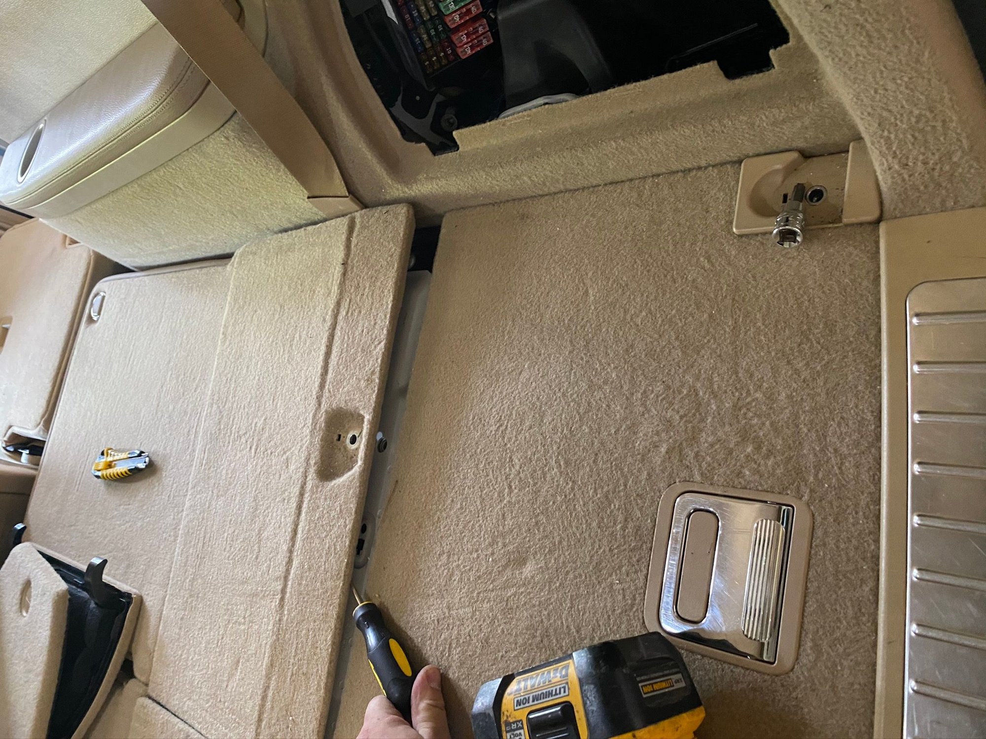

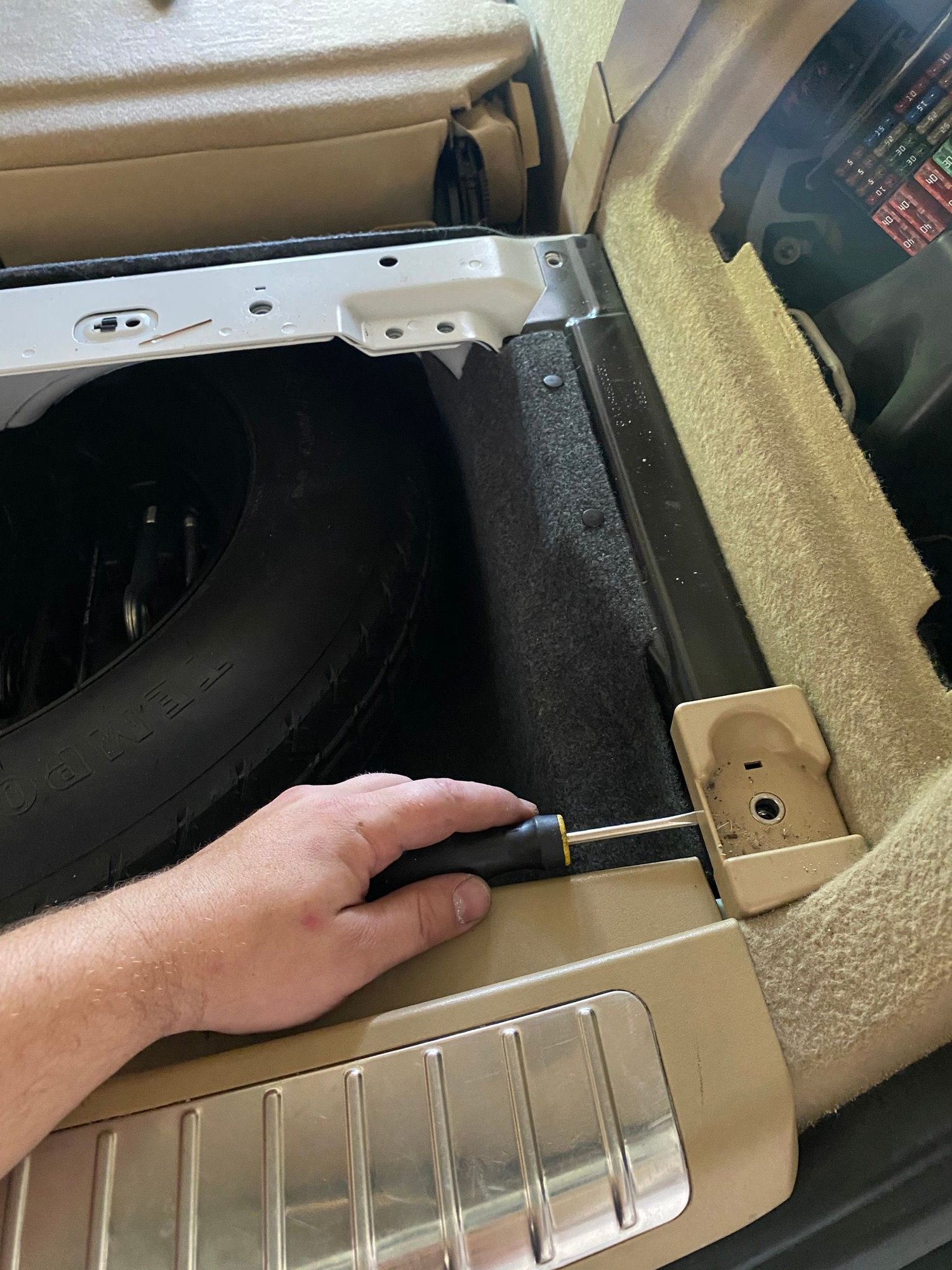

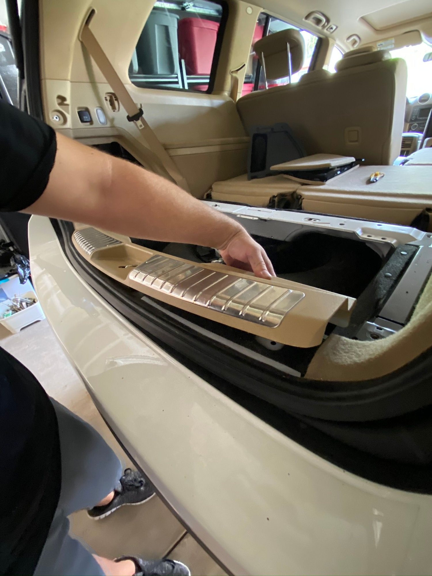

One of the most intricate rear shock jobs I’ve done. Had to remove the headliner all the way around in the trunk to access the top bolts.one of the YouTube videos recommended to remove the 3rd row armrest. Don’t do it, it will break off and it won’t be any easier. It’s not meant to come out and can’t be glued back.
Insulating foam had to be cut on top of the bolts with a razor and then glued it back with contact cement spray. Surprisingly everything went back on like in original state. Use good quality shocks, do not go cheap.

Thanks for the pictures, it does require quite a bit of removal in the interior to get to the top of the shocks. It would be pretty tough to get to the nuts and remove them without dropping them going through the armrest, especially the first time when the foam is intact, but people have done it. I pulled the side panels both times.

They probably replaced the Air Struts/springs, not the shocks.
The x164 has both 'shocks' and 'air struts'. The front suspension has a combined air strut + shock assembly. You can replace just the air strut (typical diy route), or the whole unit. Whereas, in the rear, the two components are separate, so they can be replaced individually; although typically you would only replace the air struts.
In short, replacing the rear air struts does not equate to replacing the rear shocks. And the price tag would be considerably different to do both.

There’s no way a shop could have replaced the shocks properly unless they removed the interior panels.
i did mine in about a day, it wasn’t that hard just tedious. If I paid a shop 10 hrs or labor for this job only to find that they ripped off the seat armrests and glued them back I’d be coming back to get money out of them.

Not at all, that’s why I posted pictures here
