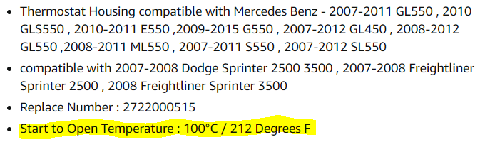

Originally Posted by DennisG01
I'm not sure what the stat is rated for - in terms of what temp it should be "fully open" at. It would probably help to know that.
Did you happen to do the stove test to the new stat to see how it functions?
Thermostats are rated for their start-to-open temperature:
So at sea level, a boiling pan of water would just begin to show opening.
How that translates to temperature stability depends on the rate at which the coolant is being moved, the rate at which heat is being pushed into the coolant, and the rate at which the radiator sheds heat to the environment.
If the pumping is fast, the heat rate is low, and the radiator is big and/or the ambient temperature is low, the coolant temperature will remain very close to the initial opening temperature.
If you heated oil on the stove, you could figure out the temperature at which the thermostat is fully open.

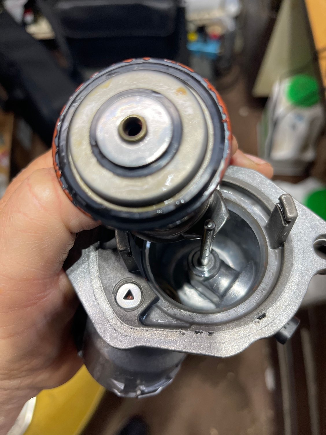

thermostat
Originally Posted by eric_in_sd
I bet it was the temperature sensor. The fact is you had temperature readings that did not match your probe. Keep the thermostat you pulled out as a spare.
It actually looks like someone ran a bead of rtv around this stat? Hopefully things will settle down and let me put some miles on it and quit spending $$ in parts !
Old Apr 28, 2024 | 09:06 AM
  #56
eric_in_sd's Avatar
Joined: Jun 2010
Posts: 2,762
Likes: 630
From: Emmett, ID, USA
2007 GL450
I think that is factory. The thermostat is sold integrated into the housing. Why, is a mystery. As you figured out, it can easily be slid off the heating element.
