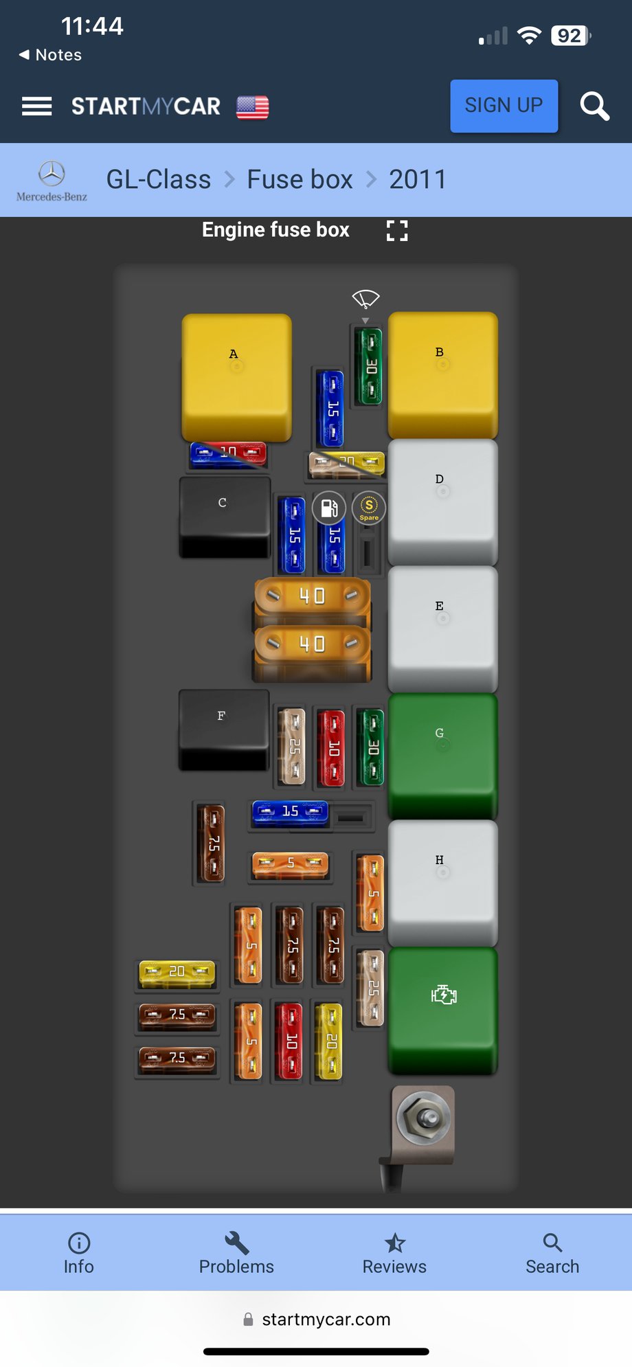

My starter solenoid was bad on 2007 gl. Corner green on fuse box near battery terminal under hood. Swapped with air compressor relay 3rd from left to test and it immediately started. Went ahead and bought a replacement. No issues yet

You can swap the suspension compressor relay with the starter relay. In the picture they are the two green relays. You should hear the starter relay click when you are turning the key.
Great site for fuse box intractive .. press the fuse or relay for info.
https://www.startmycar.com/us/mercedes-benz/gl-class/info/fusebox/2011
