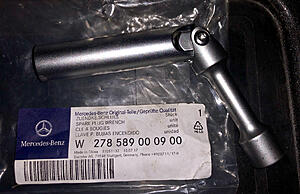

I started on my plugs today. Was able to finish the passenger bank in two hours. The last bolt closest to the passenger firewall is a *****. No combinations of wobble and socket will work so I had to go to Autozone and pick up a flexible extension which burned up time to do the driver side. Driver side will be a breeze with a lot more room.
The spark plug extension tool from Mercedes is worth the investment. I will be all in $160 for parts and tools with 3-4 hours of time.

Great job. Do you have a link for the Mercedes spark plug extension?
Old Sep 12, 2019 | 08:53 PM
chsu74's Avatar
Joined: Mar 2009
Posts: 401
Likes: 31
From: CT
GL 450, 993TT, Cayenne Diesel, 964C4
Spark Plug Wrench - Mercedes-Benz (278-589-00-09-00)
https://www.genuinemercedesparts.com...h-278589000900
