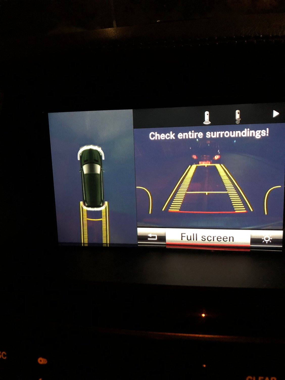

Hi All
The 360 camera in my 2013 GL63 AMG is so black at night its actually completely usesless, see attached picture outside my parents house so in a residential area lit by street lamps
I was parking in a supermarket yesterday and the white lines for the parking spaces around me werent even lined up, as if the cameras around the car are out of line.
I know theres an update for blackness of the cameras but despite agreeing that its very darl my dealer wont carry out the upgrade FOC, and wants around £120 GBP which Im resisting paying out of principal because they don’t actually know how much better it will be at night. Its clearly faulty or poor design so why should I pay.
Anyway will the software update make a clear difference?
Thanks
Carl

I can't tell of course if you have tried to adjust the brightness. My wife discovered this. Here is your photo below. I have circled the brightness control in the lower right corner. Rotate the knob over to this and press. A scale will appear on the right side of the screen. You can turn the knob to increase the brightness. Give it a try and let us know what happened.

Hi i did try the brightness, it helped during day time use but not much at site.
I will happily pay for the update if I was assured it will make a noticeable difference, the dealer wont comment so Im cautious thats all

I had the software update done on mine back in 2015 and it did make a fairly big difference. The rear view at night is now usable. Can't believe your dealer is wanting to charge you for an update that came out years ago back when the vehicle was under factory warranty and it should have been done by them back then.

Update works! Use the search bar as I did. Very helpful info on the subject here. The service advisor during the initial visit told me there was no fix. I used the info on this forum to prove him wrong. Gl

I showed the bulletin to my dealer here in the UK, they had to ask me what is was for so clearly didnt know of it and clearly cant even read either.
They quoted me £150 GBP with a caveat that they dont know if it works or not and I wont receive my money back if it doesn’t.
Not great service, again!!
Glad to know it works just wish this US bulletin was published here too.

I didn’t pay anything as my vehicle is still under warranty. It’s a known defect and they should not be charging you anything imo.

Mine has warranty, I was told the update wasnt covered, escalated to MB AMG who said the same.
Ive no problem paying to be honest just think its poor when they dont have any idea of the update, show no interest in trying to sort it for me and caveat the quote with a statement that Im still paying for it if they dont make it any better!!
