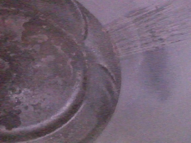

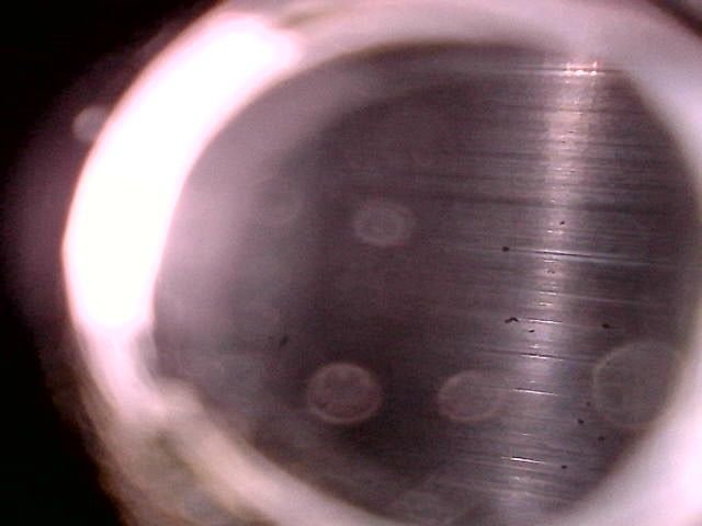

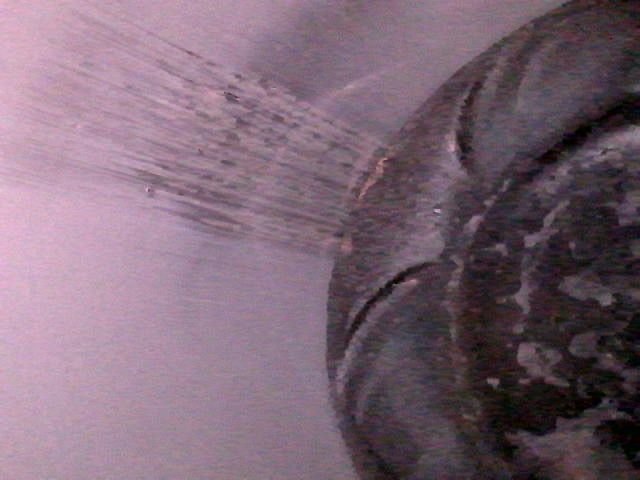

GL450 M278 bad cylinder
The M278’s are not aging well at all. I have maintained this vehicle to a tee. Mobil 0w-40 European oil every 7,500 since 54k. Talked with a MB corporate service tech and he agreed. Ditched it for a Toyota at 96k & hated to do it. My wife loved her 2014 GL450. Sorry if this is a repost, can’t remember which forum I posted it in earlier.

Did you hear evidence of scoring before you scoped it?
I did not. It would give a random cyl. #5 misfire plus it never seemed to run very smooth (we purchased it at ~56k). I cut the filter apart at the last oil change and it had a few flakes of aluminum in the pleats so I scoped it and saw the scoring in cyl. 5. I didn’t check any others.
