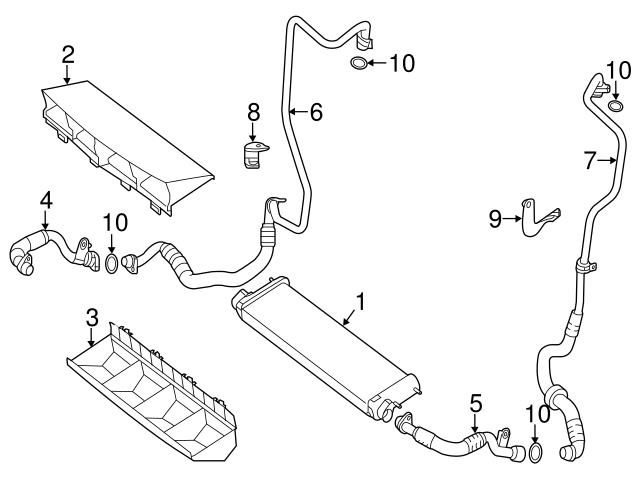

As a devout follower of Master Tasos channel, and as many of you already know, I am interested in adding an oil cooler to my M278 engine. I haven't inspected the cylinder walls to check for scoring, it may very well be too late but I figure late is better than never on doing something to upgrade this wonderfully awful design Benz made.
In Tasos' videos he mentions locations for the oil cooler to either be upfront by the bumper (which I believe requires swapping the bumper from an ML or GLE, that is compatible and has enough space) - or moving the reservoir for the windshield wiper fluid in the back (or getting a different one, forget which models) and putting the oil cooler in its place.
I did a search on this subforum, but maybe someone can point to my lack of broader search skills because there has to be a thread on here about people who have done the procedure but I can't find it yet. Any opinions or resources would be welcome. Thanks!
To clarify, I'm not referring to 2781880201 - he calls the "Engine oil heat exchanger" - but most parts catalogs call the oil cooler. I'm talking about something along the lines of this https://www.pelicanparts.com/More_In...c&SVSVSI=12326

Does he say that adding an oil cooler will somehow help the scoring issue?

I'm guessing that as oil temperature increases, the viscosity decreases and the oil cooler helps prevent that and hence prevents the scoring issue on the aluminum block. I'm also guessing the m157 don't have the same issue (or as bad) due to the presence of the cooler. Ultrakla$$ic made a thread in the w221 forum in June, that I found after posting this asking the same question but there were also not a lot of answers there.

No, the M157's do suffer from the same scoring issue.

Would you say that the presence of the oil cooler on the M157s helps and the scoring issue happens at later mileage?
Would changing the sleeves to steel be the primary solution here?

No, they are unrelated. The issue is the crappy coating they used on the cylinder walls along with forced induction. If you really want to fix the engine, have it sleeved since nothing you can do will prevent it unless you drive like a granny and never dip into the forced induction.
