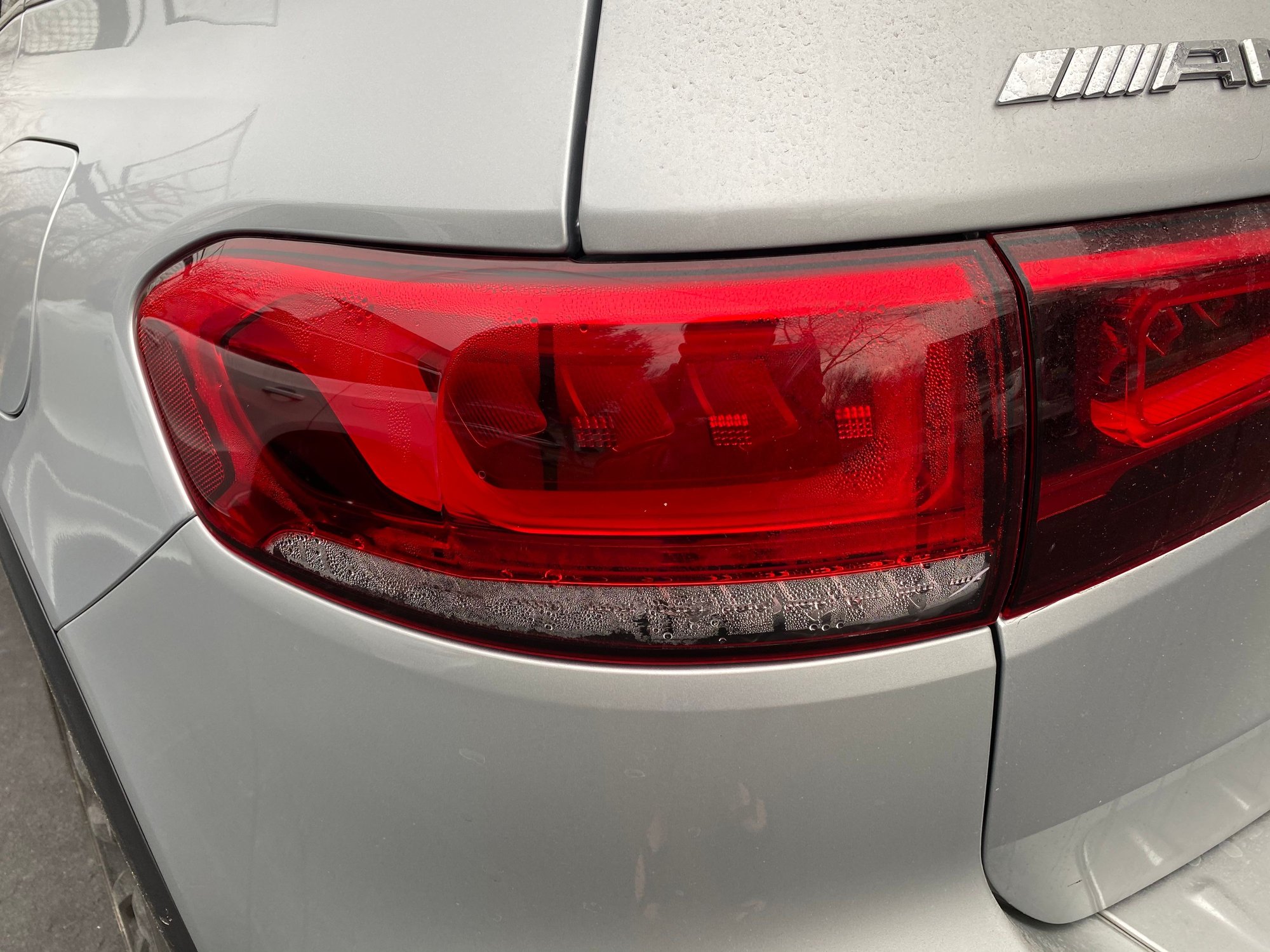

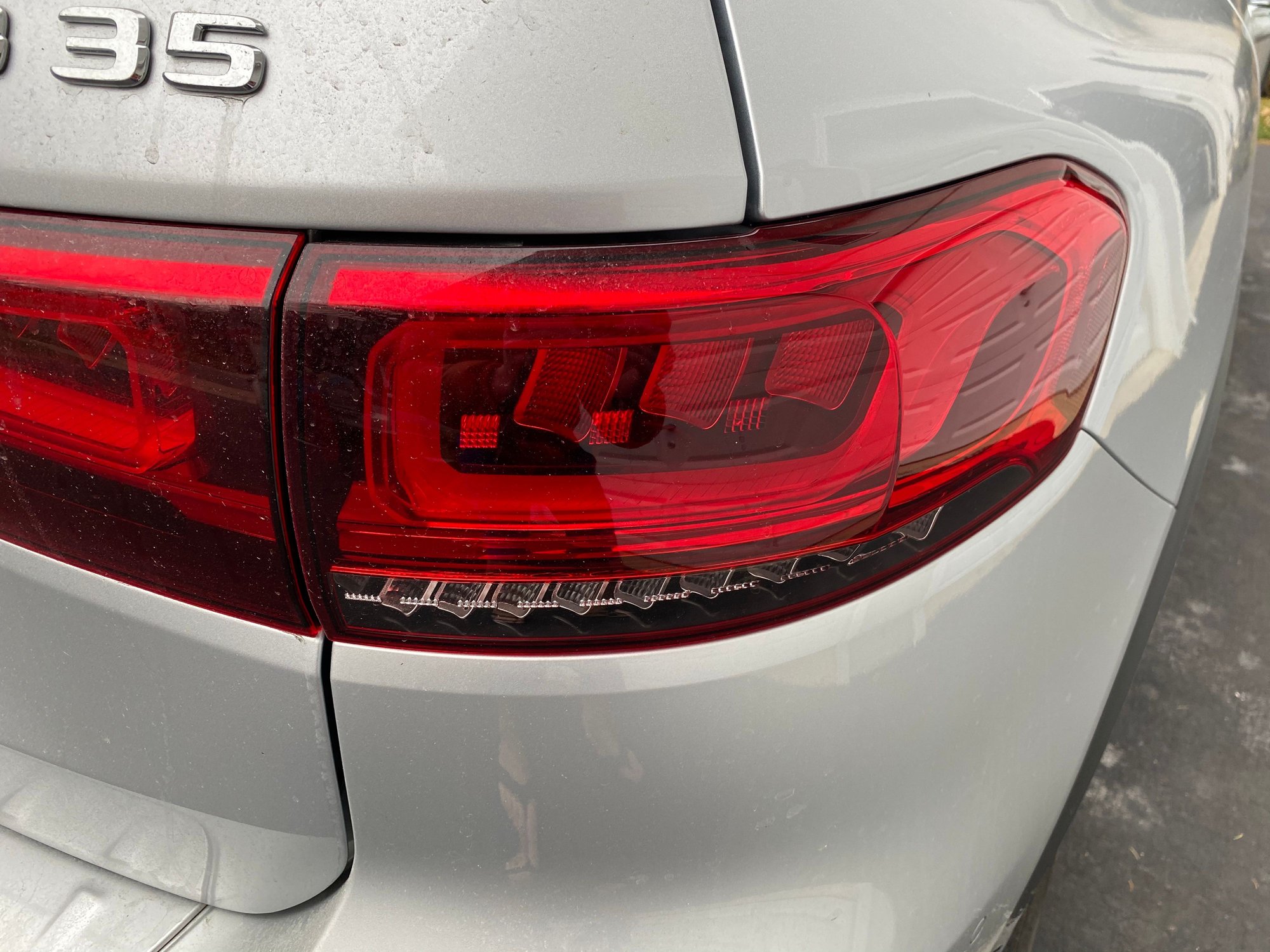

Not sure about the head lamp but some do have ventilation so fogging is normal. However, I have water inside left tail lamp already. Pretty sure it’s leaking. I’m going to the dealer next week.
Got to love the Mexican built quality 😒

Condensation in LED headlights is normal, the vents the allow the moisture in are necessary. As for the taillights, there should be no moisture in the housing. They may be LED but nowhere near the power output of the headlights. Get the dealer to check it out and even if he finds nothing wrong get him to note it on the work order just in case something shows up in the future.
