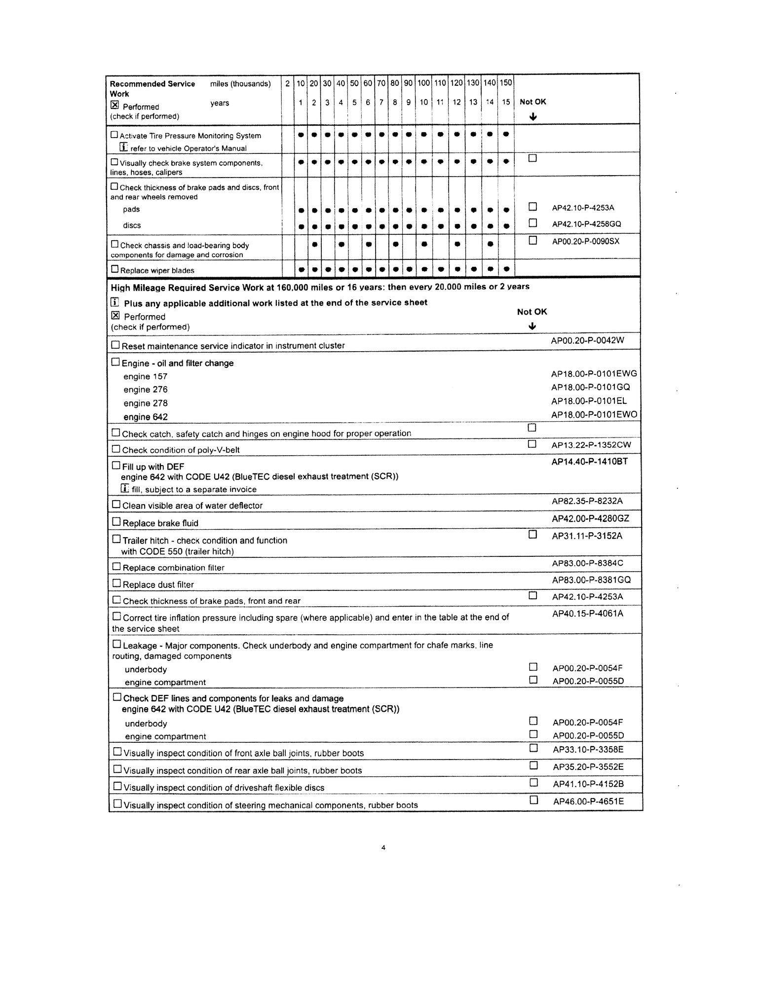

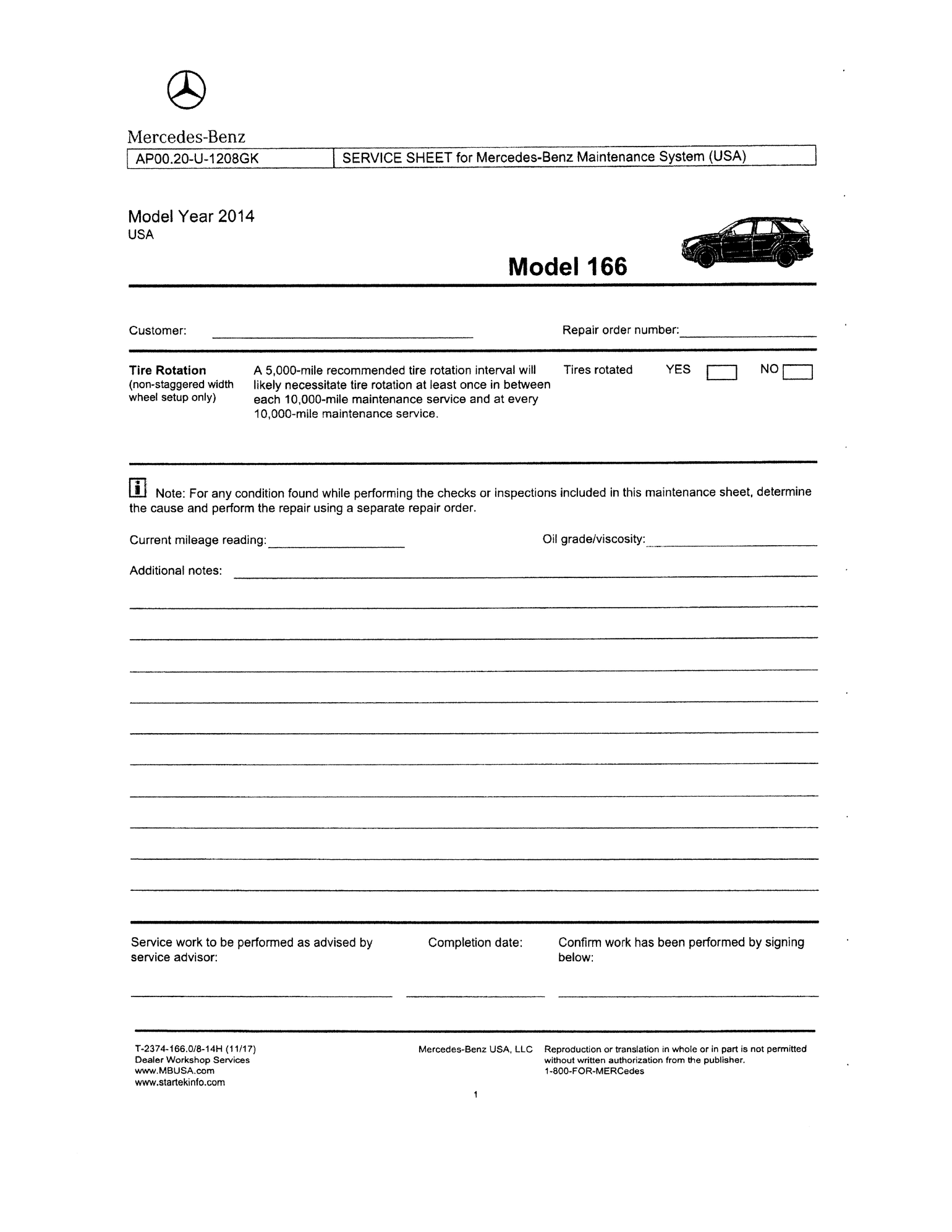

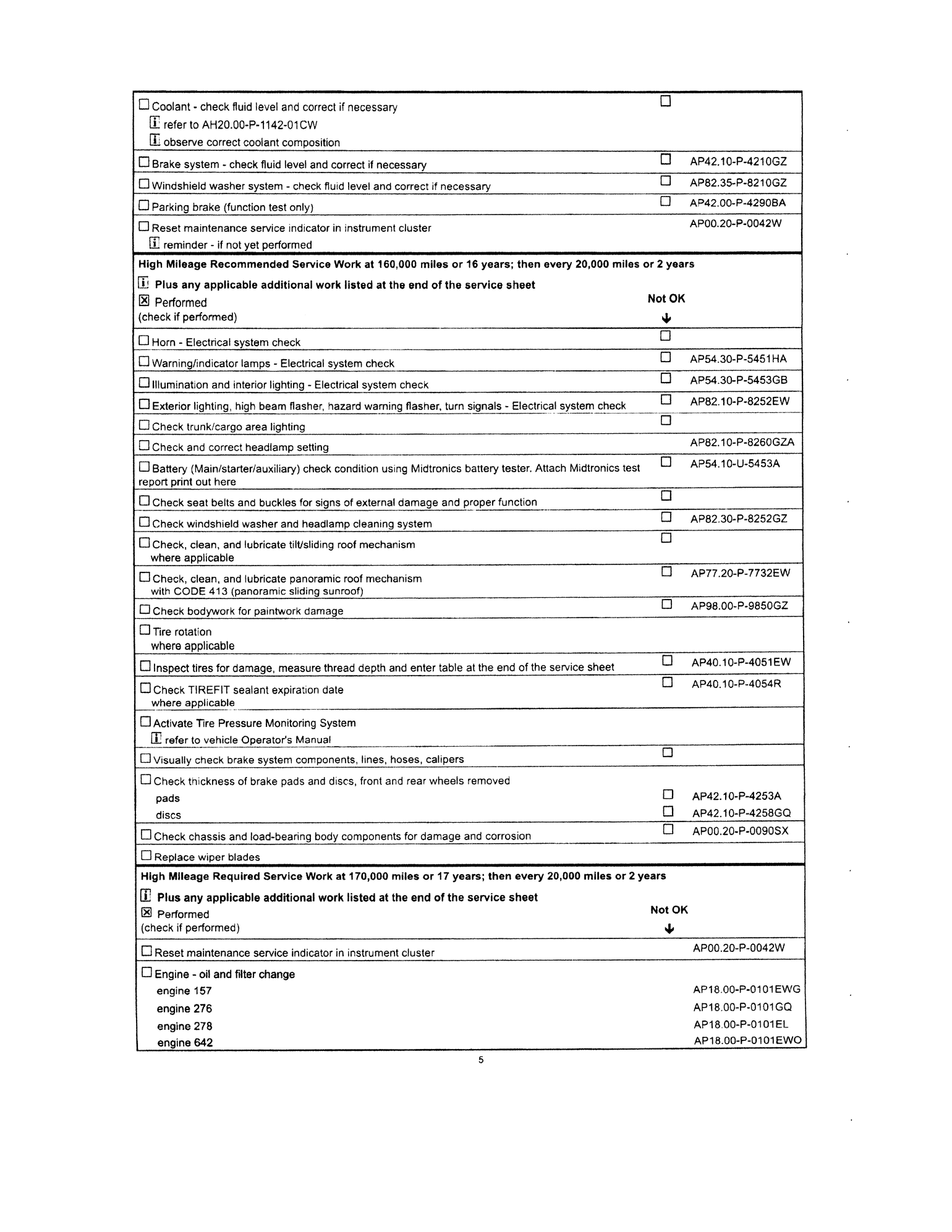

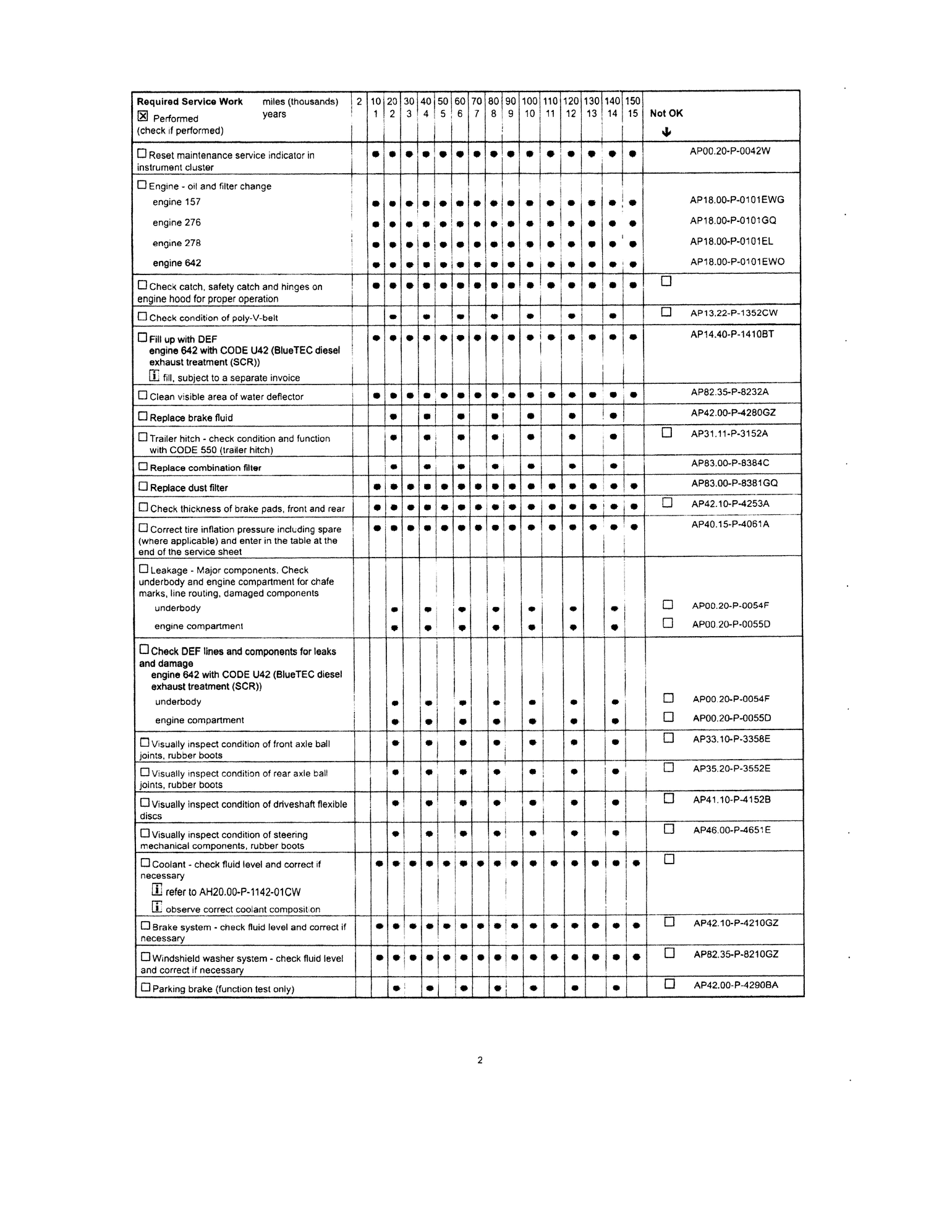

ATTACHED EXAMPLE DEALER SERVICE SHEET
Originally Posted by Vladimir Livson
I got email notification from MBWorld but no attachment was included with the message.
Finally, the upload of the example ML350, had to change it to a PNG File. again, this is what I'm looking for with the GLB............
