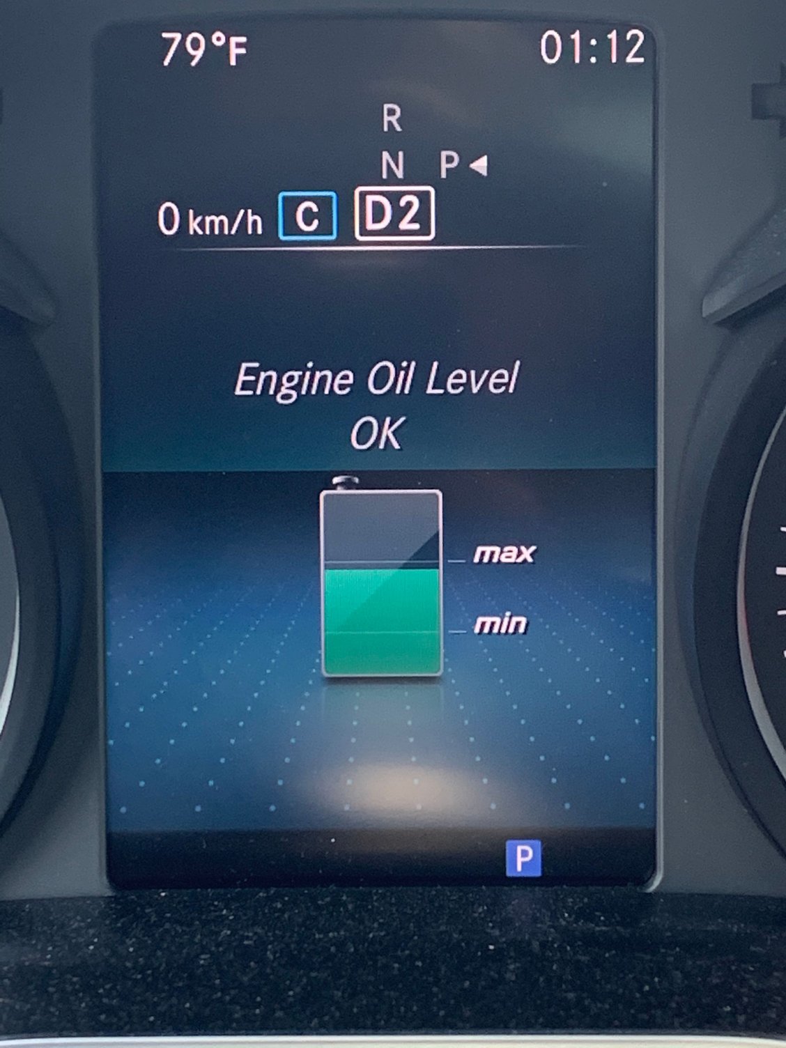

Here is my oil level In my 2020 GLC at 4451 miles. Slightly down from the max level where it started brand new. I sure hope this isn’t a design defect in these new M264 engines.
