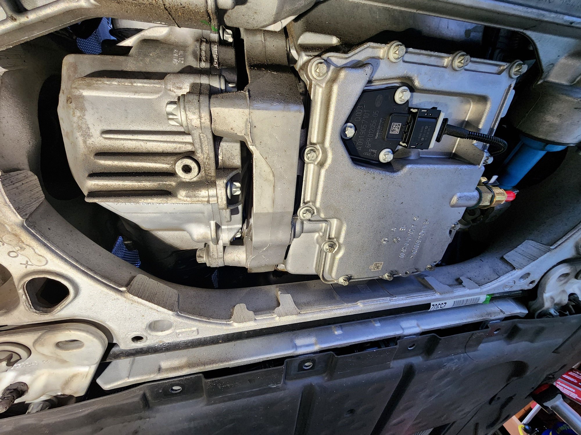

With my 2017 glc300 4 magic.
I saw the side fill plug, but theres no space to turn the bolt out.
I opened top plastic cover, but i was not sure if I can pour oil thru the top hole.

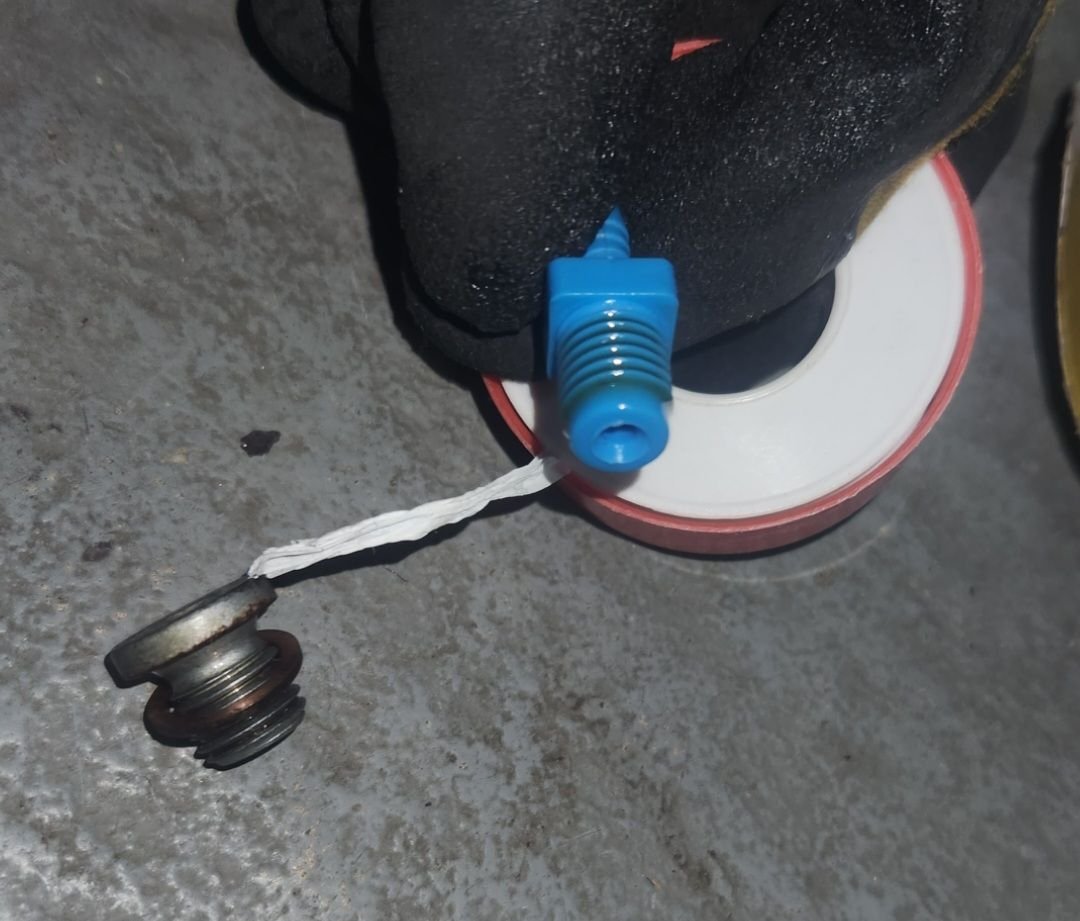

I decided to pump new oil thru the bottom drain.
I measured drained amount, 500ml.
I pumped 550ml and then quickly replaced the drain bolt with the injection blue plastic plug. Spilled some, so 530ml filled.

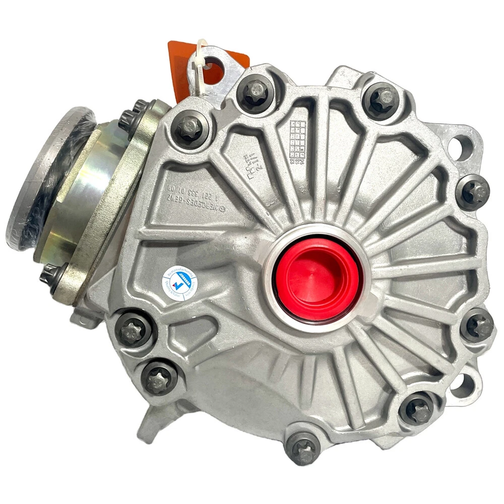

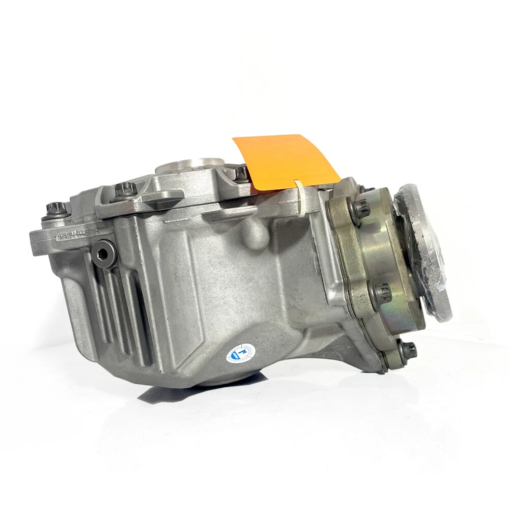

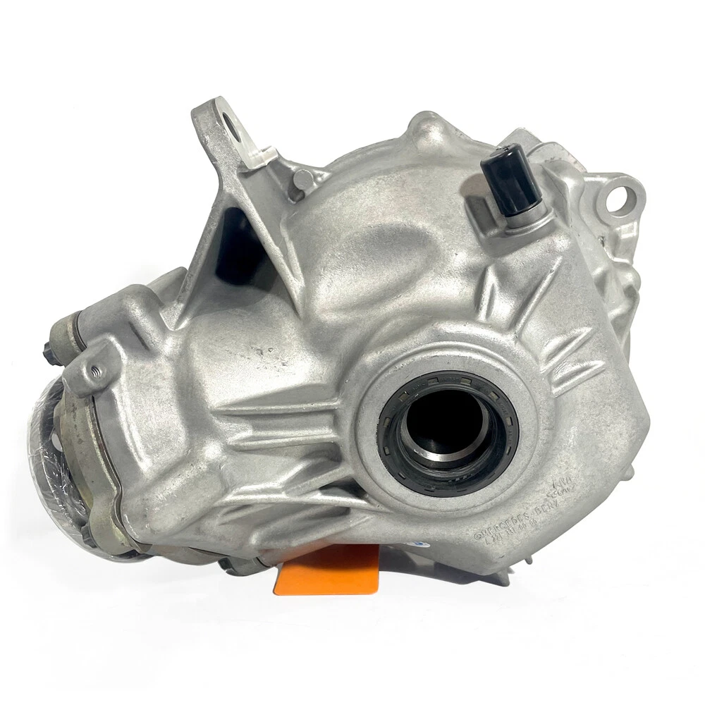

Strange thread. OP asks about the fill location for a 2021 and responses are for earlier model years with different front axle, and recommending oils.
It seems like the 2021 GLC300 front axle is a fill-from-the-axle hole device, like other MB models. I think W204 or W205 was this way.
If there is no fill plug, the precedent MB procedure is to remove the axle shaft and fill to overflowing. An alternate approach is to fill from the drain plug:
The unit below shows a drain plug and no fill plug.
Picture 2 of 6
Picture 3 of 6
Picture 5 of 6
Picture 5 of 6
