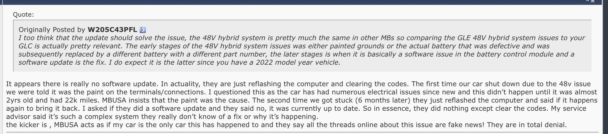

Just a quick update from me. I had my 2021 GLS 580 in service back in August 2021 for the 48v battery error message issue. My engine never shut down but my AC stopped working. The dealer completed a software update only, no battery replacement and so far over a year later there has been no reoccurrence of the error messages or any other issues. Since the software download, I’ve kept the ECO start/stop turned off religiously. Not sure if that was a contributing factor to the issue….just playing a hunch.

Do you know if it really was a software update? According to some posters the “update” is just clearing codes and resetting everything and crossing fingers that it doesn’t come back. Below was from May 2022.

I wonder if the GLC poster, who I quoted, already had the latest controller software since he had a 2022 MY. Anyone know when they updated that software?
