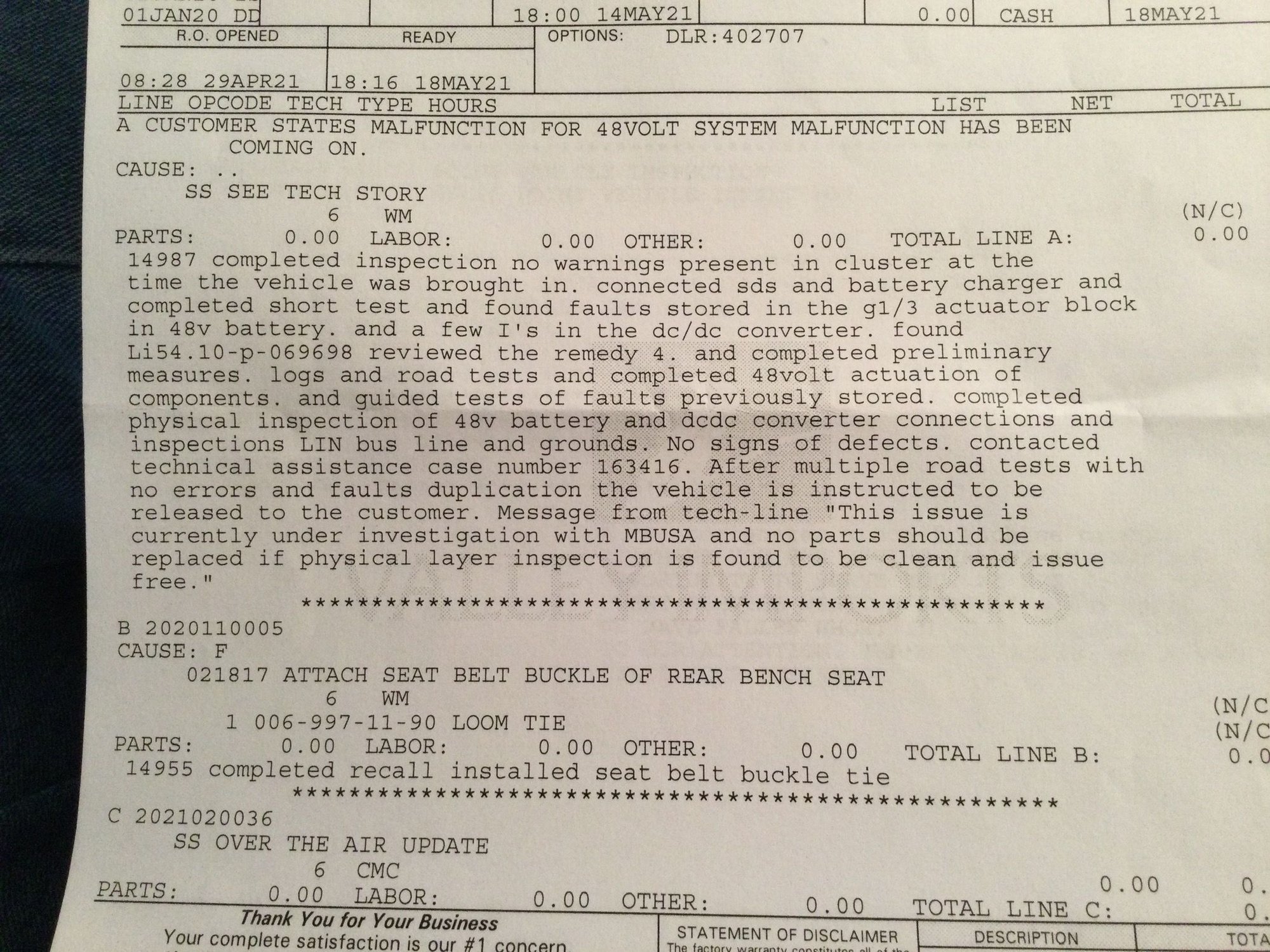

I would welcome comments from forum members on the dealer service notes I included above in post #140. When the problem occurred while we were driving the vehicle, the dash displayed a message that the 48 volt system had failed, but it looks like they could not detect any problems with it once it was towed to the shop, and could not replicate the problem. The GLE continues to operate normally since we drove it home earlier this week.

Maybe now that the battery has failed and you had to have it towed, the dealer must know there was a starting problem. They don’t need to duplicate it.
I would ask them to replace the battery under warranty to the NEW part number battery and not accept the answer that they couldn’t find anything wrong. It had to be towed because it wouldn’t start.
