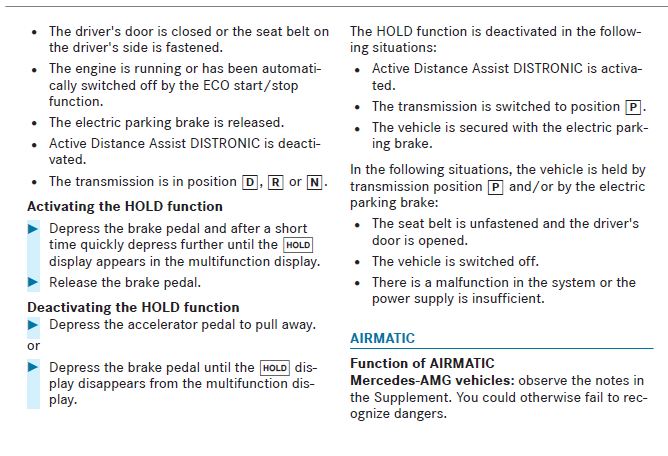

The HOLD function is manually engaged by you. The steps are explained in the owner's manual. Stop doing them and it won't activate. Essentially the HOLD function activates if you stab the brake harder after you've already come to a stop.

Yes, pushing the brake pedal harder after you already braked.
Which is absurd.

Maybe yours needs to be calibrated, but it simply doesn't engage by just braking normally, even hard braking. I drive an AMG and brake hard often. In fact when I first got my car I wanted to use it and I couldn't reliably get it to engage until I learned the right motion. It literally takes a bit of a jab and you have to be at a full stop for a second or so. However, even if it engages inadvertently, which does happen to me sometimes now that it has become muscle memory, what exactly is the issue? It releases automatically the moment you step on the throttle, or you can jab the brake pedal again to manually release it.
