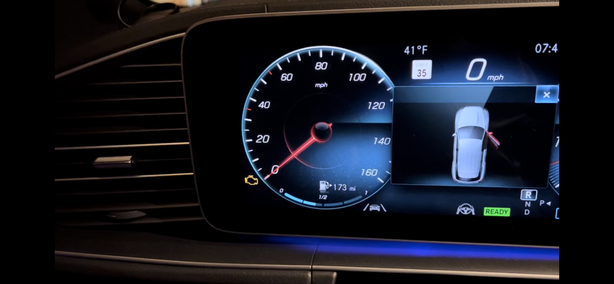

I found MB’s V8 problem.
I’d like to first start by saying I love this car. There are a few minor things I wished I could change like standard wireless CarPlay or maybe a little better up front compartment space but over all this is a great, roomy, powerful car……….but……….
This morning backing into the garage at 9292.3 miles I started feeling a vibration and looked down and the check engine light was flashing. It took me a minute to realize what was going on and I grabbed my phone to document it but it stopped and the light went off. I guess it lasted about 15-20 seconds. Oh well, here’s to hopefully it never happening again.
I wonder if this is why MB might be cutting back on some of their V8s.

Well I was going through my phone pictures today, cleaning up my phone, and getting some for Christmas when I found a 3 second video I didn’t know I had. It catches the last flash of the CEL before it resets. I just took a screen shot of the video with the light on. Now I have proof for the dealership.

Uh oh! This is the second time it’s happened.
While driving home tonight on the interstate my wife and I both commented that the car was shaking. I get home and back into the garage again and I have another CEL. I’ll be stopping by the dealership tomorrow. It might be bad………..
